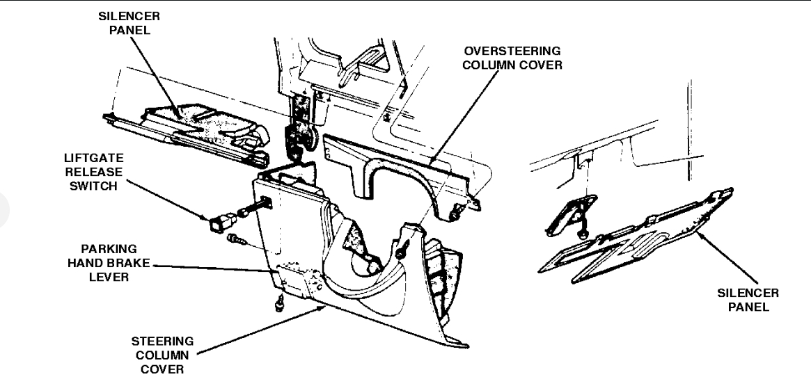

How to remove the dash on this particular vehicle to access the heater core?
175,000 MILES • 2.5L • 4 CYL • 2WD • AUTOMATIC
LARRY B.
How to remove the dash on this particular vehicle to access the heater core ?
Oct 4, 2022 at 4:40 AM
  • 110,244 POSTS

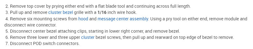

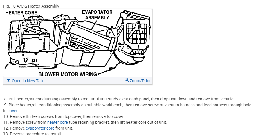

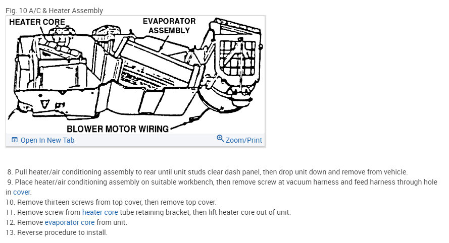

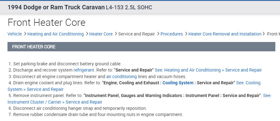

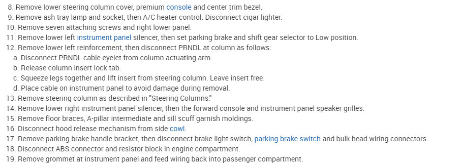

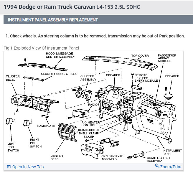

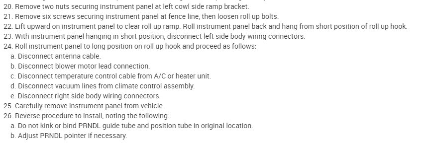

This isn't a horrible job, but it will take a bit of time. If you look below, I started with the directions for the removal and replacement of the instrument panel. After that are the directions for replacing the heater core.
Please keep in mind, the A/C system will require evacuation prior to the work.
