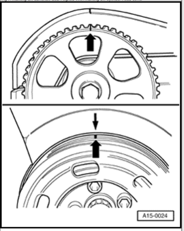

Replace head gasket
18,000 MILES • 1.6L • 4 CYL • FWD • MANUAL
DEVANP
Not 100% sure of where the timing should be when reinstalling the head. I am getting mixed advice.
Some ppl say all pistols must be level...Some ppl say 1&4 must be up(TDC).
PLEASE help. I know where the timing marks are. Is there a guide that anyone knows off.
Or how should I do it.....

Can you post the cars VIN or engine size and engine code so i can find the correct info for you.
Jan 30, 2016 at 6:14 AM
DEVANP
Hi the polo is a petrol 1.6 BAH 8v
Jan 31, 2016 at 4:07 PM
  • 55,694 POSTS
Hello, sorry for the slow response, the #1 piston must be at tdc,, here is the diagram needed.
Let me know how it goes
