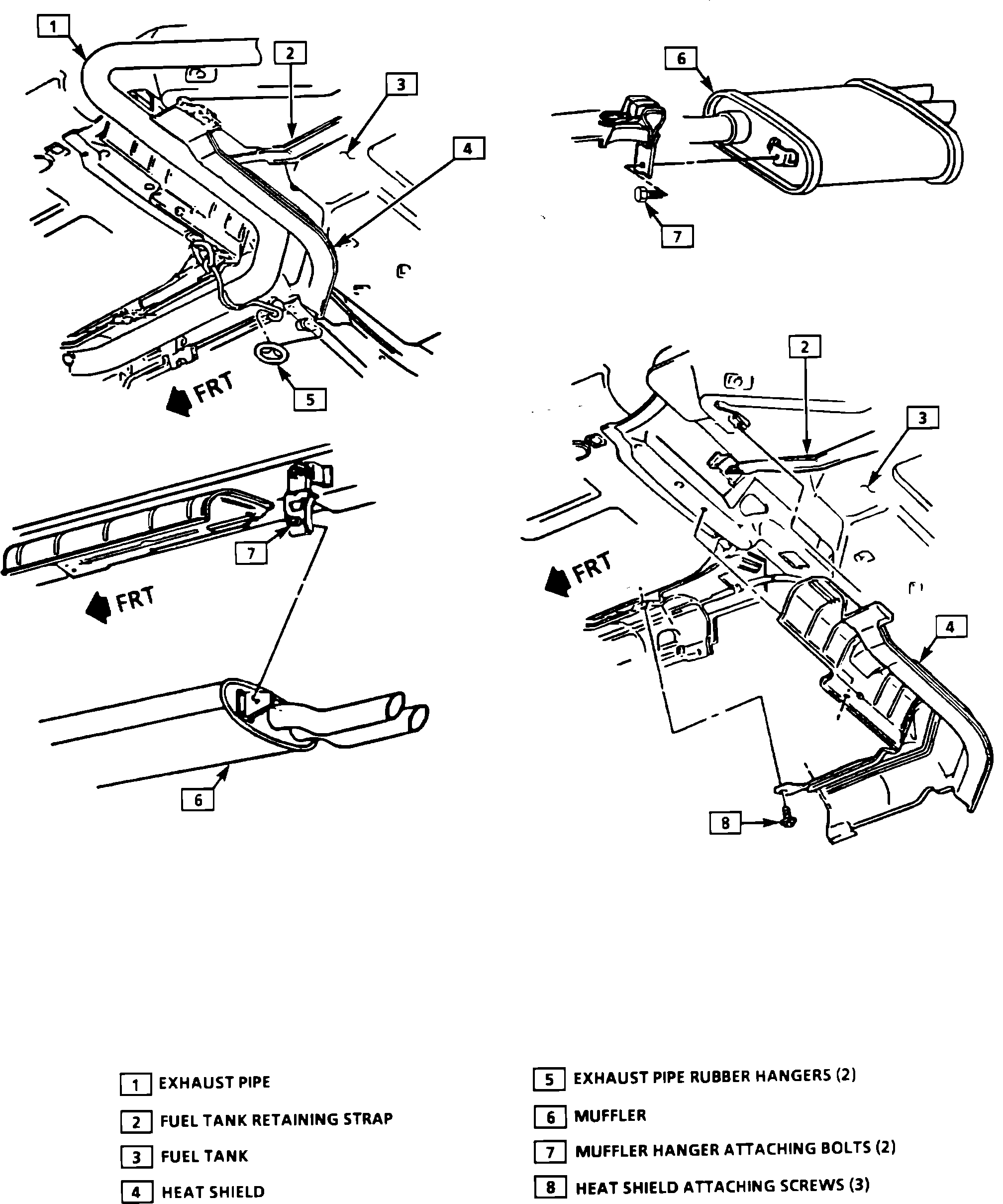

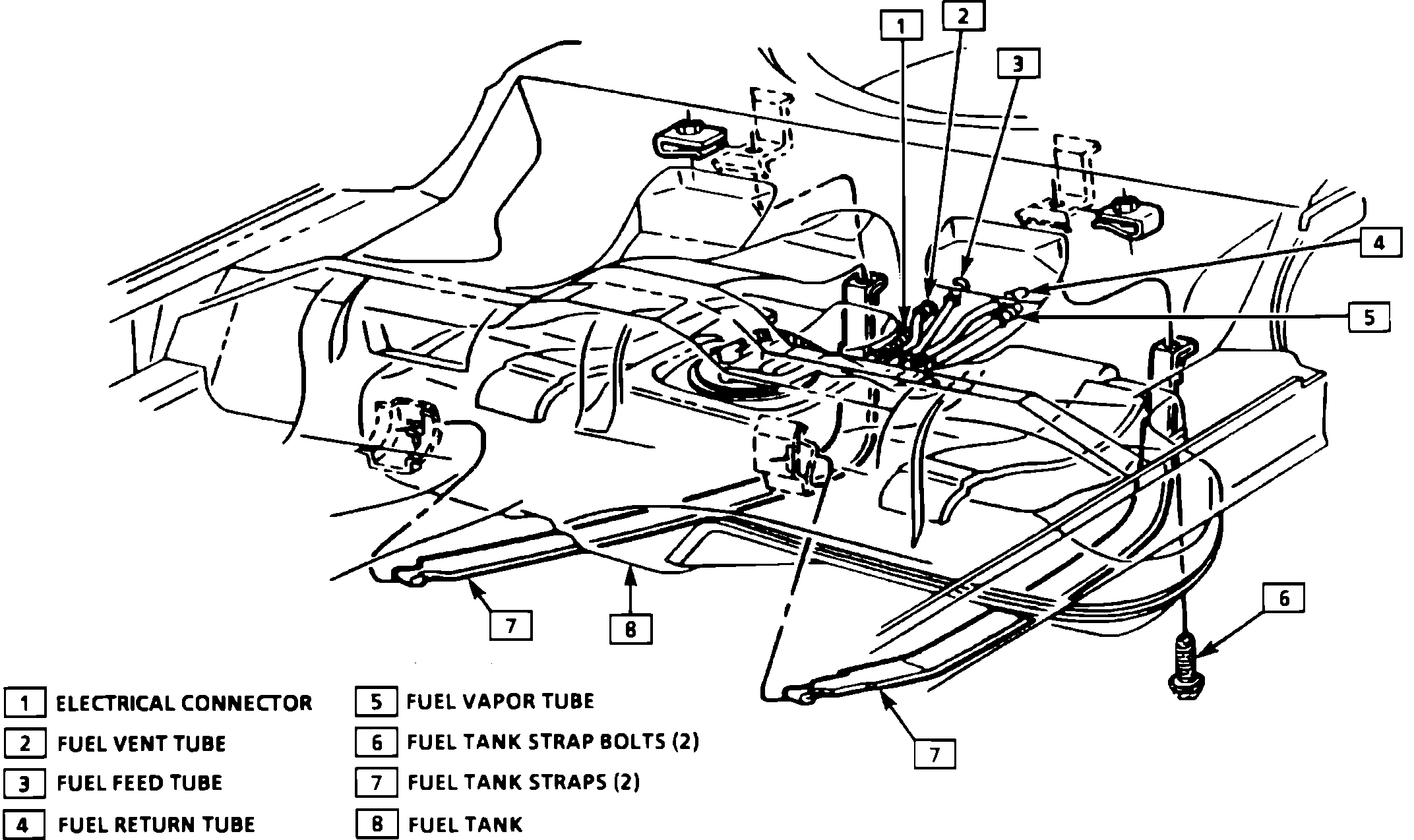

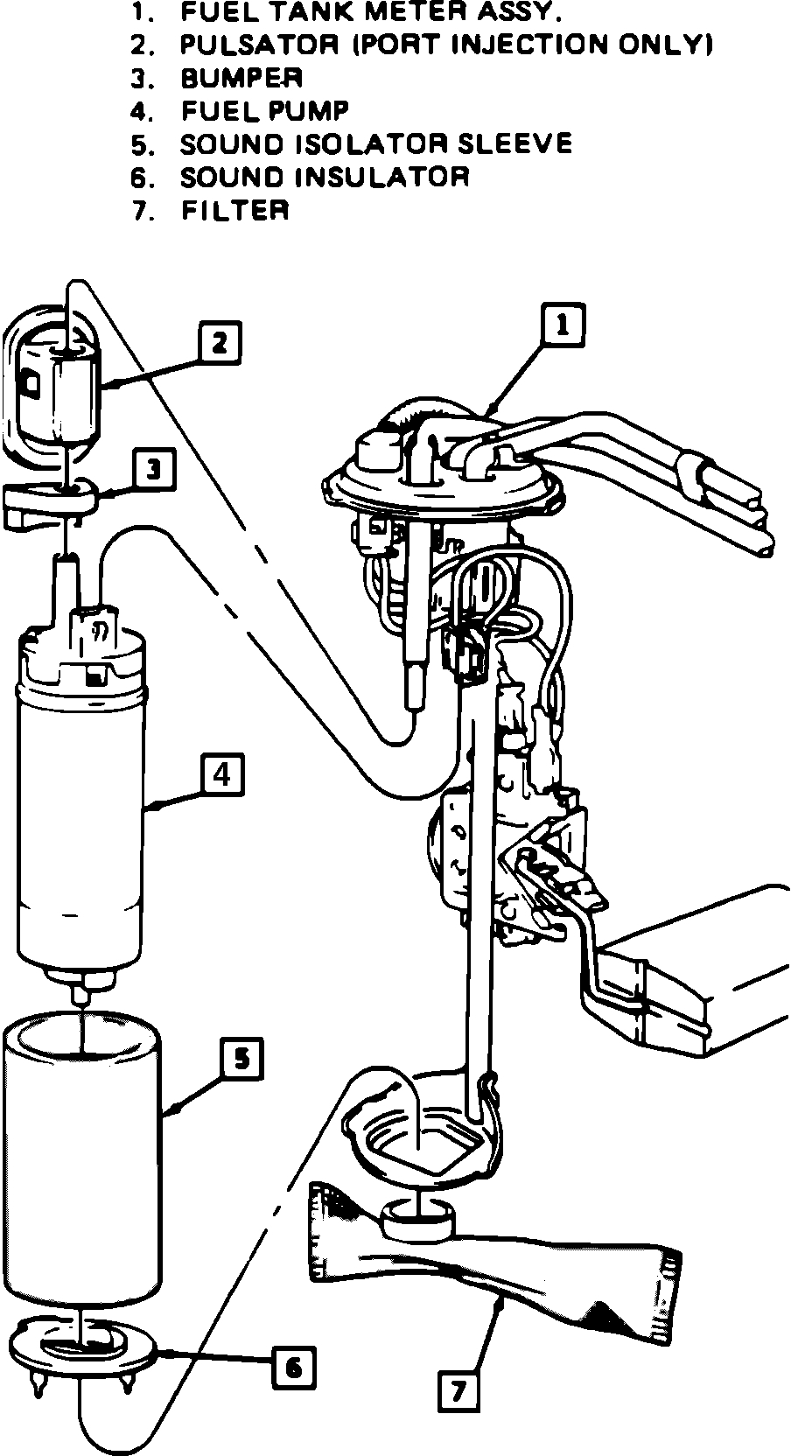

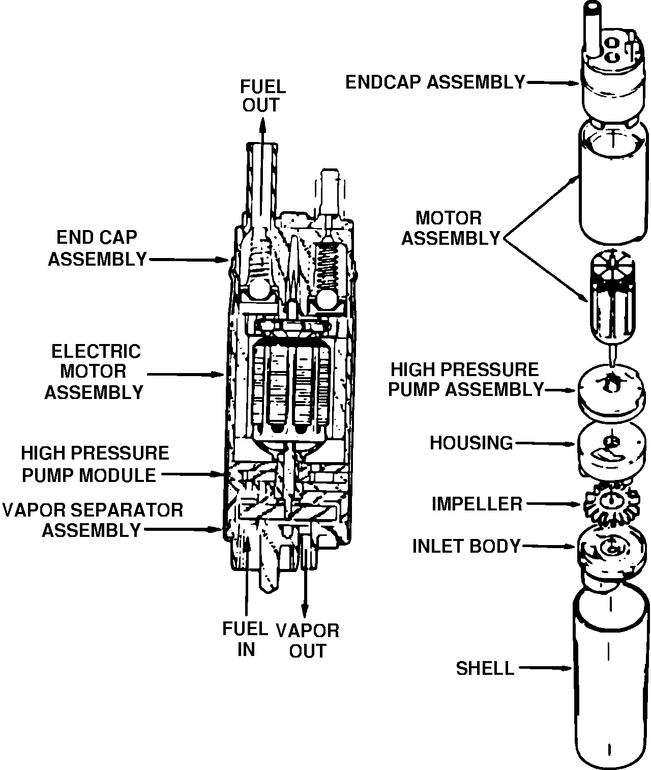

Here are the directions specific to your vehicle for pump replacement. The attached pics correlate with the directions. Note, the fuel tank will need removed. I attached those directions second.
__________________
1992 Buick Regal V6-191 3.1L
Fuel Pump Replacement
Fuel Pump/Fuel Gauge Sending Unit (typical)
Pic 1
Roller Vane Fuel Pump - Exploded View
Pic 2
NOTE: DO NOT handle the fuel sender by the fuel tubes. Due to the length of the tubes, the amount of leverage generated by handling the tubes could damage the solder joints.

1. Support pump with one hand and grasp strainer with other hand. Rotate strainer in one direction and pull off of pump. Discard strainer after inspection.
2. Fuel pump electrical connector.
3. Place fuel sender assembly upside down on bench. Pull fuel pump downward to remove from mounting bracket, then tilt pump outward and remove from fuel pulse dampener.
NOTE: DO NOT run fuel pump unless submerged in fuel.
4. Inspect fuel pump strainer. If strainer is contaminated, the fuel tank should be cleaned. Fuel pump inlet for dirt and debris. If found, fuel pump should be replaced.
ASSEMBLE:
1. Rubber bumper and rubber insulator on fuel pump.
2. Position fuel sender assembly upside down. Install fuel pump between fuel pulse dampener and mounting bracket.
3. Fuel pump electrical connector.
IMPORTANT: Always install a new pump strainer when installing fuel pump.
4. Position new pump strainer on fuel pump and push on outer edge of ferrule until fully seated.

Here are the directions for tank removal.
FUEL TANK ASSEMBLY
Exhaust/Heat Shield Removal
pic 3
Fuel Tank Replacement
pic 4
WARNING: To help avoid personal injury when a vehicle is on a hoist, provide additional support for the vehicle on the opposite end from which components are being removed. This will reduce the possibility of the vehicle falling off the hoist.
Tools required: J 37088-A tool set, fuel line quick-connect fittings.

3. Raise the vehicle on a hoist.
4. Remove the fuel filler hose from tank.
5. Grasp the fuel sender feed tube and in-line fuel filter quick-connect fitting. Twist the quick-connect fitting 1/4 turn in each direction to loosen any dirt within the quick-connect fitting. Repeat for other fitting.
6. Blow the dirt from the quick-connect fittings with compressed air.
7. Disconnect the quick-connect fittings:
- Squeeze the plastic tabs of the male end connector and pull the connection apart. Repeat for other fitting.
8. Disconnect vapor hose from connection (at front of tank).
9. Remove rubber exhaust pipe hangers to allow exhaust system to drop slightly.
10. Remove exhaust pipe heat shield bolts and heat shield.
11. With aid of an assistant, support tank, and remove front fuel tank strap attaching bolts and 2 retaining fuel tank straps.
CAUTION: DO NOT bend the fuel tank retaining straps, as this may damage the straps.
12. Lower tank enough to disconnect fuel sender electrical connector and remove the retaining clips.
13. Remove vapor hose from fuel sender assembly.
14. Remove Vapor hose from vapor pipe (at rear of fuel tank).
15. Remove fuel tank from vehicle.
NOTE: If it is necessary to remove rust or burrs from the fuel level meter tubes: use emery cloth in a radial motion with the tube end to prevent damage to the O-ring surface.
- Using a clean shop towel, wipe off the male tube ends.
- Inspect all tube ends for dirt and burrs. Clean or replace components/assemblies as required.
- Inspect fuel line O-rings for cuts, nicks, swelling or distortion. Replace if necessary.
