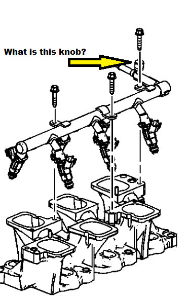

I am trying to replace fuel injector number one. Everything I have read here says to relieve fuel pressure first. But nothing says how! I have looked elsewhere and other places either did not mention it at all or did not mention how either. So, how do you relieve fuel pressure?
There is a knob on the backside on top of a metal tube. What is that and what does it do? Does it relieve fuel pressure? Does it cut on and off fuel to injectors? I do not think so, because I have turned it all the way on and off and it does not seem to change anything that I can tell. But I do need to know if it needs to be close or opened (whether it does anything or not)?
My other problem is (which is far greater), I replaced the fuel injector number one and put it all back together. When putting the fuel rail back in, I made sure they all lined up, but when I tried to push down, one side or the other would put up and get unaligned. So, I lined the all up and tightened the bolts down and they seem to go down into the intake, but I worried if they were seated or not.

Very easy for one injector o-ring to be out of position or roll over and leak and dump a lot of gas fast. Normally you apply a thin coat of oil onto the o-rings to get them to slide in easier. From your description I think you either rolled an o-ring or sheared some of it off.
Relieving pressure is easy. One method, Pull the fuel pump relay, start the engine and it will run out of pressure and stall. Another is to install a pressure test gauge and use its bleed line to drain the pressure.
The "knob" is the cap for the pressure test port. Under it is a valve like a tire valve. It is the place you would screw on the pressure test gauge.

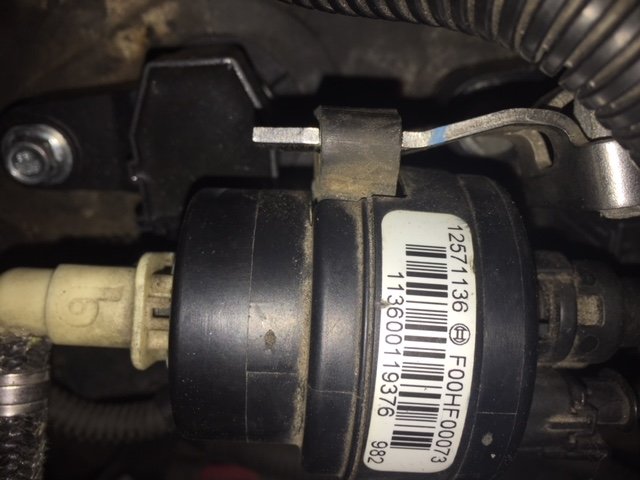

I have a Chevrolet mechanic friend of a friend who has a scanner and can look at it the middle of next week. Until I thought I would continue to see what I could do on my own. I am think about changing the "vapor canister purge valve/solenoid". Every time I get under the hood to do any of this stuff, I think that thing looks wobbly and just I do not know. Every time I look at it, I think that thing needs to be replaced. So I looked it up this morning and it's a "vapor canister purge valve/solenoid". Say that three times fast! But I have read that it can cause rough idle and check engine lights. It is not expensive, $50.00.

It can but unless it is actually causing an issue I would not replace it. These days I get more bad "new" parts than ever before. Nothing like putting on a new part and having it be worse than the old one you took off.
