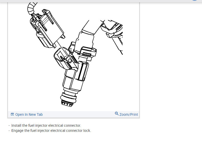

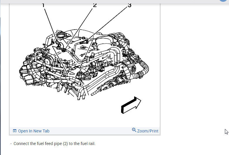

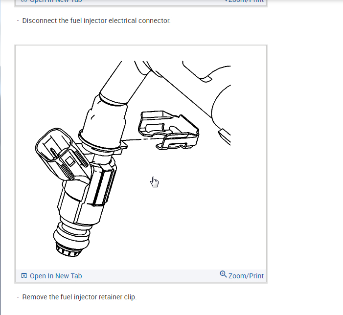

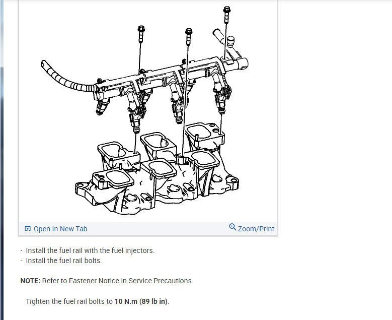

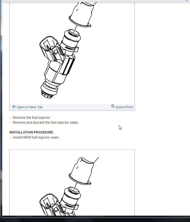

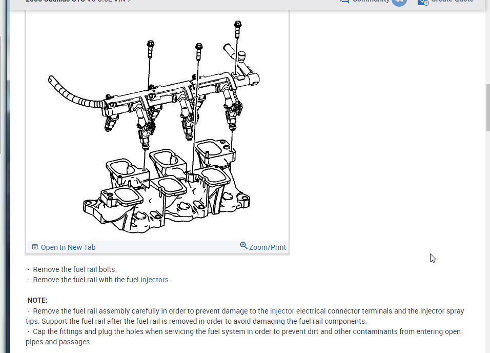

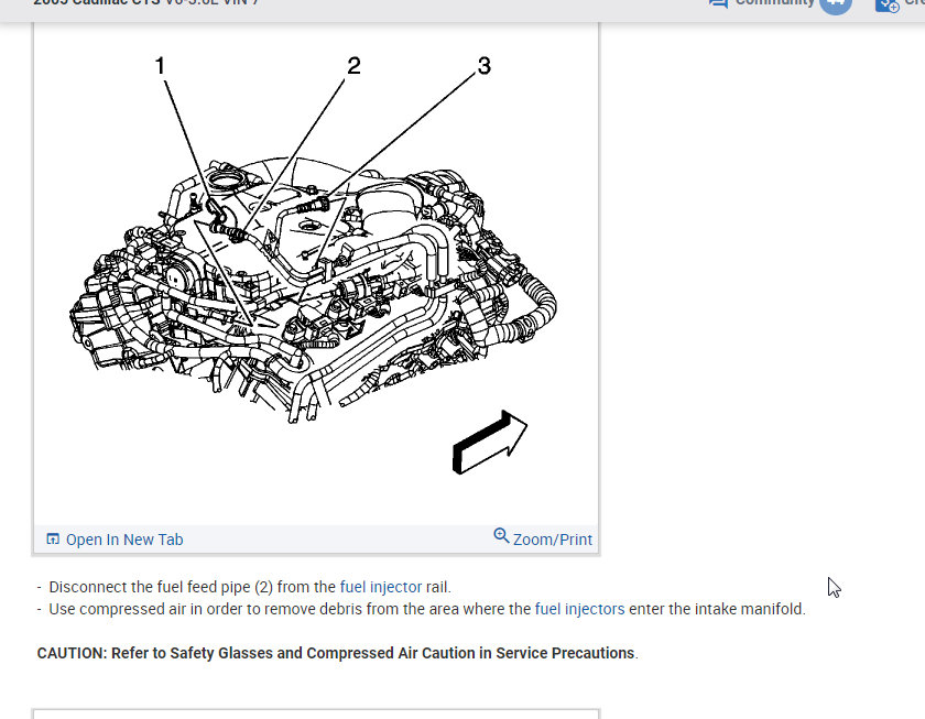

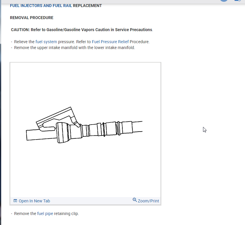

Misfire on number 1 cylinder. I need to change the injectors.
Dec 21, 2015 at 5:27 PM

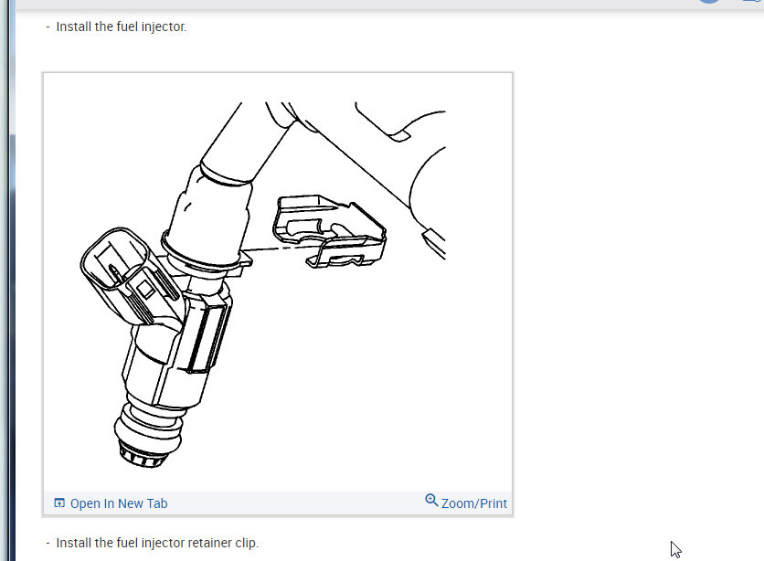

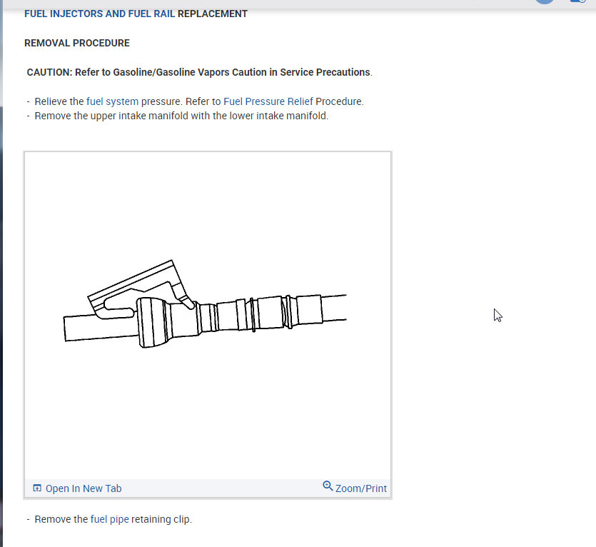

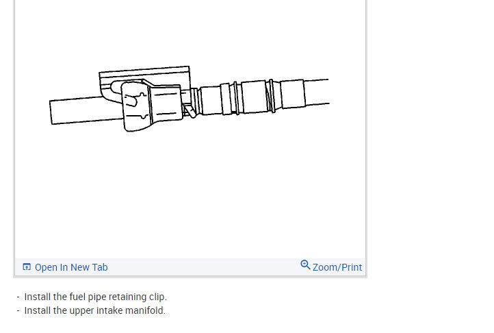

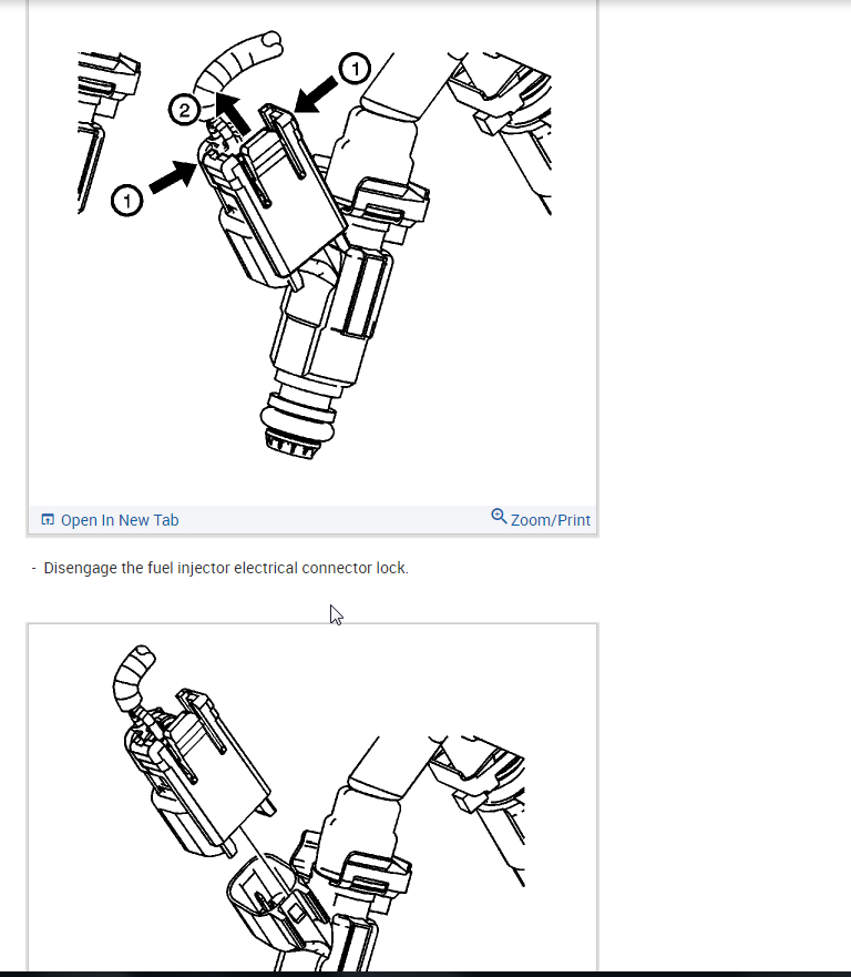

If you have a misfire on one cylinder, I would swap the injector to another cylinder first just to make sure it is the injector. The misfire should move to the cylinder with that injector.
I attached the process for replacing the injectors. Let us know what questions you have.
Here is also a guide that will help:
