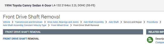

The right side drive axle goes through the motor mount and has a bearing that is kept inside the mount by a bolt. With the bolt removed and the wheel hub removed and everything out of the way, it seems the bearing is stuck. I've rented a side hammer but there is no good place to attach it. So I'm rapping the ale with a chain, bolts through the chain and attached to the puller that came with the hammer. I don't know what else to do. Got any ideas?

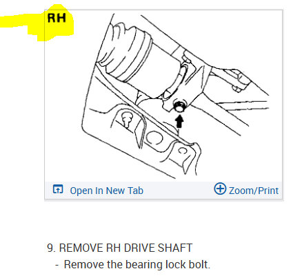

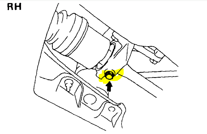

Hi:

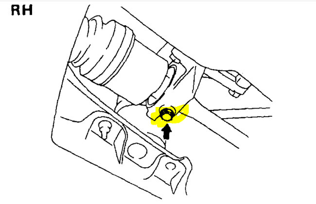

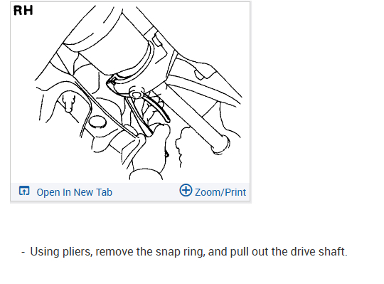

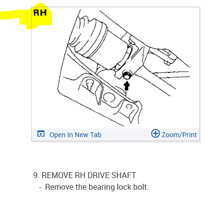

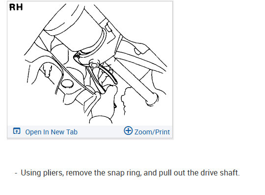

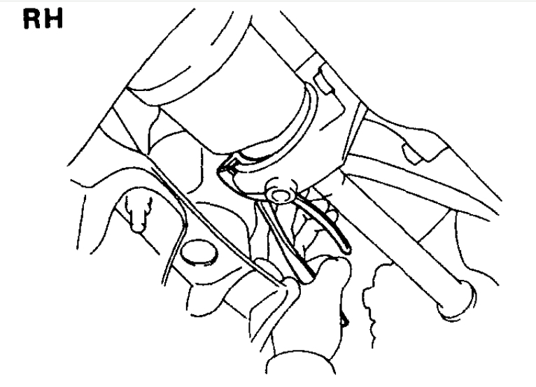

There are two things that need to be removed for the bearing to come off. There is a retaining bolt and a snap ring. Have you removed both?
I attached the only two pics I could find. Let me know if this helps. Also, you will pry the axle from the transmission once the bearing is removed.

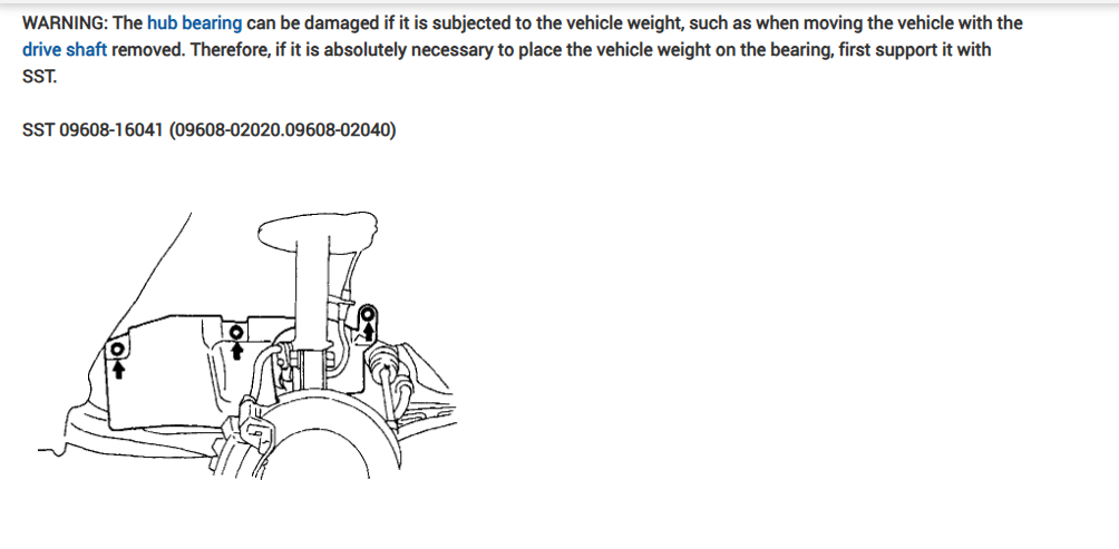

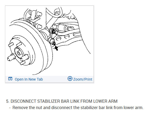

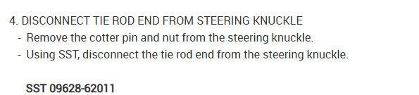

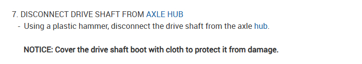

  • 110,248 POSTS
Hi:
I went through the manual again, and there isn't anything related to the engine mount.

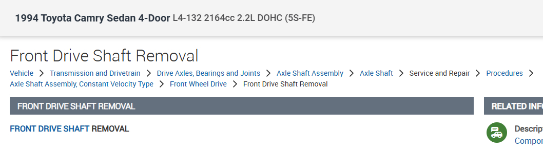

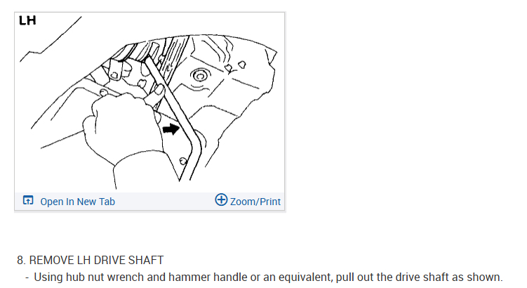

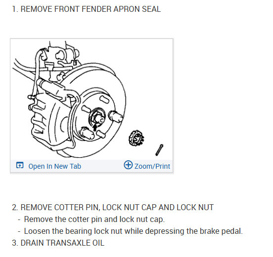

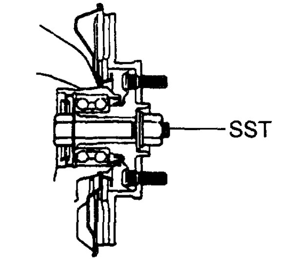

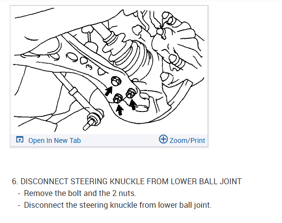

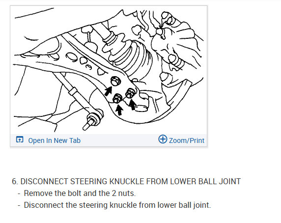

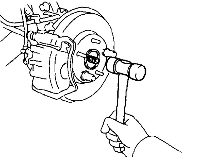

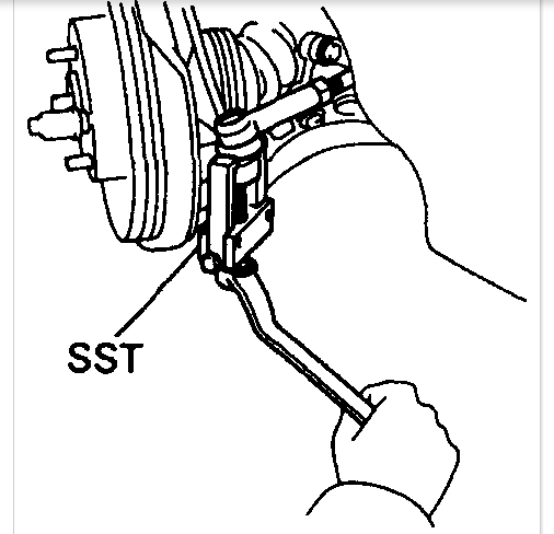

If you look below, I have attached all directions and pics for the removal of the front axles. Note that the directions start with the left side, but you will need to do the same thing on the right. The only difference is the bearing (last two pics). That unbolts, and there should be a snap ring holding it in place.
See pics below
Aug 11, 2026 at 7:46 PM
  • 110,248 POSTS
Sorry, I forgot to attach the pics. See below
