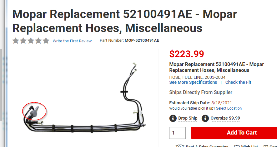

My vehicle listed above popped a check engine light. the codes showed an Evap leak. So we took it to a mechanic. He found which parts need to be replaced but one of the parts is discontinued. That part is 52100557AI. It is the valve on the fuel pump sending unit. I am unable to find a replacement online and was wondering if there was another part I could use instead.

Normally these parts get discontinued because they are not sold separate anymore. It appears this part is now offered with the hoses.
Please check the attachment below. Please double check and make sure this part number fits your vehicle as I think this specific one is meant for a Wrangler but the actual valve should be the same.
I would suggest getting it and just removing the part and not replacing all the hoses.
Your only other option is to find a salvage yard that has this vehicle and you can take one off of it.
Let us know if you have questions.
