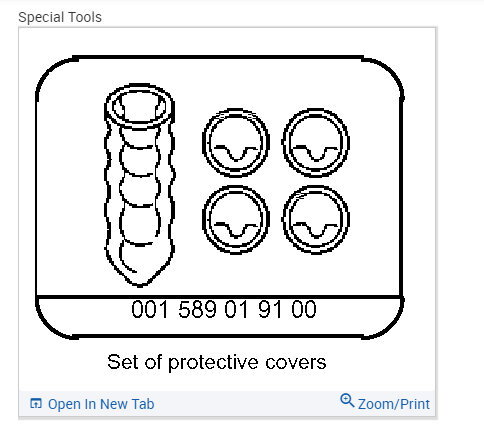

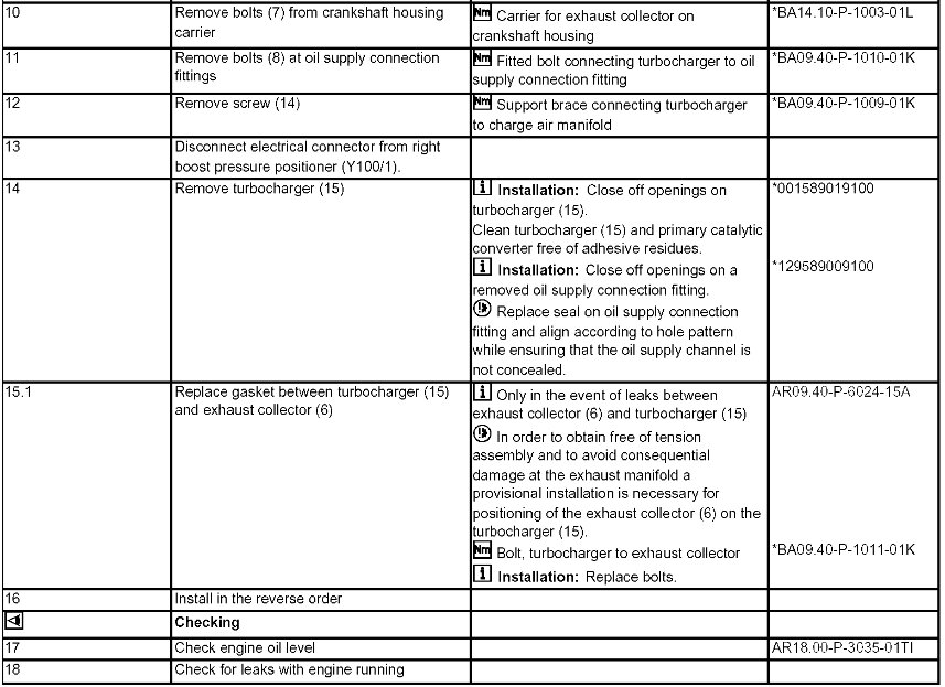

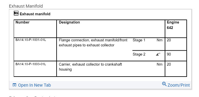

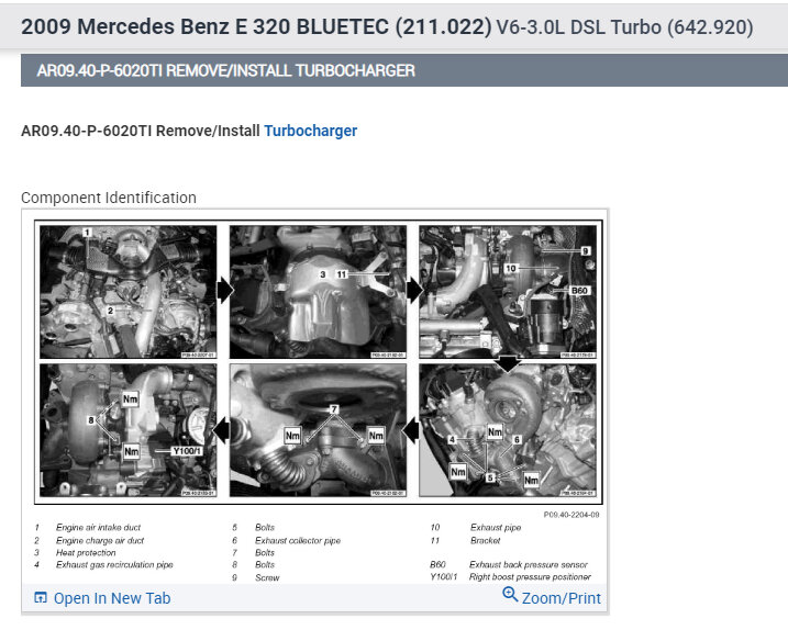

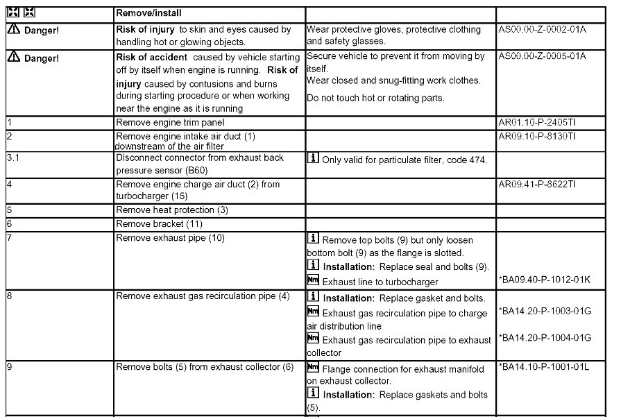

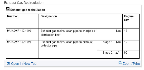

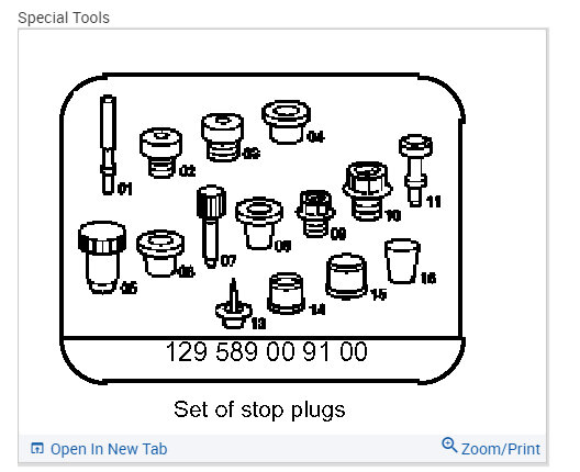

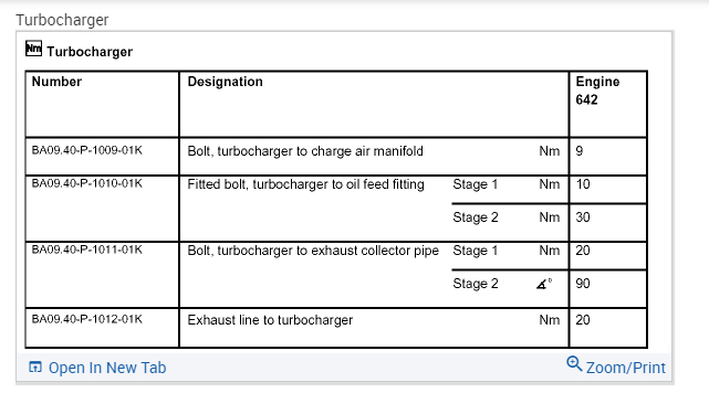

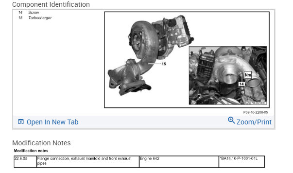

I attached the directions from my manual to remove and replace the turbocharger on this vehicle. It doesn't look too difficult but it will take some time.
The flat rate time is 3 hours, so it should be doable at home. Take a look through the directions and let me know if you are comfortable performing them or if you have questions.
Let me know if this helps.

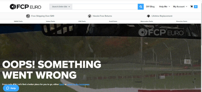

The turbo is lubricated via the engine oil when running. Is that what you mean? Also, I clicked on the link you sent and keep getting an error. See pic below.
See pic.

Hi Joe, sorry about the links. Not sure why they did not work. If you go to fcpeuro.com and search for: "Mercedes Turbocharger Upgrade Kit - Garrett 6420901200" you will see the replacement kit for the Turbo. I also tried putting "Mercedes Turbocharger Upgrade Kit - Garrett 6420901200" into an internet search bar, and the 4th hit was the FCP Euro link for the part.

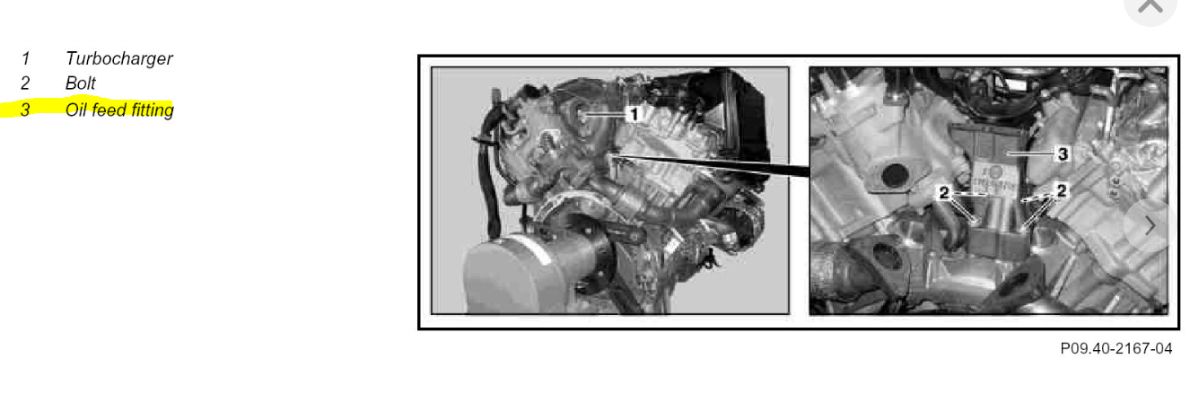

Yes, on the first-time start-up, you need to pre-lube the turbo to make sure the bearing is lubricated. It will take some time to get oil to it and running it without a lubricant will take time off its life. Actually, they say five seconds unlubricated is equal to about five minutes of running the engine with no oil
Normally, this is done via the oil feed port on the turbo. You would add the manufacturer's recommend lubricant via the feed a spin the turbo several times by hand. How much is added will be determined by the manufacturer.
I attached a pic below to help you locate the oil feed tubing.
See pic below.
