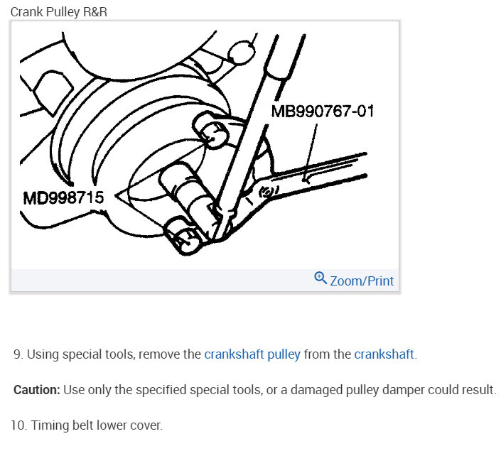

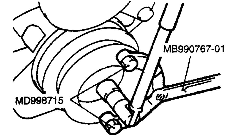

I need to replace the crankshaft seal, but how do I take the bolt off and the pulleys off?
Aug 6, 2018 at 10:37 AM
Good evening.
The bolt is very tight. If you have an air gun, that will release the bolt. Otherwise, you need the tool I attached in the photo.

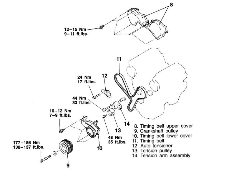

Once you remove the bolt, the balancer should just slide off. When you reattach it, the torque spec is listed in the other picture I attached.
Aug 6, 2018 at 11:26 AM
FIREWOODFLARES
  • 9 POSTS
After two days of trying to figure it out, you sent exactly what I needed. That is so cool, Thank you so much!

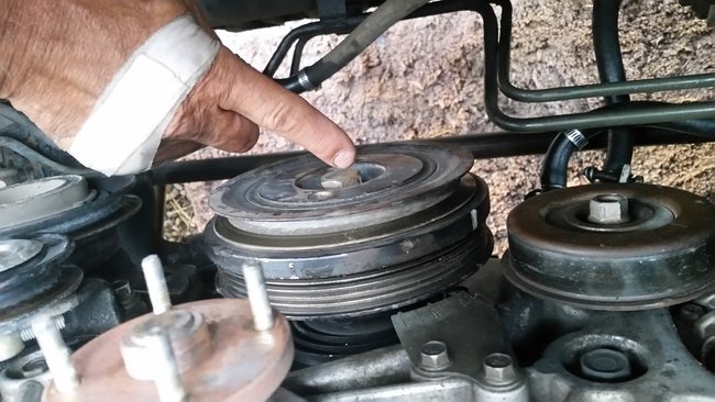

How do I take the pulley assembly off to get to the lower crankseal cover?
Aug 8, 2018 at 10:01 AM
Did you remove the center bolt from the pulley?
If you did, it should just slide off. Uou may need a hammer to hit the back of the pulley to help it off.
Aug 8, 2018 at 10:06 AM
FIREWOODFLARES
  • 9 POSTS
Maybe I did not explain it right. It is the whole assembly I need to take off. Here is a picture.

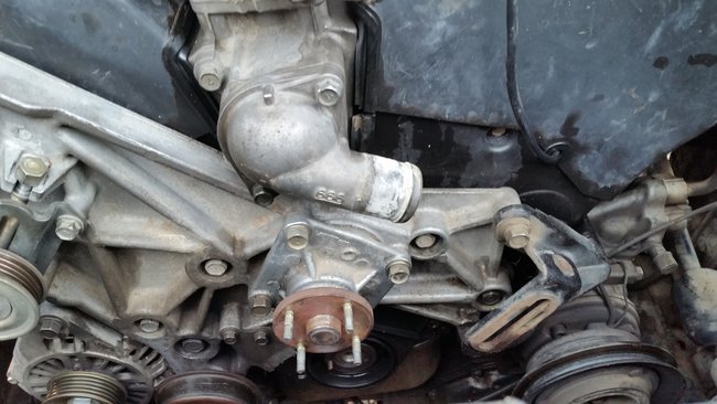

Here is the picture:
Aug 8, 2018 at 10:48 AM
Cannot see down to the balancer. Can you take a better picture?
Aug 8, 2018 at 8:10 PM
FIREWOODFLARES
  • 9 POSTS

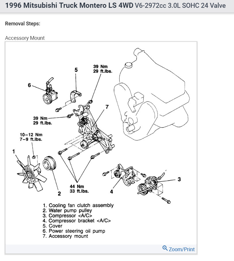

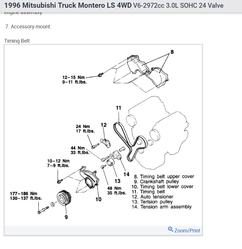

The balancer has been removed. Need to know how to take off all that you can see in picture - everything underneath where the thermostat goes. The metal piece that holds all the pulleys on.
Aug 8, 2018 at 11:31 PM
  • 55,711 POSTS

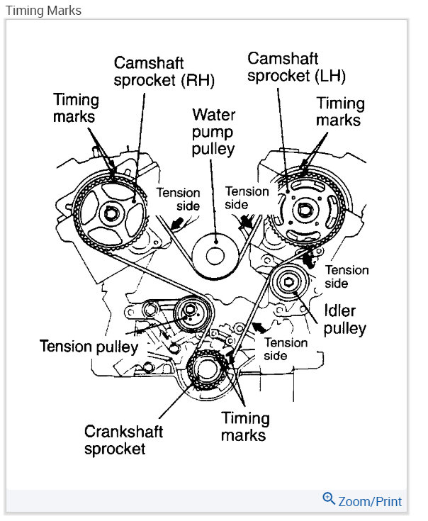

Yes, the timing belt, cover and accessories need to be removed. Here are diagrams and a guide to help you do the job:
https://www.2carpros.com/diagrams/mitsubishi/montero/1996
and
https://www.2carpros.com/articles/front-main-seal-replacement
Aug 11, 2018 at 7:17 AM
