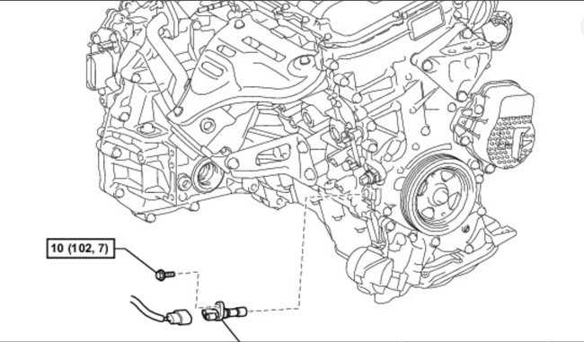

Yesterday (Sunday), the Power Steering alert came on in the car, causing it to shift into neutral and lock the wheel. I had the car towed back to the service department. Today after inspecting it again, they are saying that the battery was drained and I need a new crank shaft sensor.
Can these things be related? Could the error codes be a symptom of a larger problem that the service department is missing, or possibly caused by the head gasket and struts repair?

Why do they think it needs a crank sensor? Was there a code for it? Check your receipt for any information. The tech should have written a story.
https://www.2carpros.com/articles/how-a-crank-shaft-angle-sensor-works

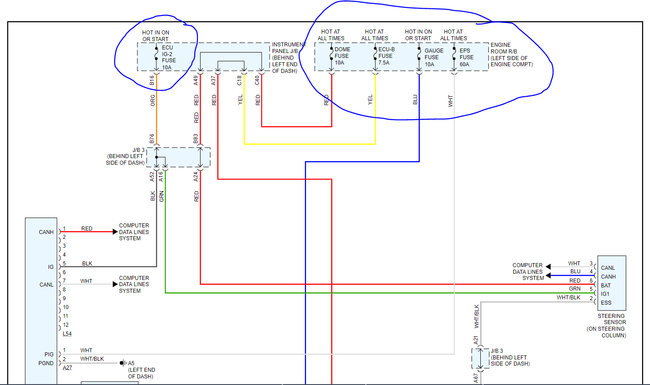

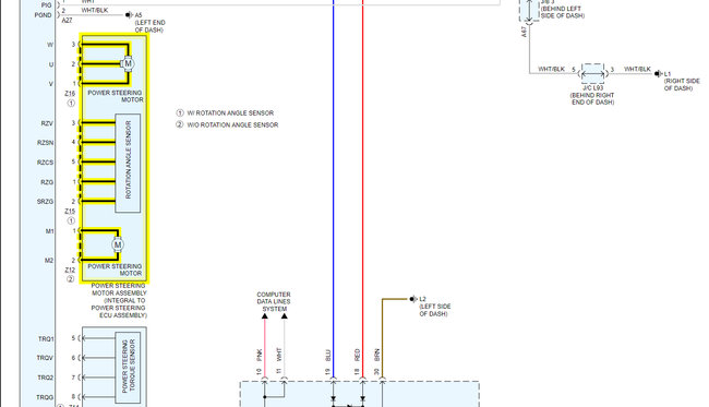

The steering is electric. When there is a fault, it sets a code as well.
I attached the diagram for you but you will need an advanced scan tool to monitor that system. Check the fuses I circled to sure they are good.
