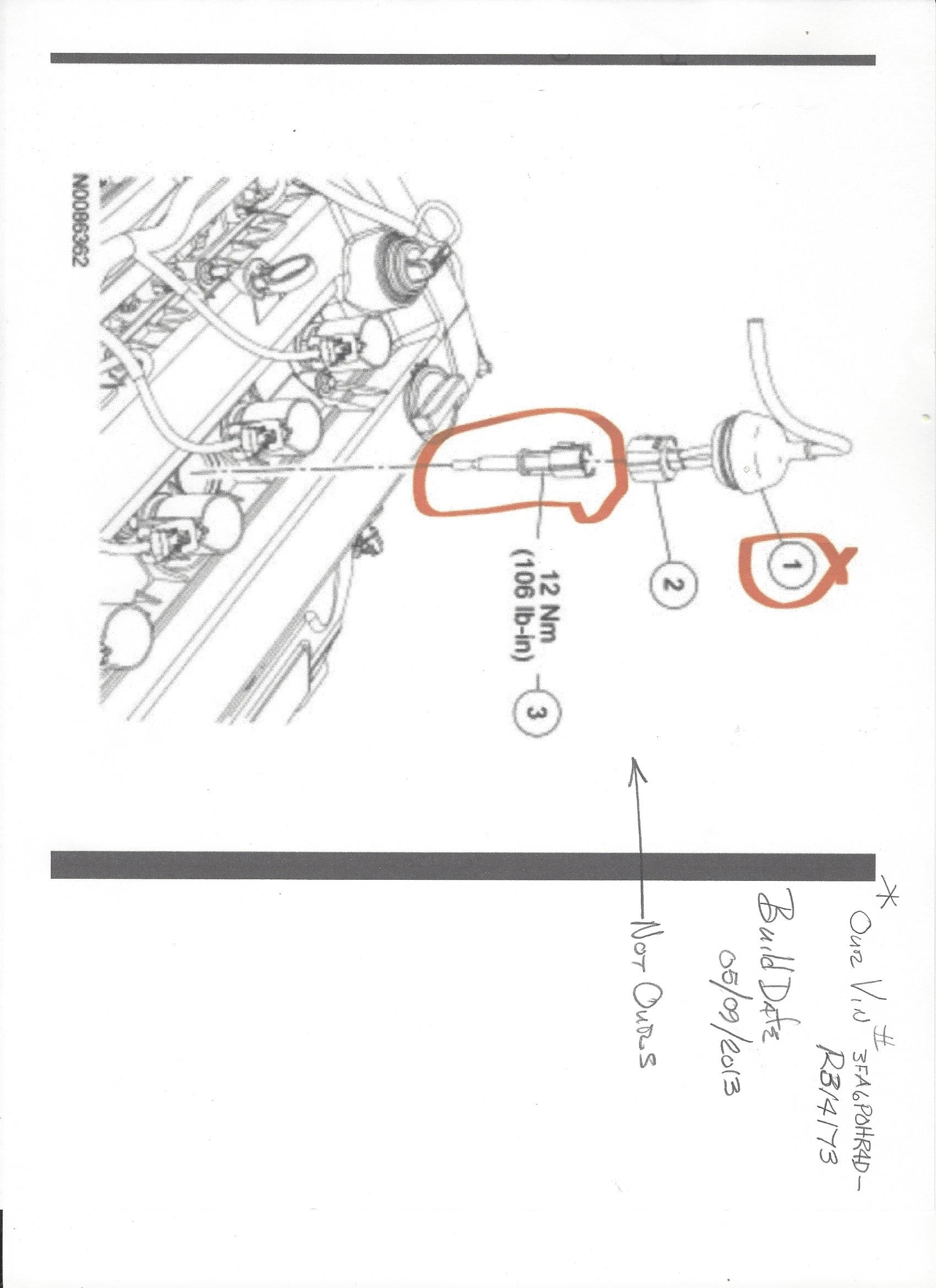

Started losing small amount coolant couple years ago. Add coolant every other oil change. Now, if wife goes to town shopping( 4 miles away),will loose 1/2" to 3/4" in tank. If drive 1-1/2 hrs. to doctor & back, loose nothing?
Didn't notice coolant low once , went to limp mode.
Replaced coolant temperature sensor, no change.

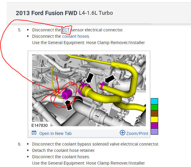

Was going to replace CHT, but can't find it. It's not where illustrations show.

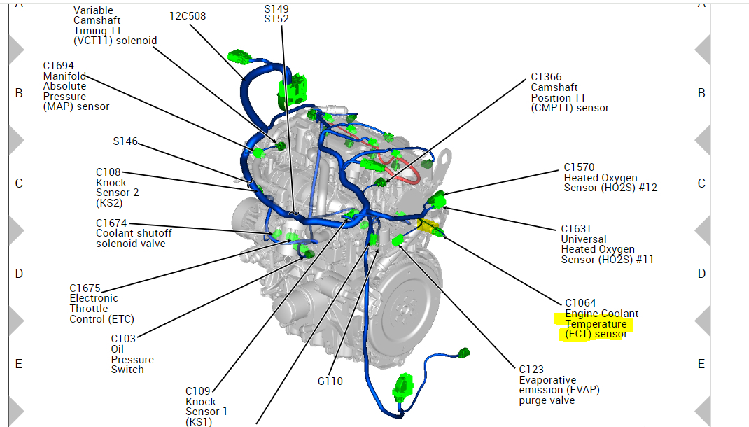

Are you able to locate where the coolant is leaking? Is there any evidence of white smoke from the exhaust?
I know there is a freeze plug between the number 2 and 3 spark plug tubes that can leak. It's a 20 mm freeze plug between #2 and #3 spark plug tubes that fails and (allegedly not uncommon) coolant fills the spark plug well area and drains. Not easy to find.
Check to see if there is any evidence of coolant near those two spark plug tubes.

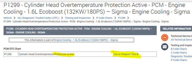

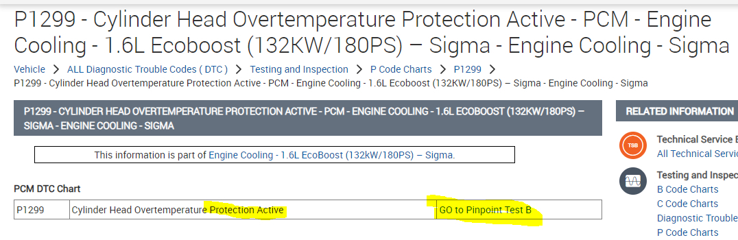

Also, I don't think the 1.6L uses a CHT. I believe it is a traditional engine coolant temp sensor. See pic below. The code you have is Cylinder Head Overtemperature Protection Active.
See pic below.

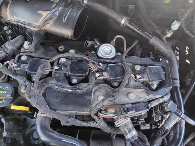

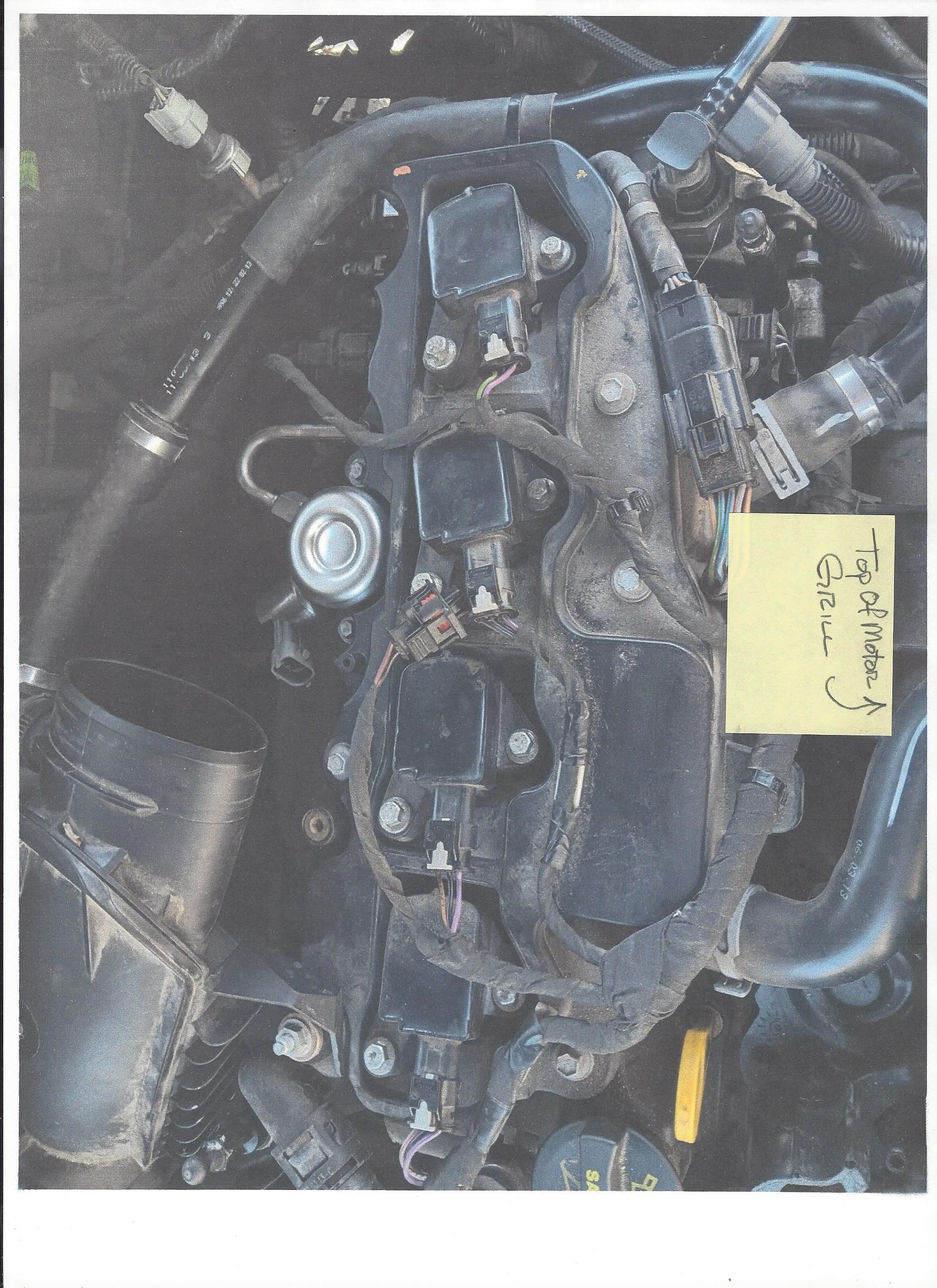

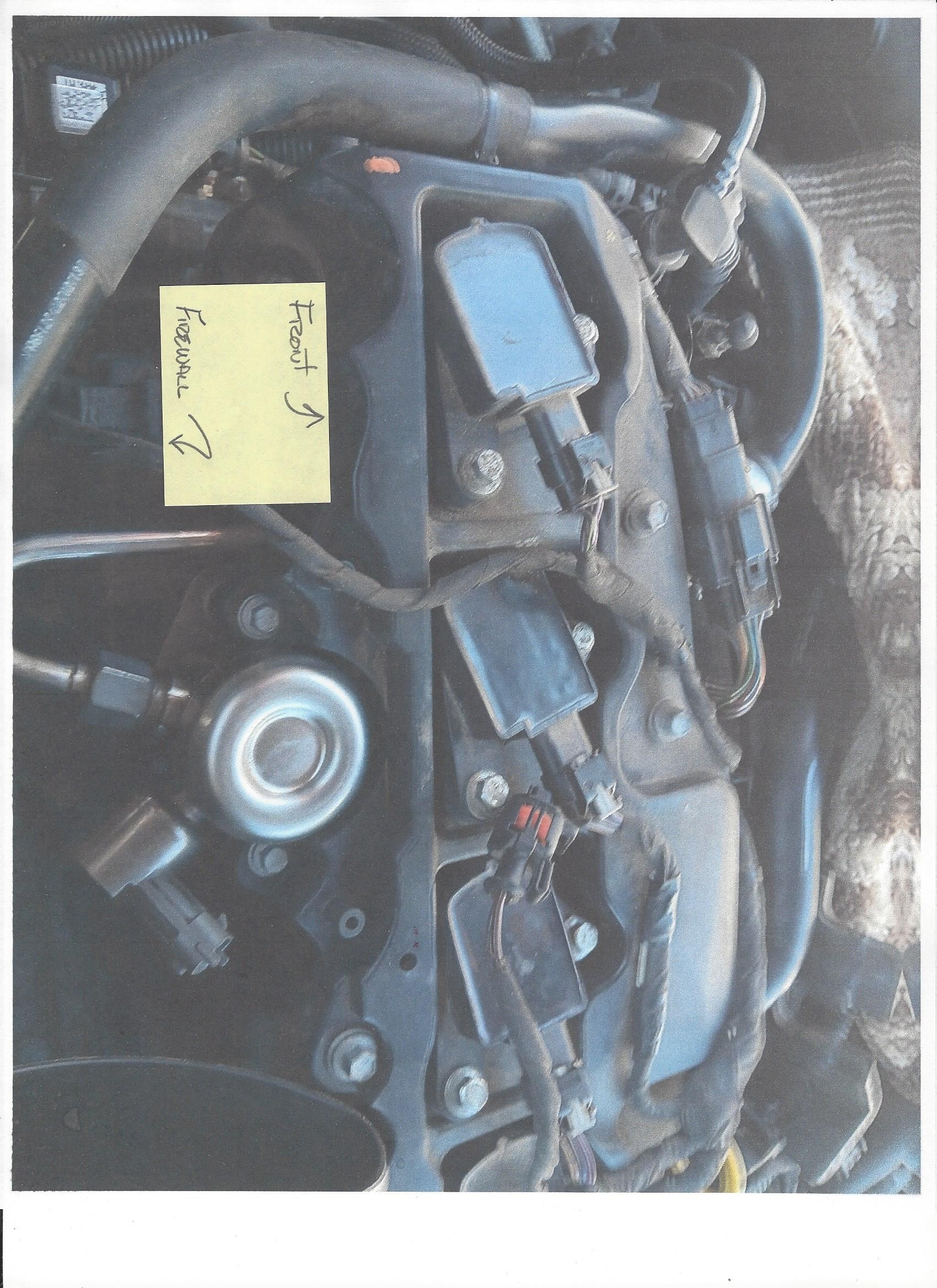

I'll try to attach a couple photos of the top of the motor and see if that works.
Stan
Aug 20, 2024 at 3:02 PM
5305A
  • 6 POSTS
Joe,
It would only let me load one photo, so I'll try again.
Stan
PS: Didn't see the edit, will try another. One view is from passenger side looking towards drivers side, other looking down on motor.
Aug 20, 2024 at 3:06 PM

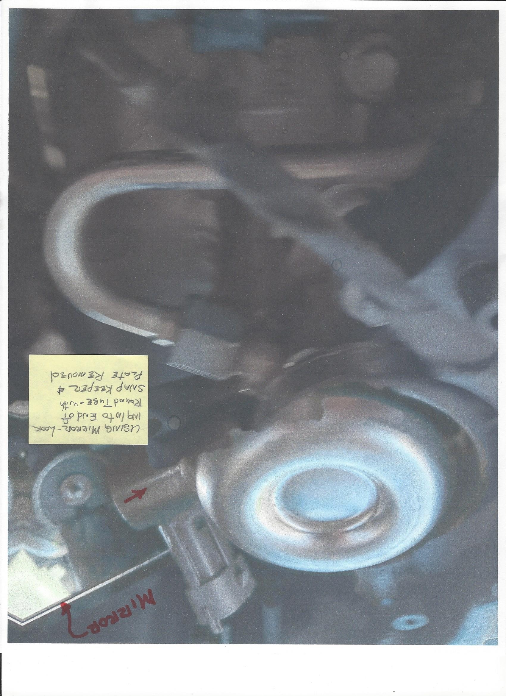

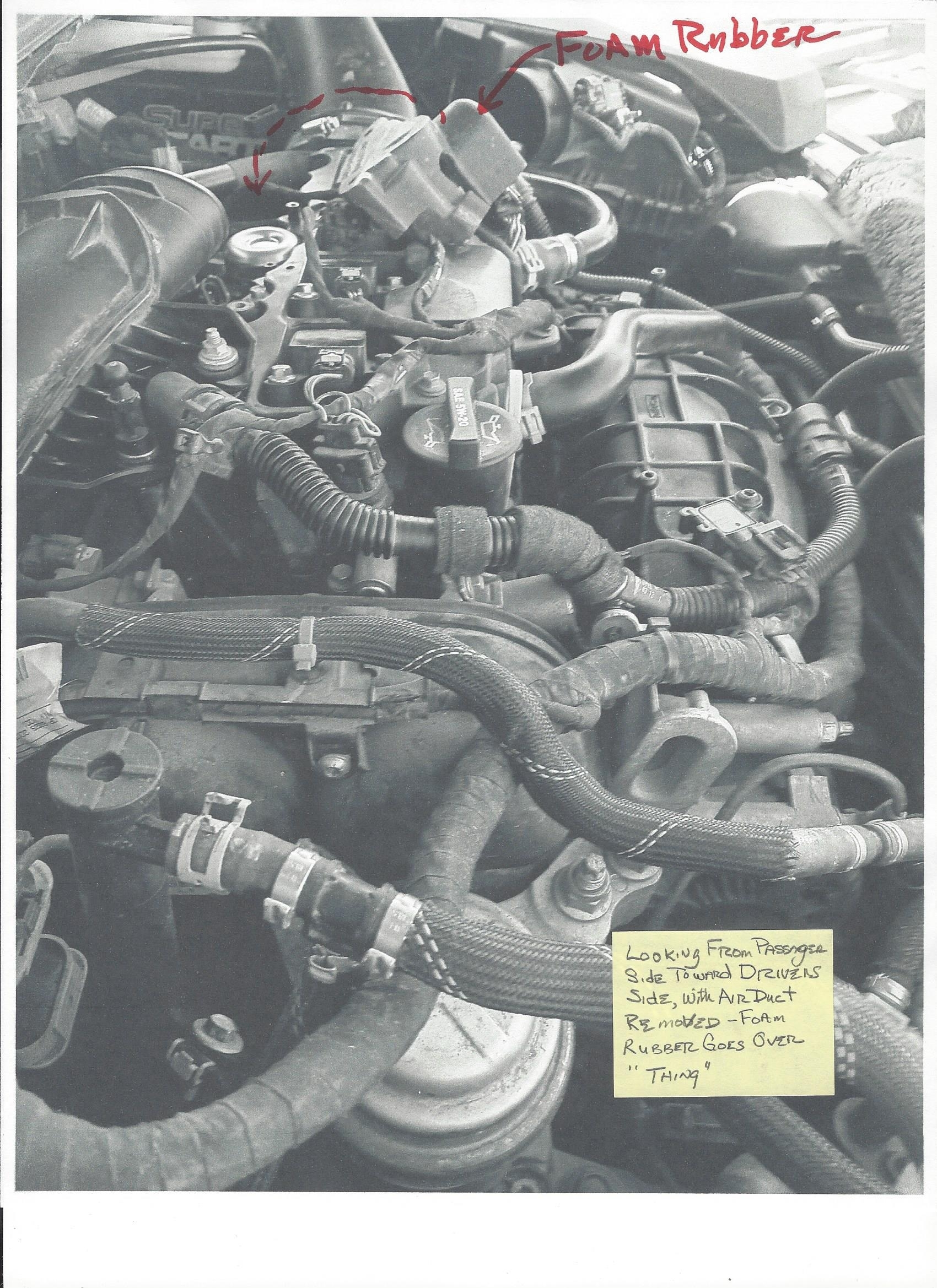

5305A
  • 6 POSTS
Joe,
I'm going to try to attach all photos now.
Good luck !
Stan

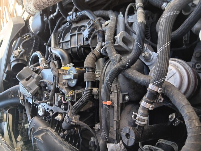

I do not see a CHT in your pictures.

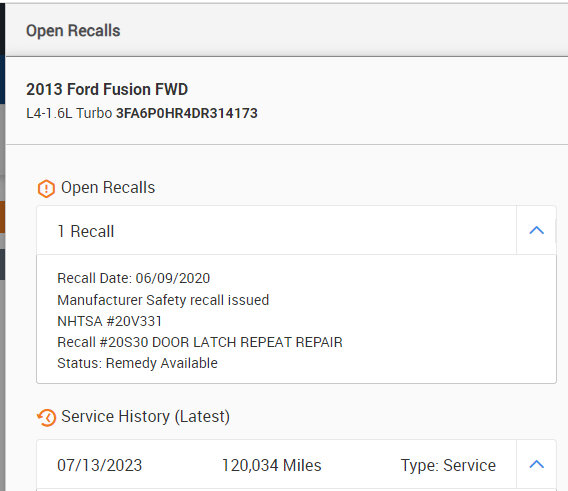

The pic (pic 2) is for a different size engine. I attached pics below.

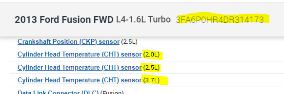

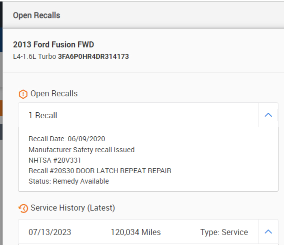

Pic 1 shows there is presently an open recall on the door latch. Pic 2 shows a CHT present on the 2.0L, 2.5L, and 3.7L but not the 1.6L.

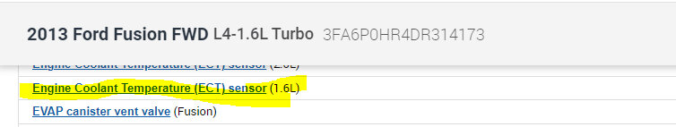

To find the 1.6, I have to go to engine coolant temperature sensor (ECT) in pic 3. Pic 4 shows its location.

When I go to the manual, the P1299 only indicates the cylinder head overtemperature protection is active.
I have diagnostics, but the next question asks if any other codes are present. Have you checked it again recently?
