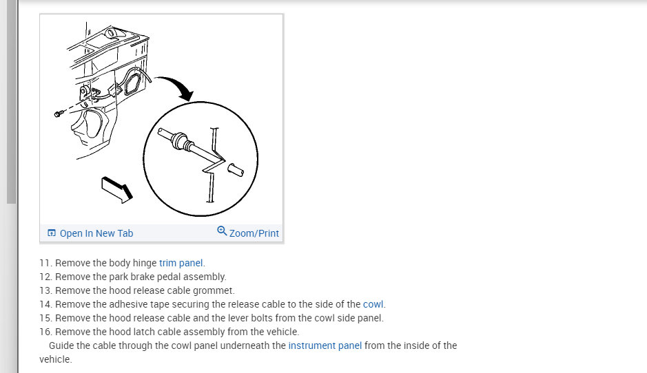

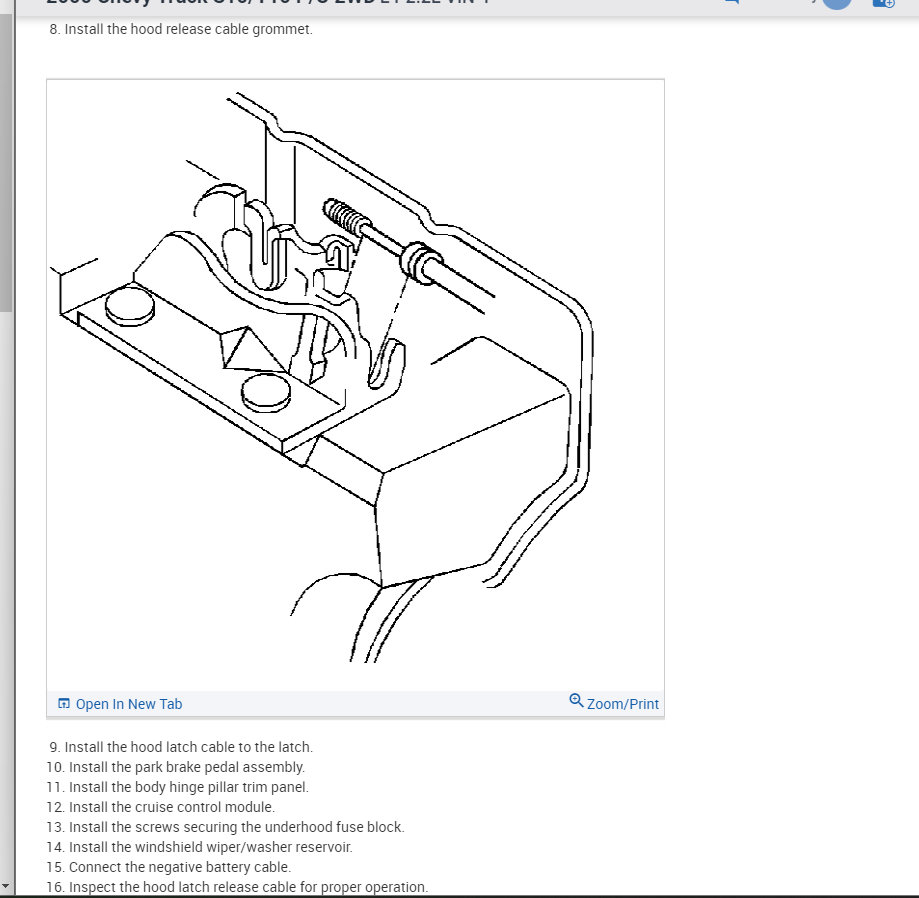

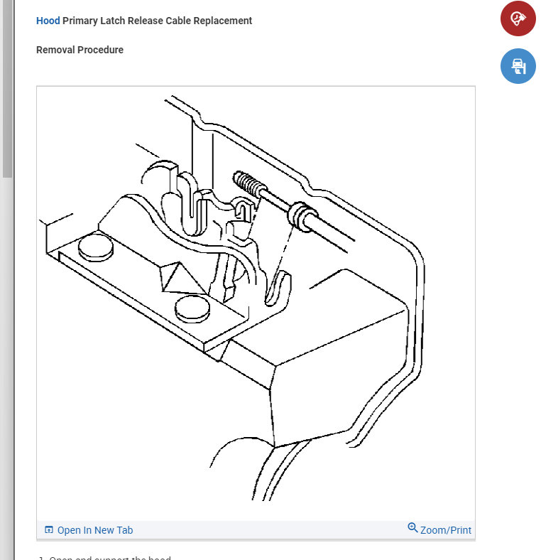

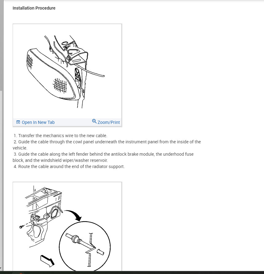

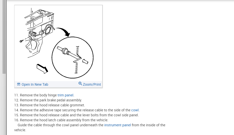

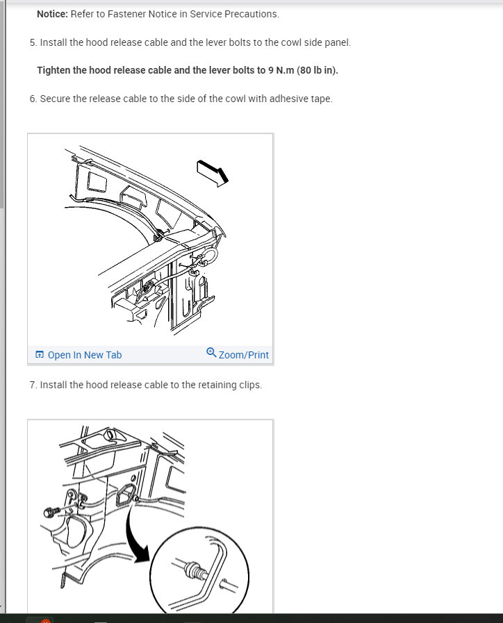

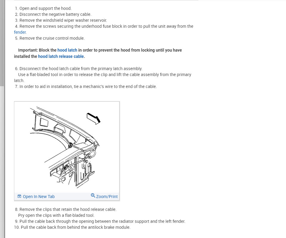

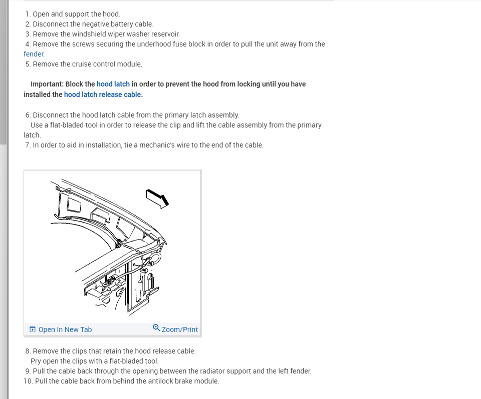

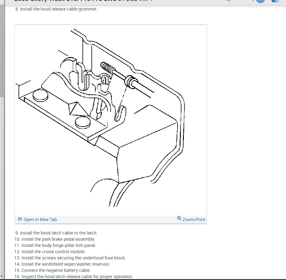

cable to open hood replacement.
Dec 7, 2021 at 3:54 PM
I am attaching the process below on how to replace this cable.
Here is a guide that will help others that may need it with opening the hood if needed:
https://www.2carpros.com/articles/how-to-open-a-car-hood
Please find the process below from the manual on replacing the cable. Let us know what other info you need, and we can go from there.
