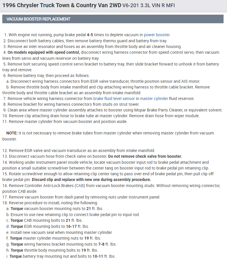

If you would please elaborate on the question. It appears not to be complete.
I am assuming you have an issue with the brake system, possibly the pedal requires too much pressure. Or the pedal goes to the floor?
Please let me know what you are experiencing.
https://www.2carpros.com/articles/brake-pedal-goes-to-the-floor

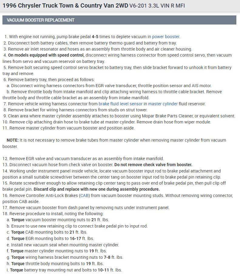

I have attached the brake booster replacement procedure.
