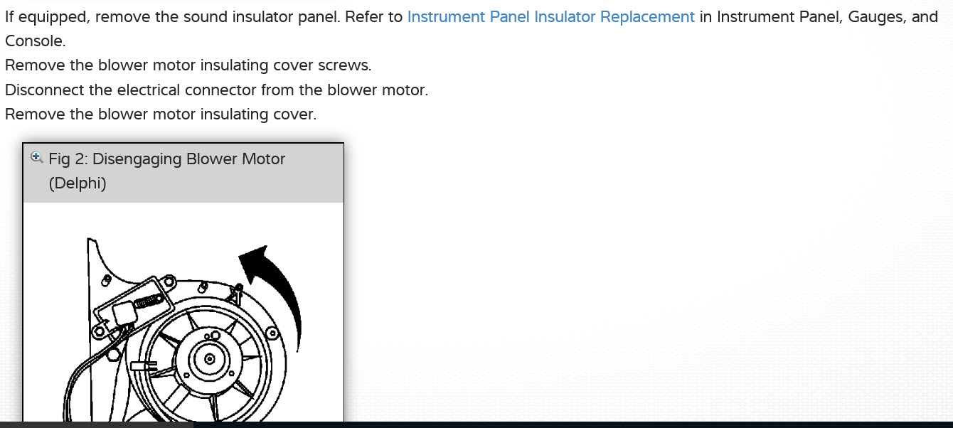

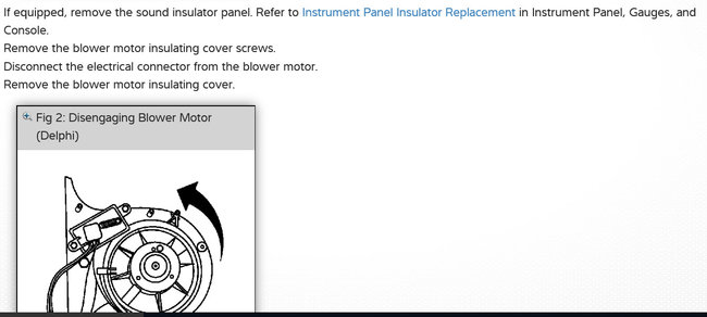

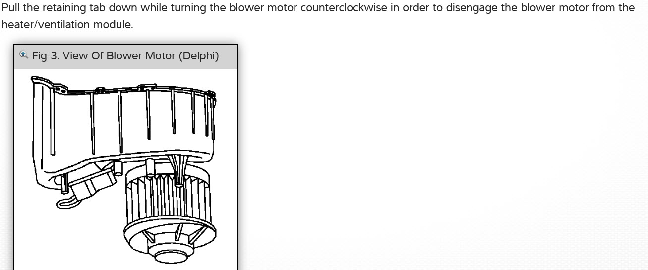

2001 GMC C1500
4.8L
V8
4WD
215,000 MILES
Replace blower fan
Friday, February 12th, 2016 AT 3:20 PM
HMAC300
MECHANIC
48,601 POSTS
Check fuse and relay in under hood fuse box first to make sure that isn't the problem. See pics for replacement
