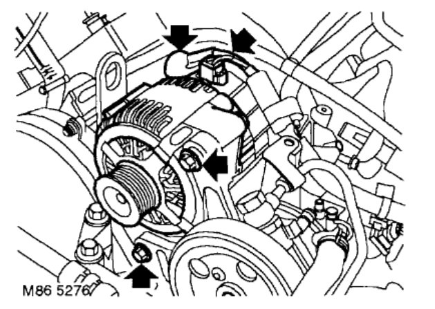

Cannot remove bottom bolt from alternator. Not enough room for the bottom bolt to slide out to remove the alternator. Motor mount in the way.

Here are the instructions from the manual:
Remove
Disconnect battery earth lead.
Remove top arm.

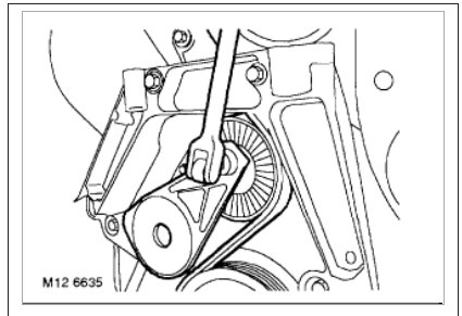

Using a 3/8" square drive socket bar, raise ancillary drive belt tensioner and release drive belt from alternator pulley.
Release alternator battery lead terminal cover, loosen terminal nut and disconnect lead from terminal
Disconnect alternator multiplug.
Remove lower bolt and upper nut and bolt securing alternator to front mounting plate.
Remove alternator.

Using a 3/8" square drive socket bar, raise ancillary drive belt tensioner and fit drive belt to pulleys.

Below are the diagrams on the alternator replacement.
