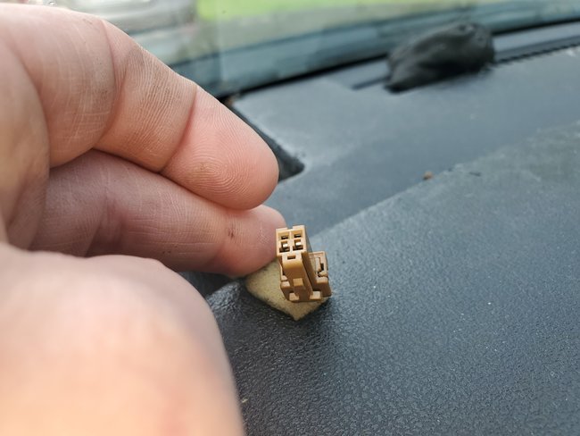

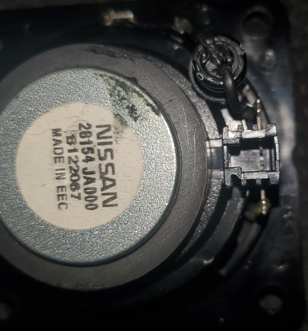

Does anyone know how to replace the 2 factory 3.5" front dash speakers on the car listed above with aftermarket ones? Crutchfield doesn't have a speaker wire harness for the 3.5" In fact if you buy new 3.5" speakers from them they include 3' of speaker wire female quick slide terminals and butt connectors. I already have the factory speakers removed just need to know how to install new ones.

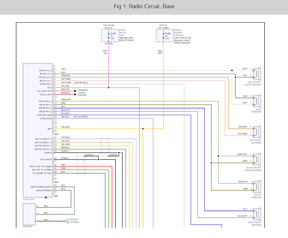

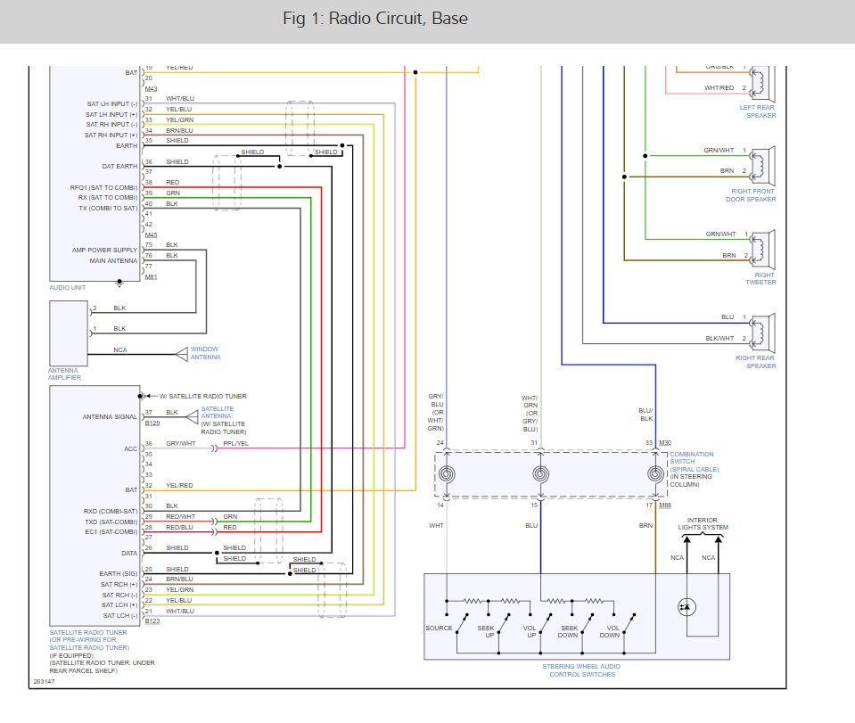

You will nee to spice the wires into the connector to make the speaker work. here is a guide to help you check the connections and the radio wiring diagrams so you can see how the speaker are connected:
