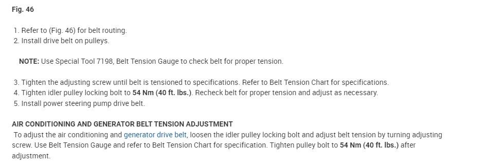

Can't get belt back on.
Feb 16, 2020 at 4:04 PM
Experienced Mechanic
52,796 POSTS
Good morning,

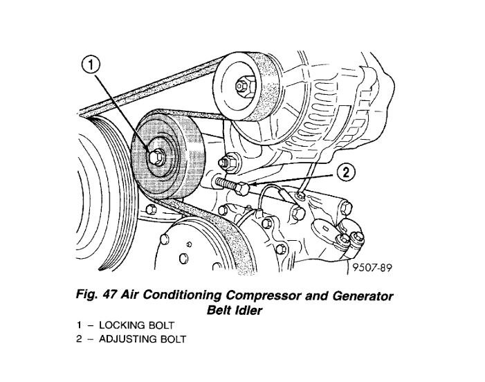

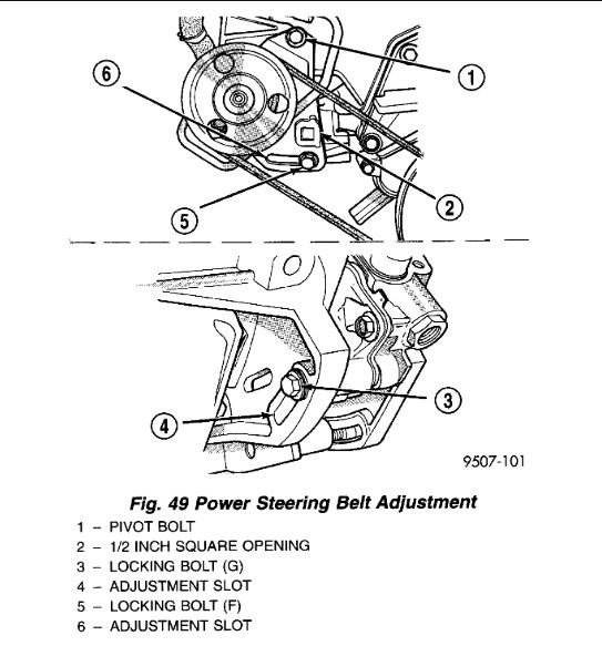

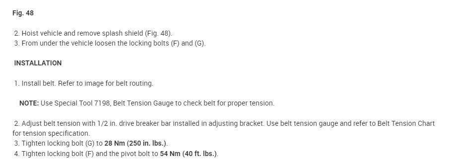

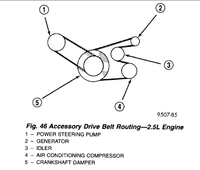

I attached pictures and the procedure for you to follow. Check out the diagrams (Below). Please let us know if you need anything else to get the problem fixed.
