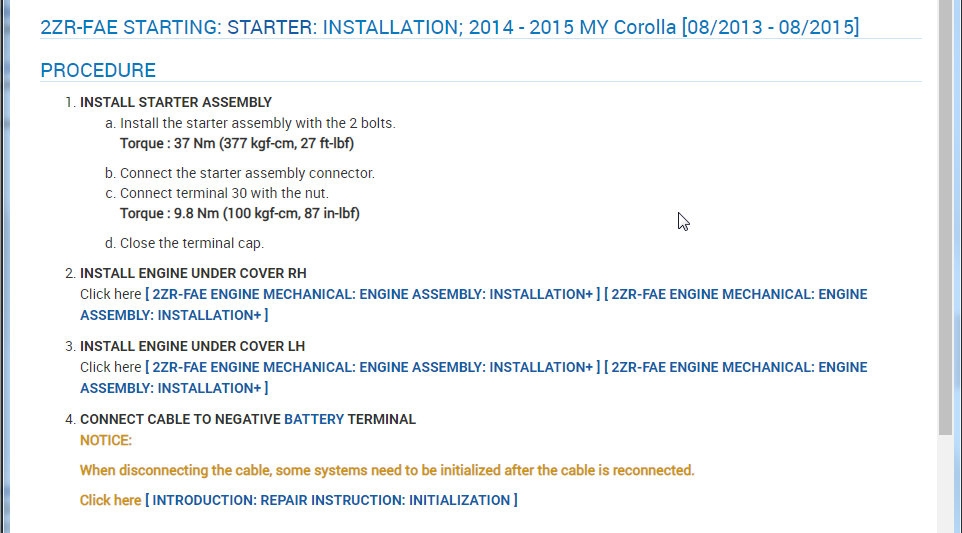

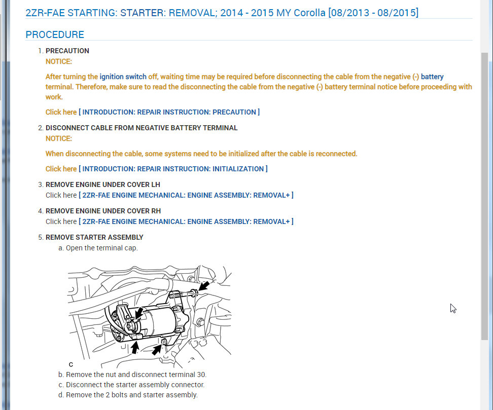

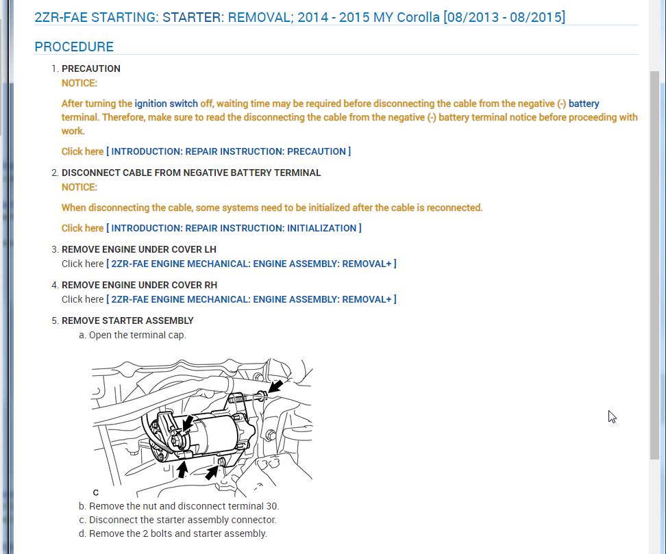

Below is the process from the manual on how to replace the starter if this checks out. Let us know if you have questions and we can go from there. Thanks
