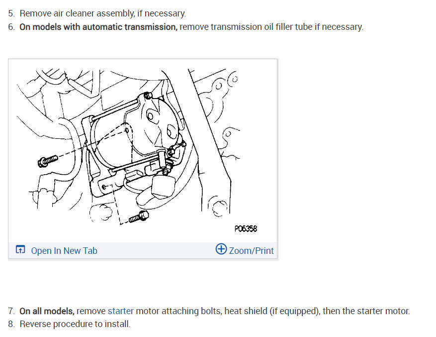

Hi. Turn key and hear a small click. Car doesn't even attempt to start. Battery is good. Headlights are strong, dome light and radio work. I am assuming the starter solenoid but need a professional opinion. Thank you.

Hi there,
Yes I agree with you own diagnosis of the starter. The click is the solenoid energizing but the contacts are not making a good connection to energise the starter, get the starter over hauled to solve your problem.

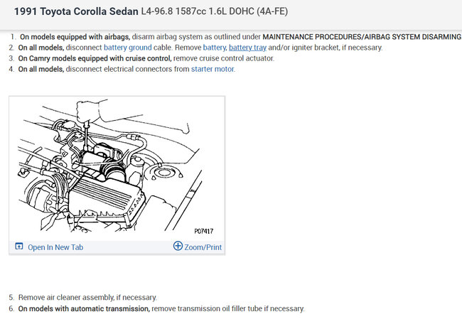

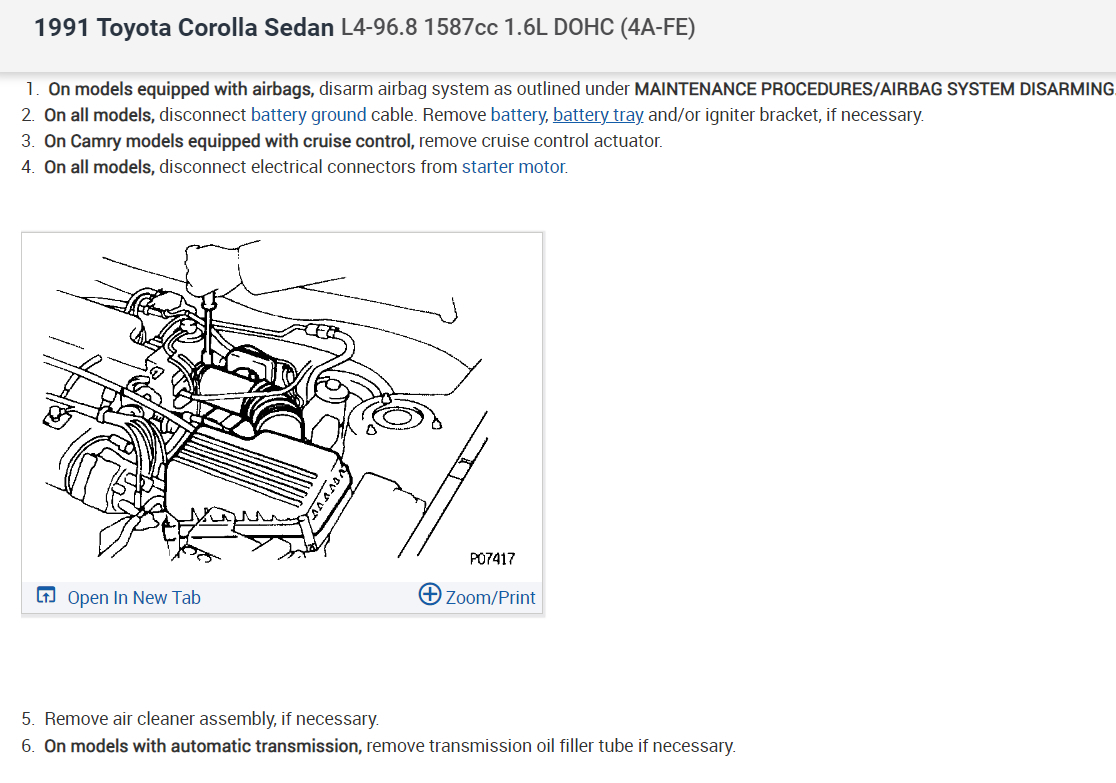

Yep, this guide will show you how.
Here is how to change out the starter motor. Check out the images (below). Please let us know what happens.
