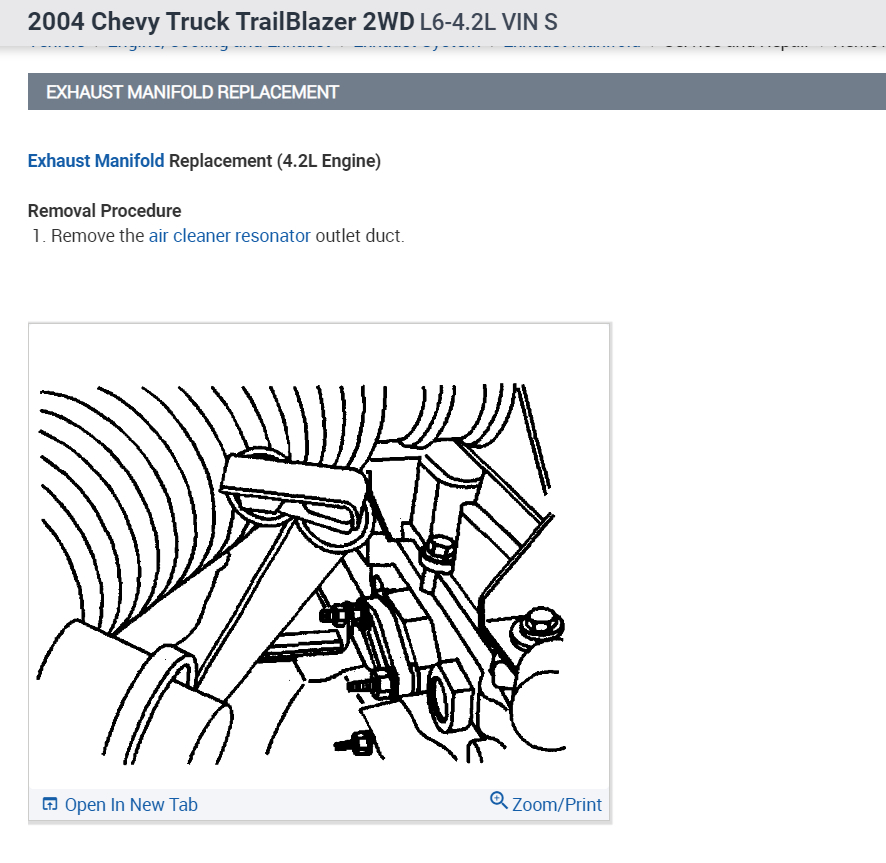

It’s loud seems to come from the exhaust manifold an the check engine light is on.

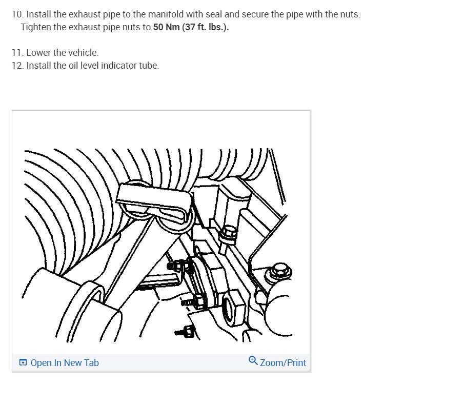

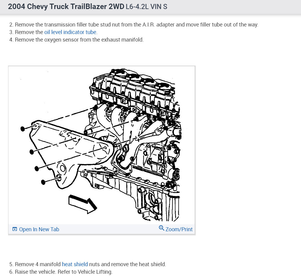

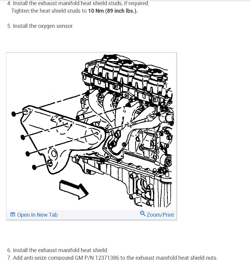

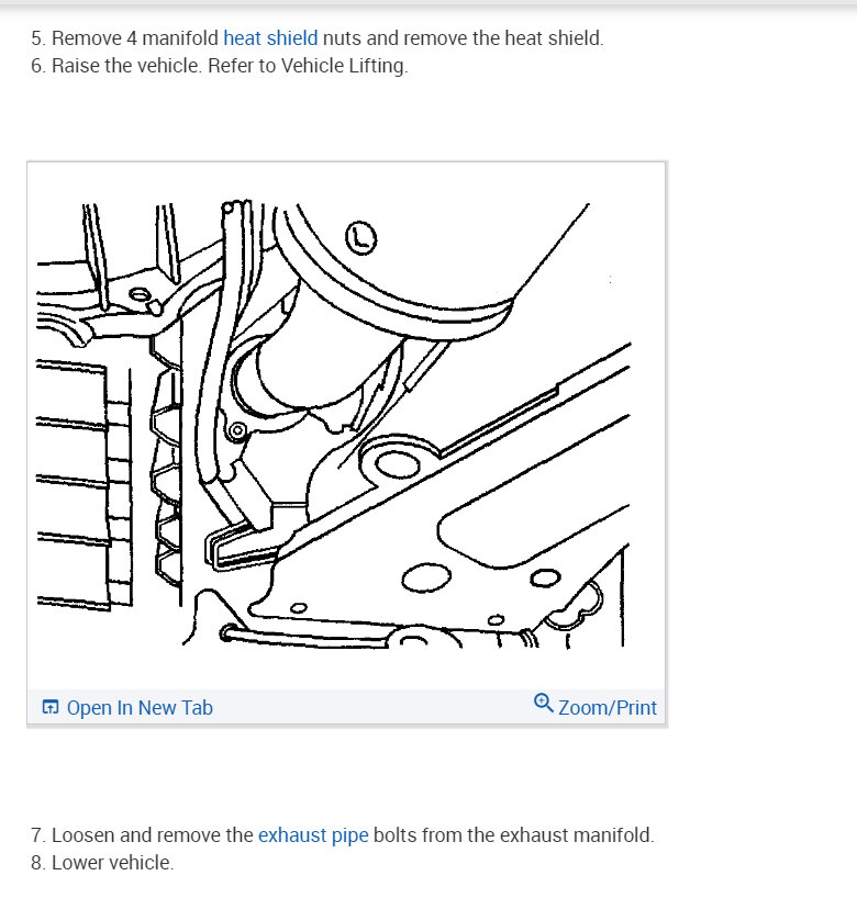

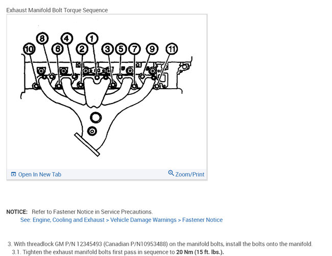

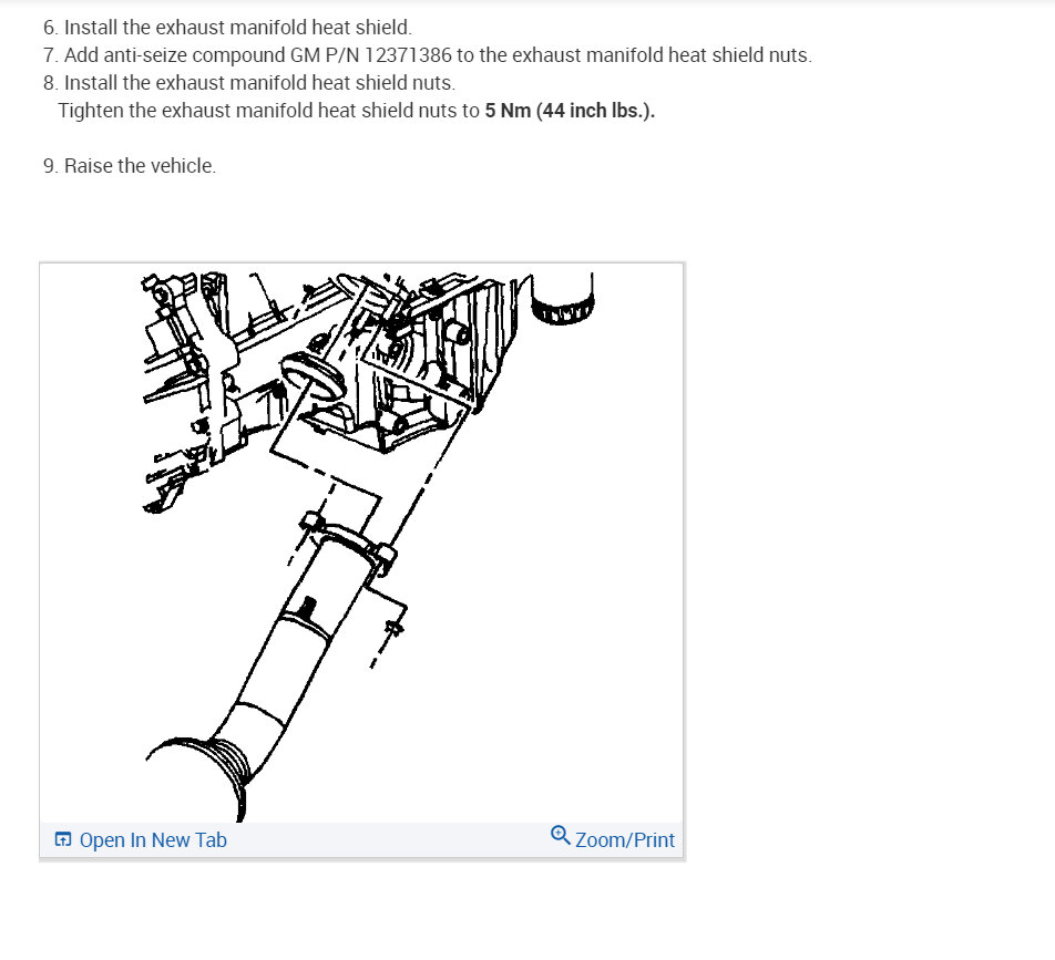

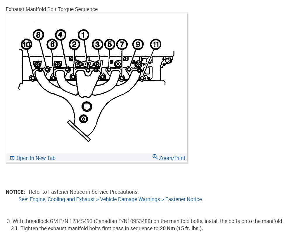

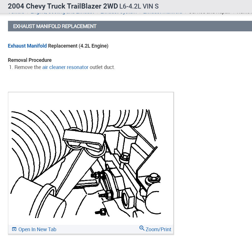

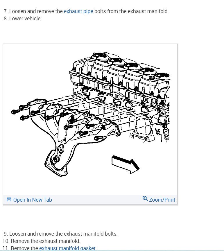

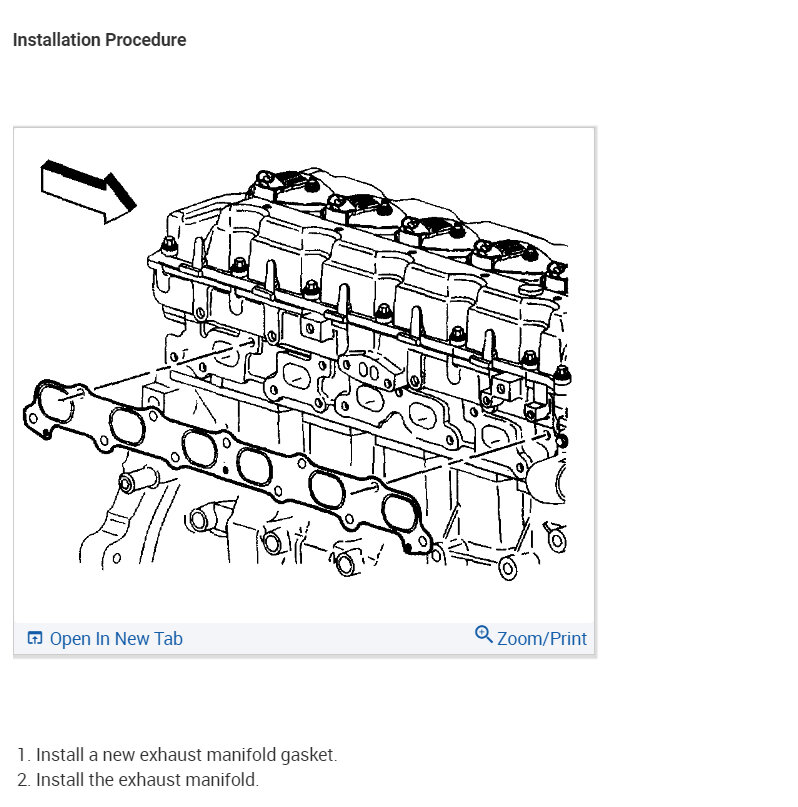

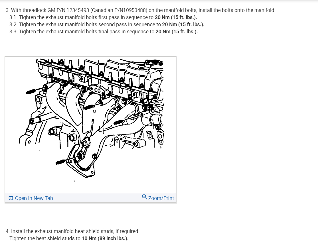

Yep, a leaky exhaust manifold will make the check engine light come on, when replacing the manifold look for broken exhaust studs.
This video will help you remove them:
https://youtu.be/py-rIWATchY
Here is how the job is done in the images below. Let us know what happens and please upload pictures or videos of the problem so we can see what's going on. Clear the codes when completed
