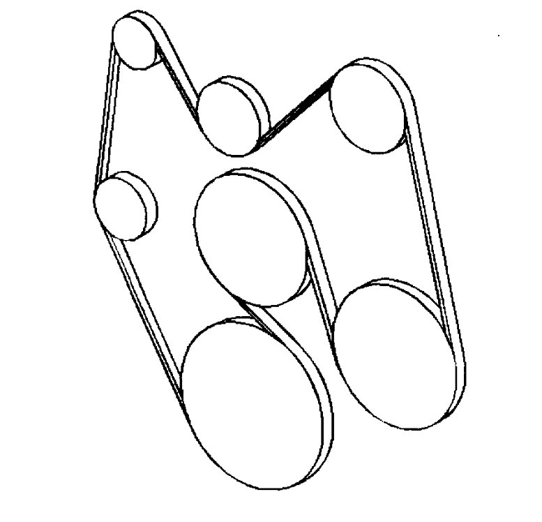

Honestly, if the belt is routed properly, the tensioner is good as well as the belt, and there is no oil, grease, or coolant getting on the belt, the only other thing is if something is locking up. I attached a pic of the routing diagram just to confirm it is on correctly.

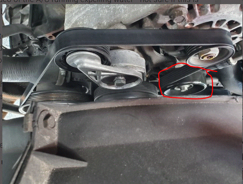

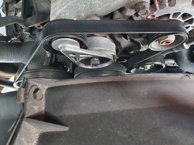

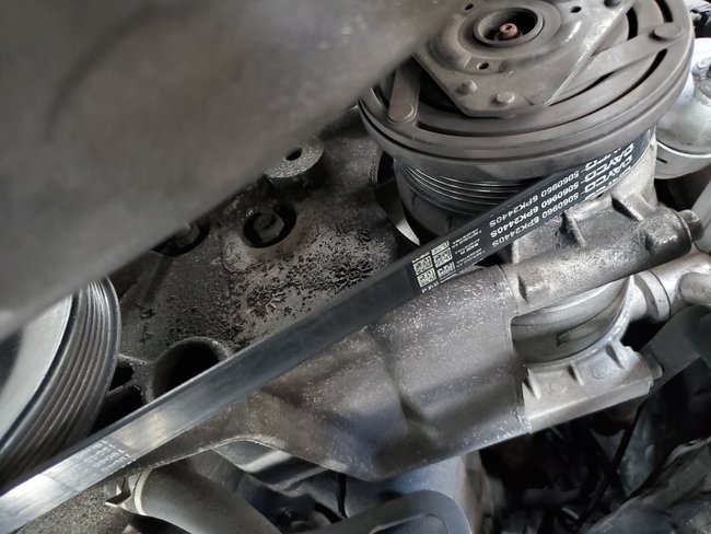

Attached you will find the video of the noise at start, drive and turning the A/C on. You will also find pictures of the belt installation, to the best of my ability. There is one more video of the A/C running expelling water - not sure if this is normal or would attribute to the noise somehow.
The only thing that stopped the noise was when I turned the A/C on but that was before I replaced the belt the first time - which is why I thought the serpentine belt was bad. The noise continued after I replaced the belt the first and second time - and still continued after replacing the pulley and the belt tensioner. As to which pulley, I was not aware there were more than one when I purchased it at Advance Auto. You would think they would ask! Good question. How many pulley's are there for this vehicle? (Wish I had access to AllData!)

Also, if you look at the pic I attached (which is your pic), I circled what I believe to be an idler pulley. That has a bearing in it that can be going bad.

The picture of the pulley you attached was replaced as well as the belt tensioner. Those are new parts. I somewhat understand "car repair" as my dad was a mechanic and I worked at a mechanic shop for some time, although I worked in the office ordering parts and occasionally talked to the mechanics.
Is there any reason why the belt should have corrosion on it? Like I said before, when I changed the belt the first time there was corrosion residua on a section of the belt. When I changed the pulley and the tensioner, I swapped the new b3lt for another new belt and when I removed the old "new" belt it also had corrosion residue on a section of the belt. I'm thinking there is a pulley that has corrosion and I'm thinking it may be the one coming from the alternator. I don't know. What are your thoughts on this?

Okay, what type of corrosion was already on the new belt? I suspect that is the cause and not any of the pulleys. Can you identify it? Does it look like oil? Could it be coolant? Can you upload a picture of what you saw? I have seen the water pump leak from the weep hole and get coolant on the belt and cause this.
