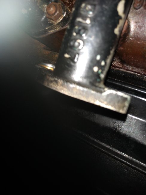

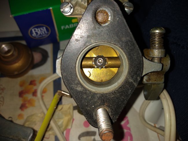

Good morning,
Can you upload some pictures of what you see so I can see what you are dealing with?
Friday, May 15th, 2020 AT 3:41 AM
POLIZEME25
  • 61 POSTS
Roy,
Thank you for your quick reply. Here are two pictures. If you need anything else please let me know.
Thanks,
Kenny
Friday, May 15th, 2020 AT 4:22 AM

This looks like a 3/8 size bolt? Is that correct?
If it is, does the bolt go in at all? Are there any threads left in the housing?
Do you have a clear shot of installing a bolt from the bottom of the mount on the intake?
Friday, May 15th, 2020 AT 4:41 AM
POLIZEME25
  • 61 POSTS
Roy, hi it's not out of Vega, it's out of a 1930 car. Nothing is broken, inside of the carburetor, what you see is the inside of the carburetor. It's a Tillotson carburetor, no longer makes parts. My question is a general question, not car Specific. There are no experts in this category.
Kenny
Friday, May 15th, 2020 AT 4:42 AM
  • 52,797 POSTS
I got that.
I posted an answer or request about access. Can you address that?
Friday, May 15th, 2020 AT 4:59 AM

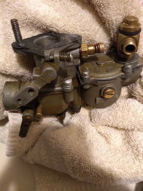

POLIZEME25
  • 61 POSTS
Roy,
The bolt is a 1/4 - 20. There are no threads left in the housing, the hole the threaded bolt goes into is larger than 1/4 -20. The carburetor is an updraft carburetor, the two threaded bolts go up through the bottom of the intake flange, two nuts hold the carburetor to the flange.
See photo of flange.
Kenny
Friday, May 15th, 2020 AT 6:10 AM
  • 52,797 POSTS
Wow, I wish I had a better resolution for this.
It looks like you will need a new body for it to accept the mounting stud.
I know that is easy to say but I do not see anything else other than a heli coil. The problem with that is the threads and the body staying in place. You would need to drill out the hole to 5/16 and then thread it to accept the 1/4 threads. Do you think the body has enough room to drill it out?
Friday, May 15th, 2020 AT 6:31 AM
