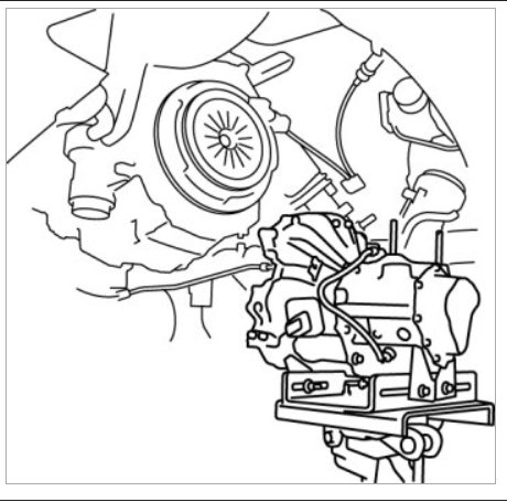

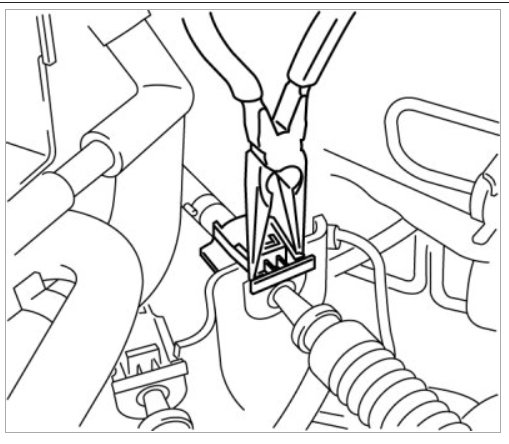

My car listed above is a hatchback and it needs new clutch. Mechanic estimate is $1,300.00 to $1,700.00 depending if flywheel needs to be replaced. I also have some body damage that will cost plus or minus three grand to repair. Not sure if I should put that kind of money into the car or look for a used car to replace it. Was thinking of a Honda CRV or Fit, or doing another Mazda 3. I like the car. Or should I just go with the repairs? Thanks for your help.

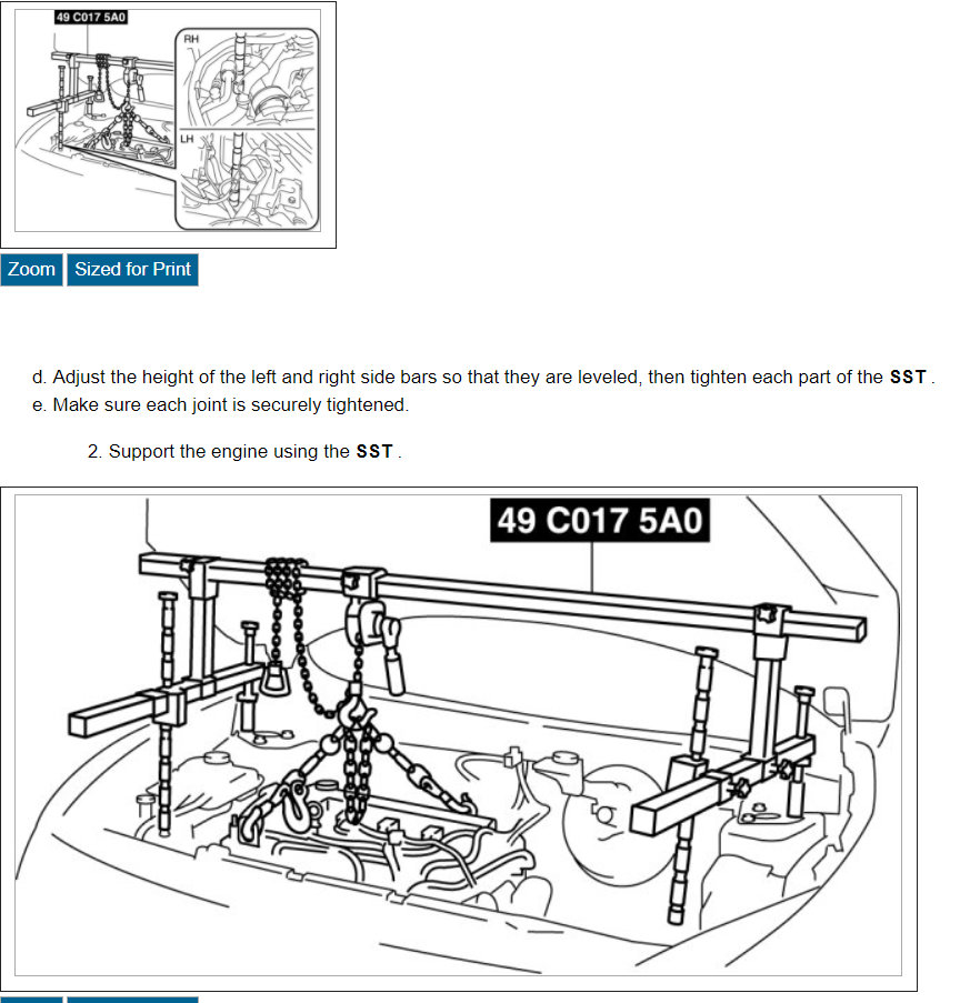

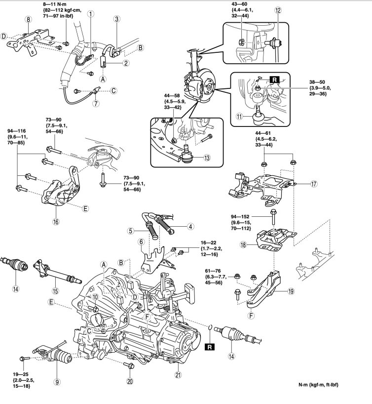

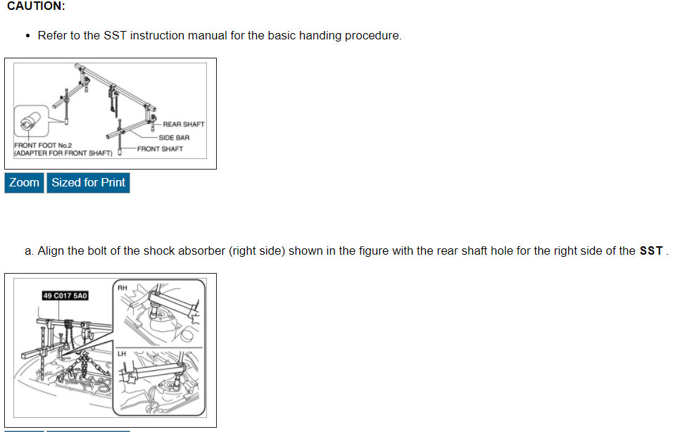

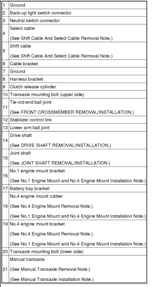

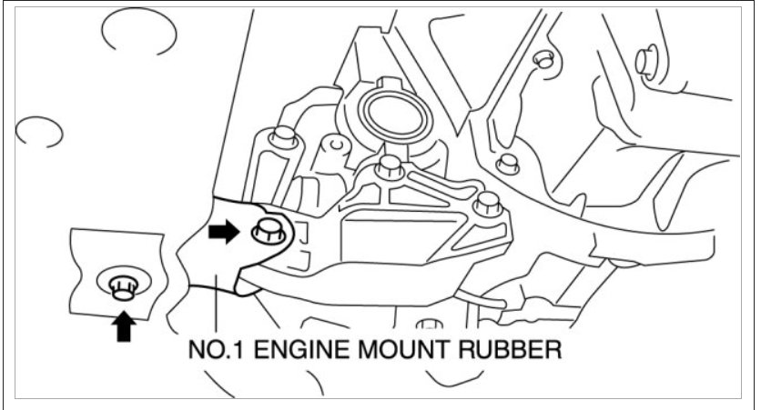

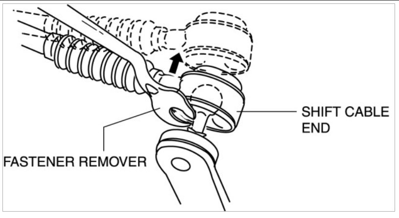

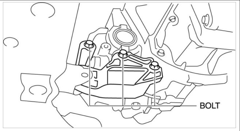

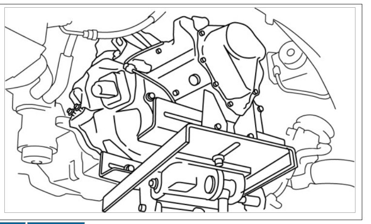

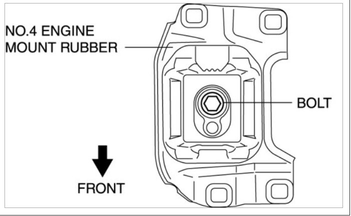

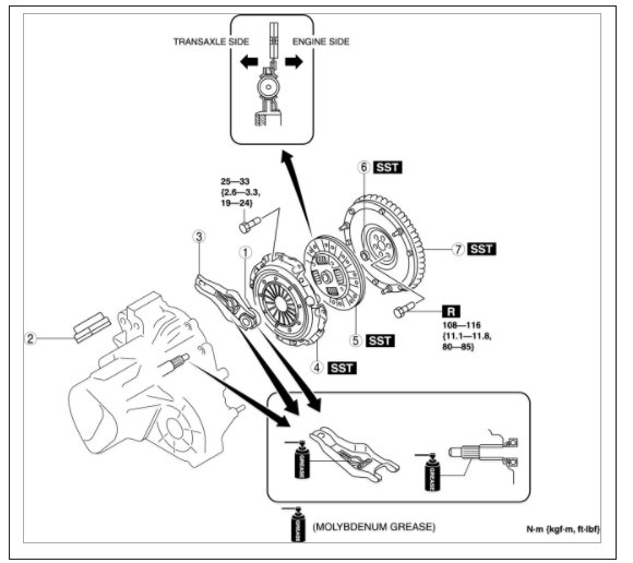

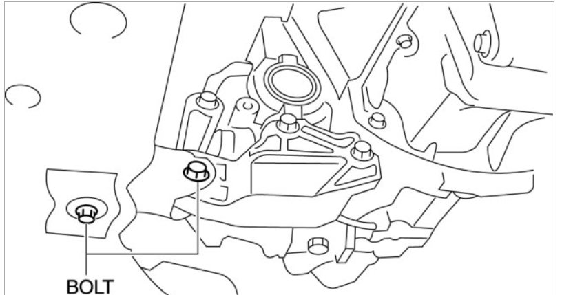

With only 88,000 this car has plenty left in it and will cost much more to replace the car. Here is a guide to help you see how to replace the clutch once the transmission is out so you can see whats going on:
https://www.2carpros.com/articles/how-to-replace-a-clutch
By the way, you can get a new clutch kit on Amazon for $202.00.
https://www.amazon.com/LuK-10-064-Clutch-Kit/dp/B004SSBBJ4/ref=sr_1_1?s=automotive&ie=UTF8&qid=1524092857&vehicle=2011-80-2435-------------0&sr=1-1&ymm=2011%3Amazda%3A3&keywords=2011+MAZDA+3+clutch
You will need to pull the CV axles.
https://www.2carpros.com/articles/replace-cv-axle
Here are diagrams to help you see how to get the transmission out.
