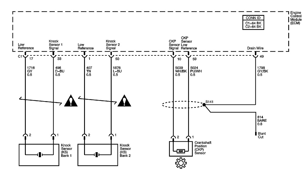

Crankshaft position sensor would cause no spark, no fuel injector pulses, and no fuel pump, but the starter will crank the engine just fine. This has nothing to do with the battery or generator.

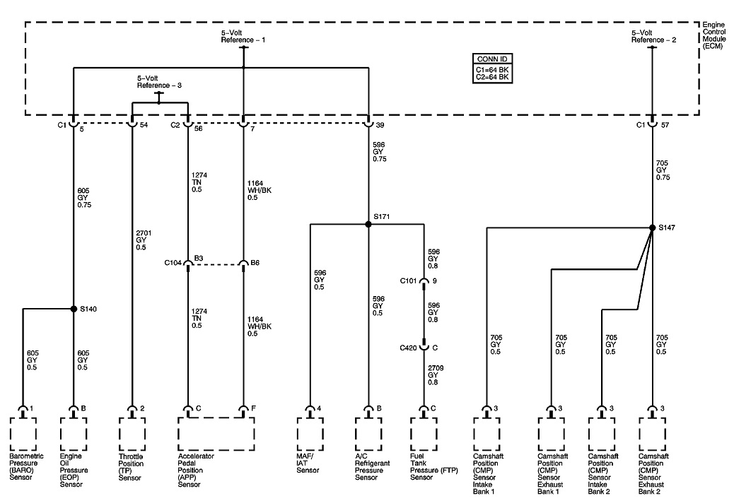

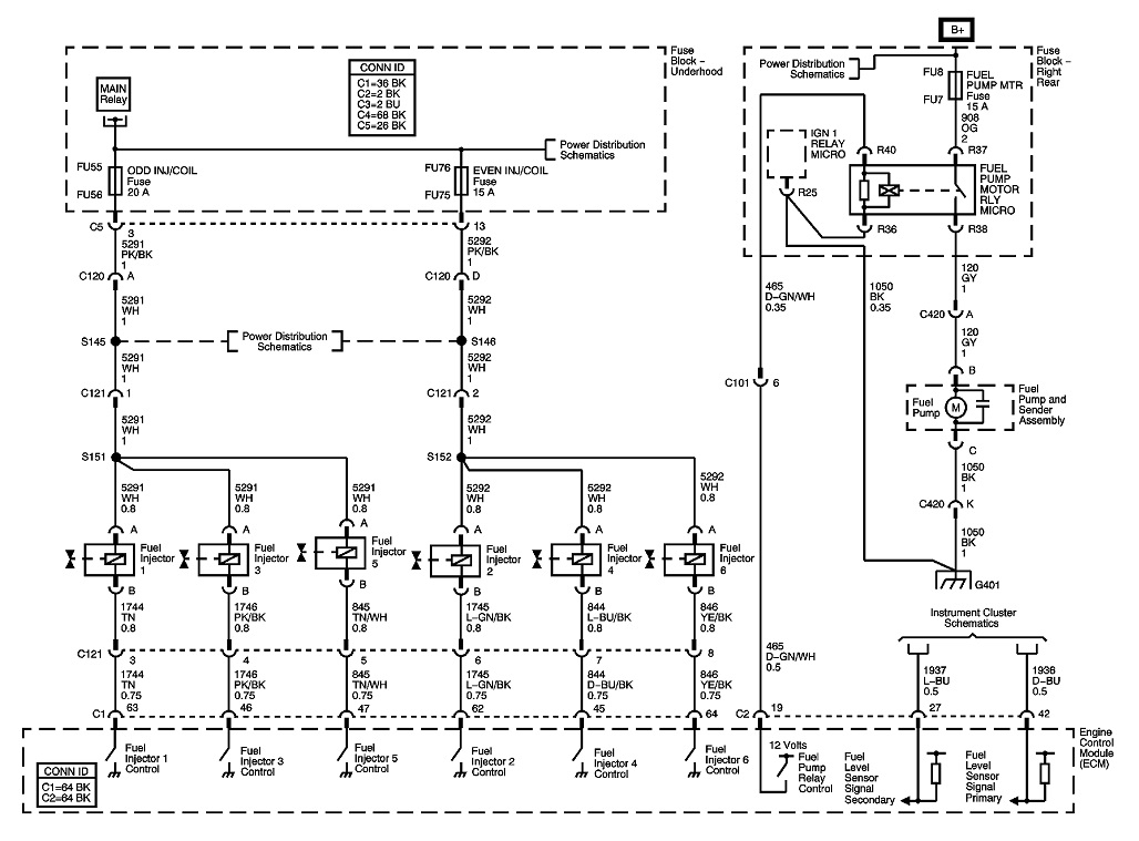

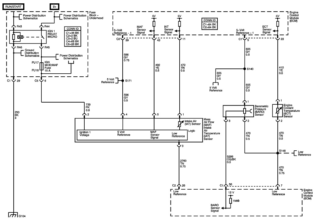

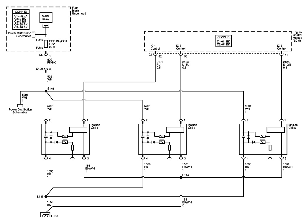

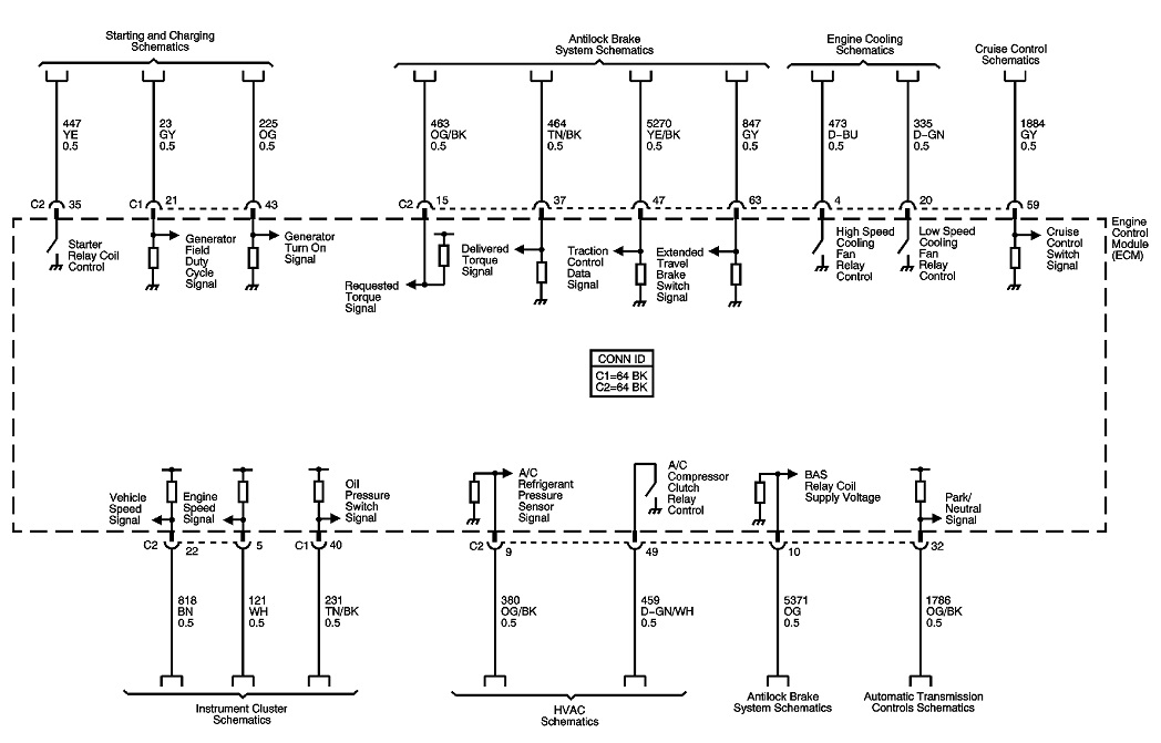

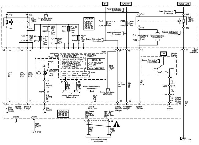

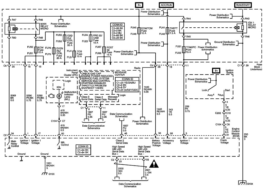

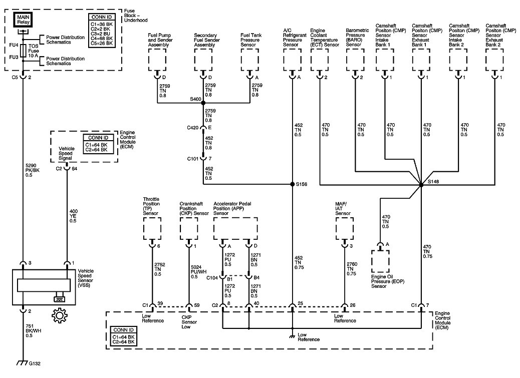

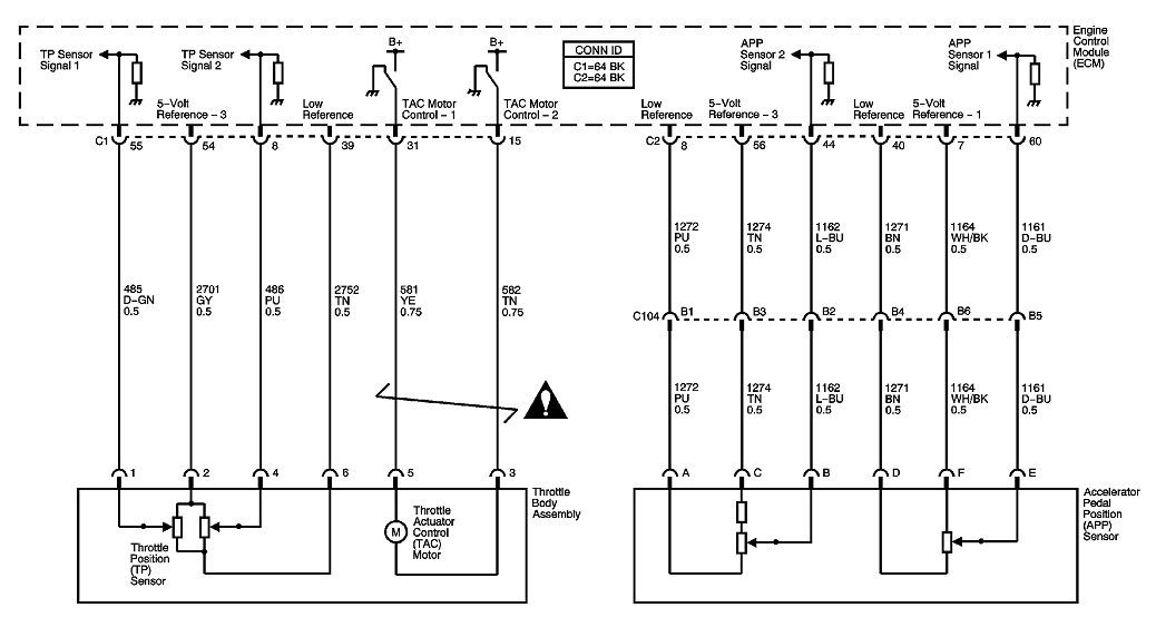

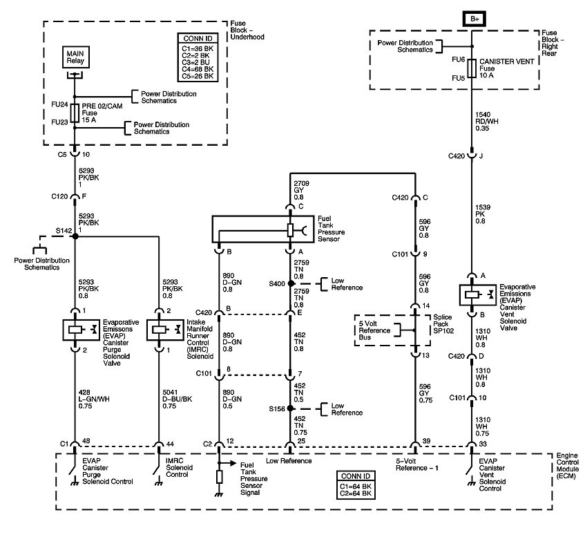

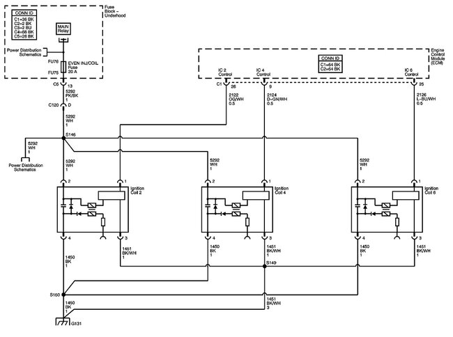

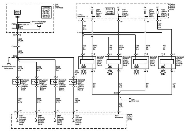

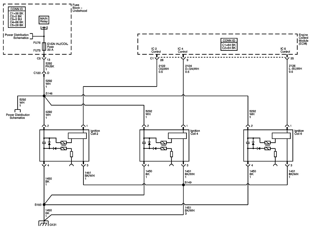

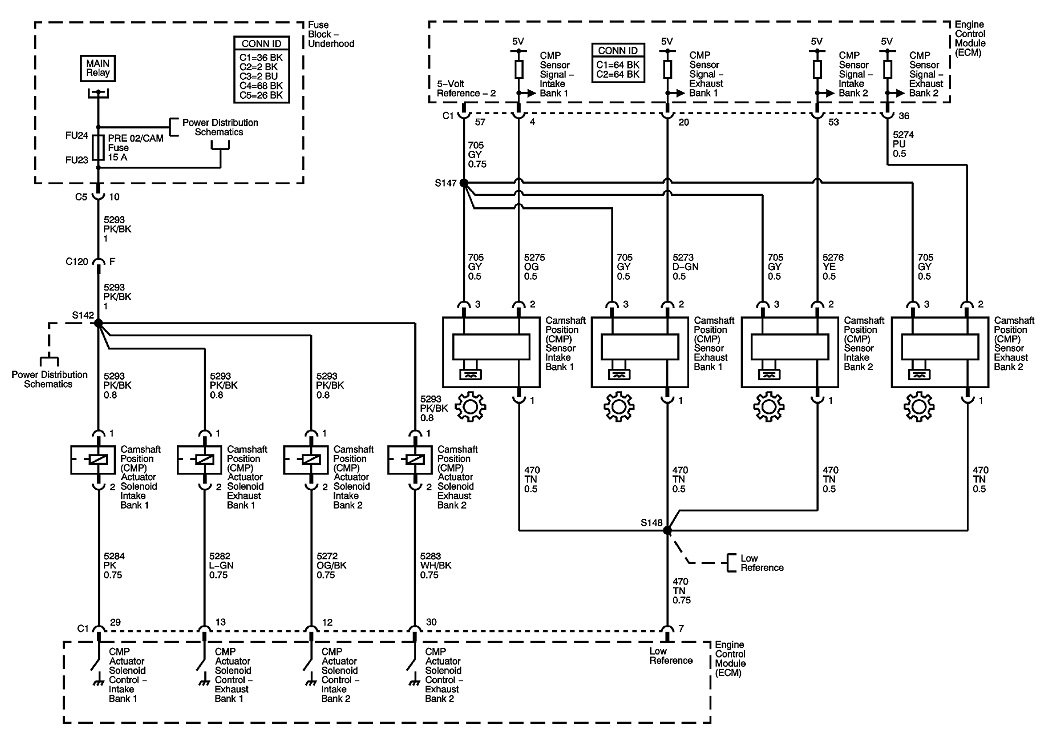

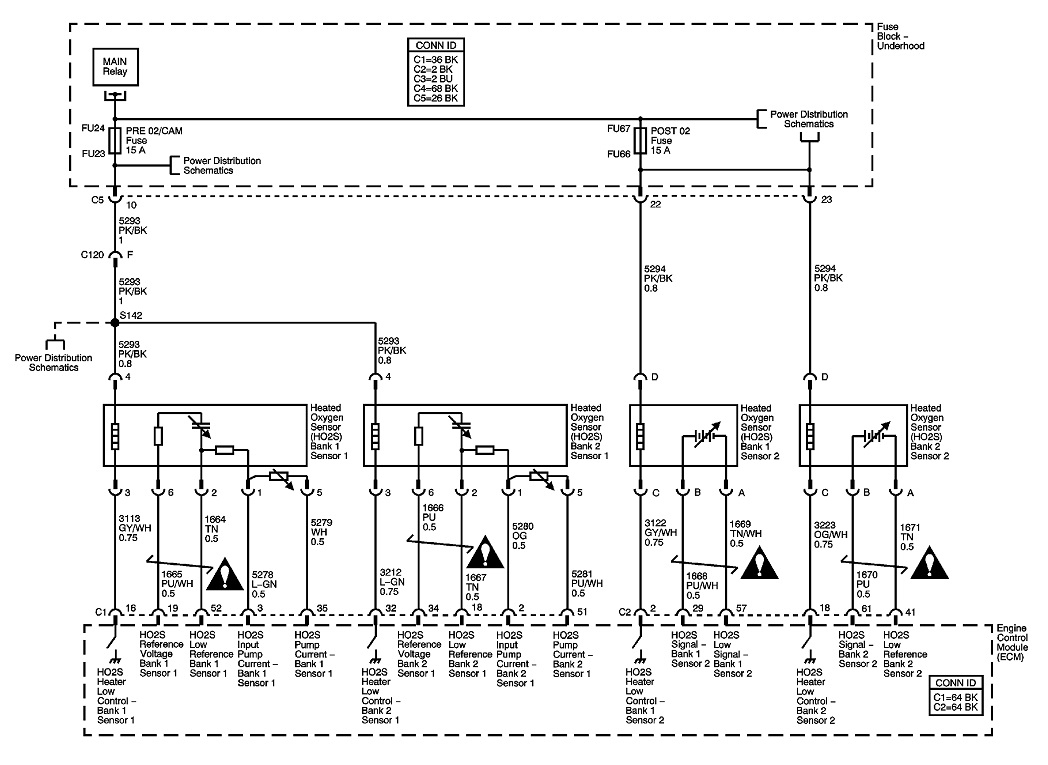

Since you've already worked your way to the crankshaft position sensor, I put these diagrams together for "Powertrain Management". See how far these get you. If they are too small to read, first try to copy one and paste it into a typing program such as MS Word where they can be expanded, otherwise let me know which ones you need and I'll cut them into pieces that I can expand for you.

I'm checking camshaft sensors and they seem to be very dirty.

Cam and crank sensors shouldn't be affected by oil or dirt, but they do have magnets inside them and rust or metal particles can stick to the end and interfere with the signals they develop. We rarely run into that, but we always include it in the discussion.
