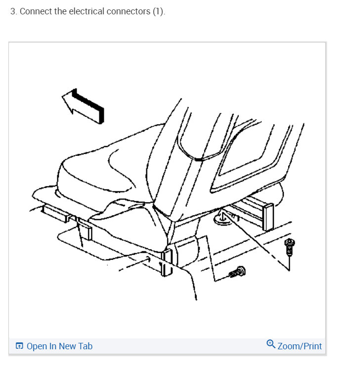

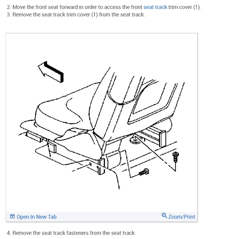

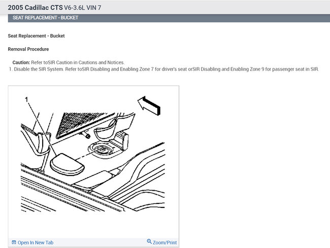

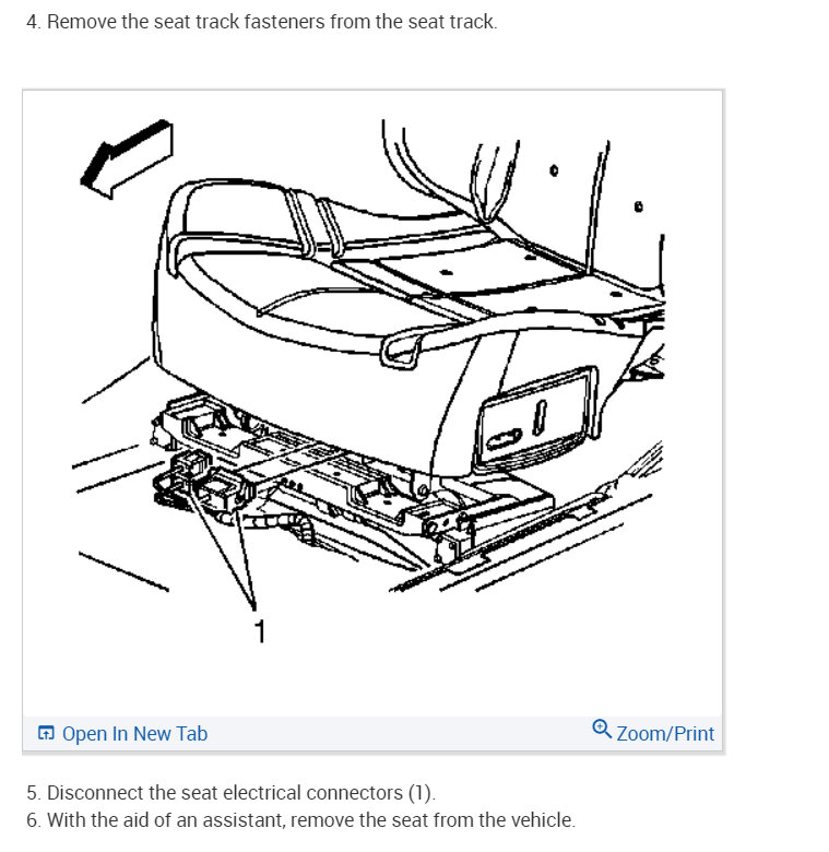

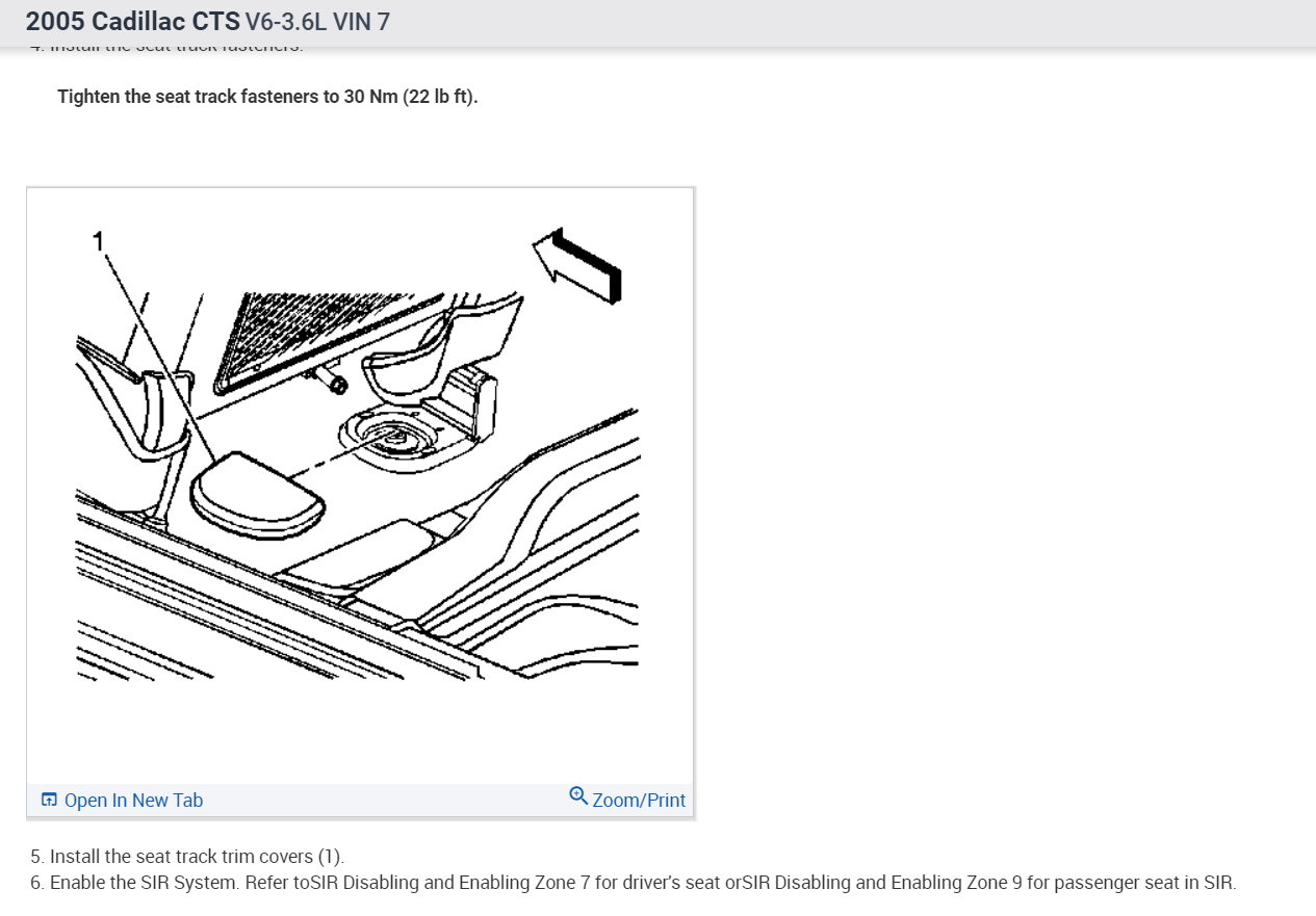

I need to remove front seats to clean ground connections and check electrical wires for damage from water leaks or heat from transmission or exhaust. i could use any advice you have for fixing all of these problems. thanks
Oct 18, 2022 at 1:45 AM
  • 55,732 POSTS

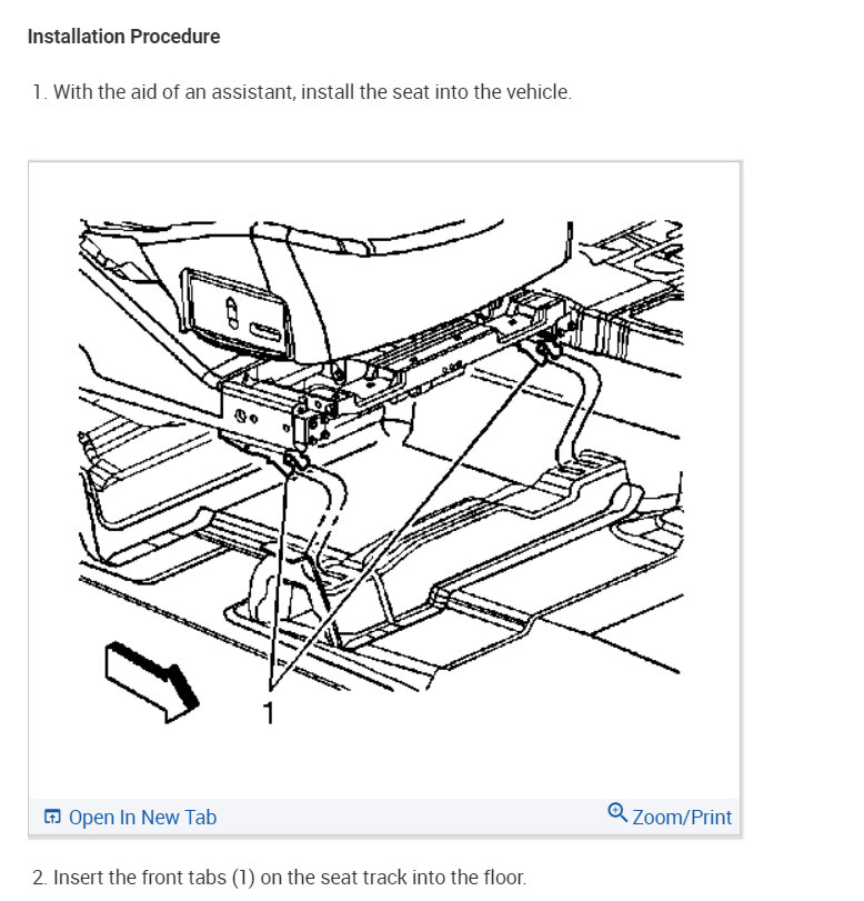

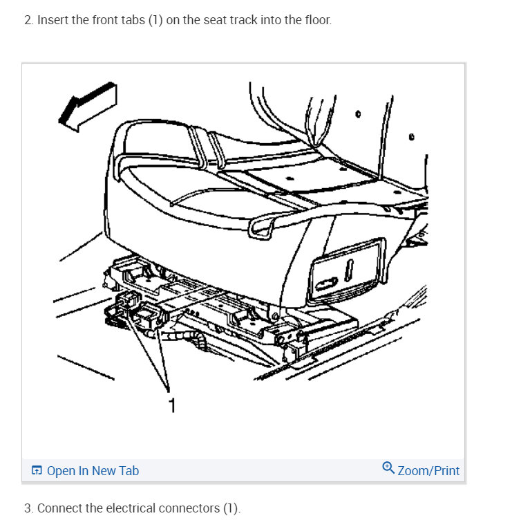

Here are the instructions on how to remove the front two seats, use a fan to dry out the car and remove the electrical connectors of the electronics to help let it dry out, but disconnect the battery first. Check out the images (below). Please let us know what happens.
