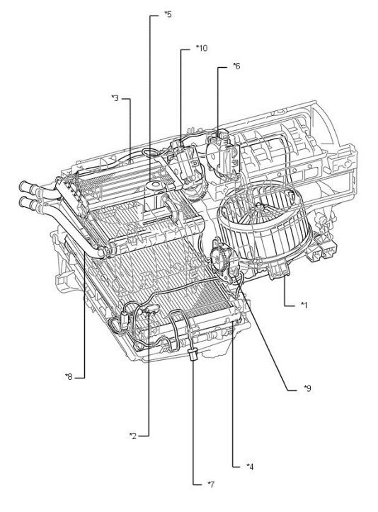

I recently took my Corolla into the shop because of a huge issue with my defrost, and I was told that the problem required putting in a new actuator (8710602220) or an entirely new assembly (8713002670). The price I was quoted for the repair was around $1200 and $1400, respectively. Does that sound reasonable? I have little knowledge with car repairs, but from what I could find on this website for similar repairs (https://www.2carpros.com/articles/replace-blend-door-motor) it doesn't seem like this job warrants 1000 dollars in labor costs. I would appreciate any advice, and a thank you to those who put in the time to run this website.

Well the breakdown works as follows: Book time (which is a statement of how much a mechanic should charge for the job) shows over 7 hours for the job. Combine that with the relatively lengthy procedure that Toyota has laid out for doing the job and yes, you could easily get into the 1,000's in labor costs.
Personally, I would suggest shopping the job around a bit. I'd bet you could find a smaller shop to do the job for 30% less. You can also poke around online and get the part for the job on your own, which will save you from paying the marked up price commonly known as "list price."
Hope this information clears things up for you.

What you're looking at there is the generic estimate of what a blend door actuator costs to replace. The job that Toyota is quoting is for the recirculation door actuator, which appears to be a more involved job. Also, sites like repair pal use numbers that aren't necessarily just from dealerships. Also, dealerships do tend to charge considerably more than small private shops.

Here is a tutorial we attach to our responses giving you an idea as to what is involved in a blend door actuator remove/replace.

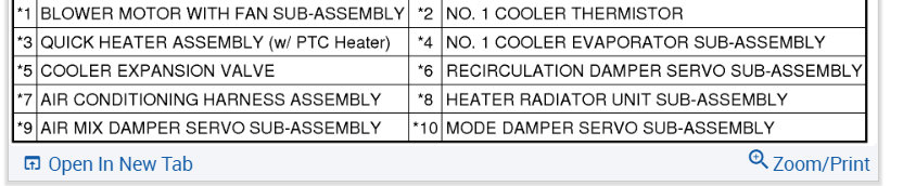

Here are diagrams to show the location of the blend door actuators. Check out the diagrams (Below). Please let us know what happens.
