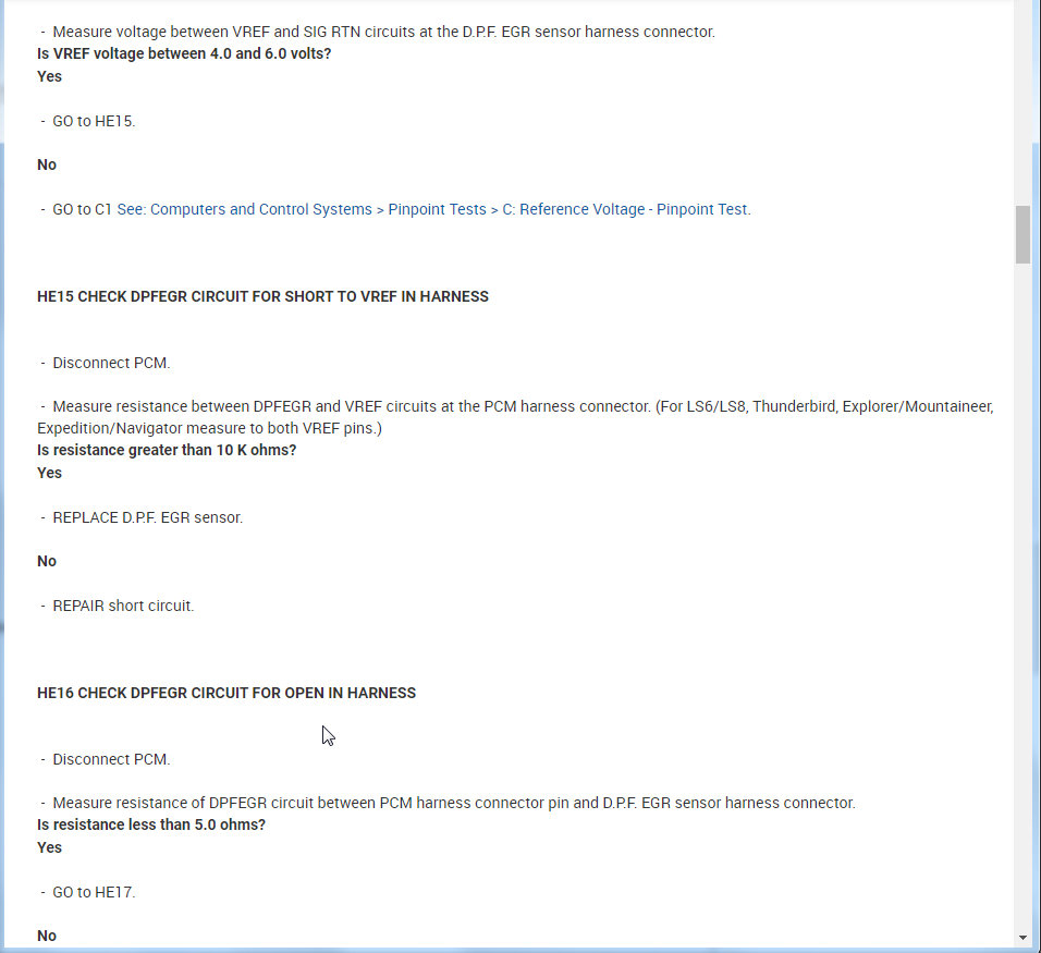

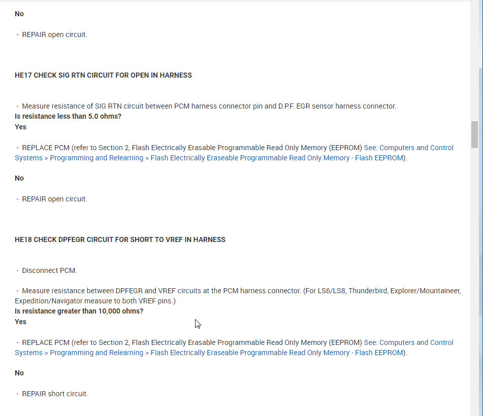

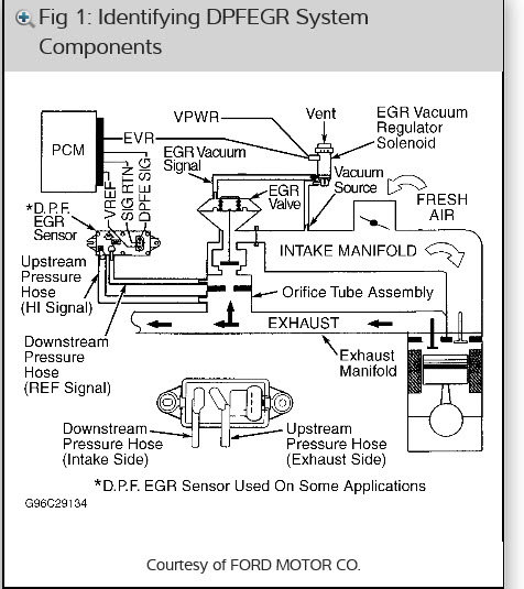

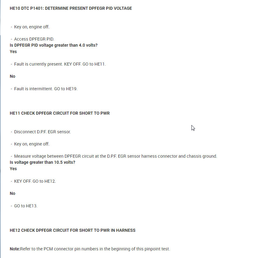

reads code p1401. when driving does not have any power.
Jun 13, 2016 at 7:30 AM
HMAC300
  • 48,601 POSTS

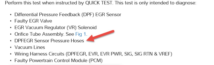

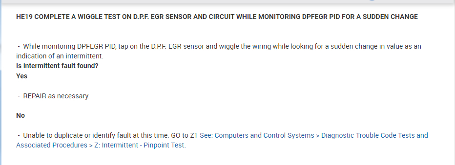

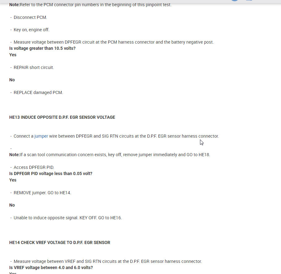

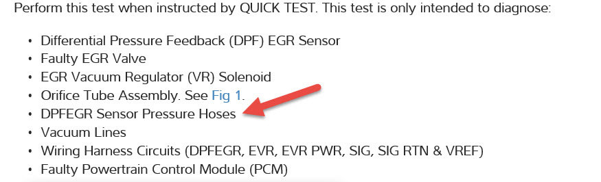

see pics this may be an EGR problem so you will need a vacuum pump like a mity vac and a voltmeter to test. also check for a vacuum leak.
Jun 13, 2016 at 8:21 AM

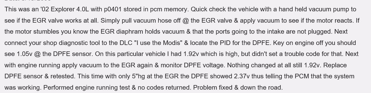

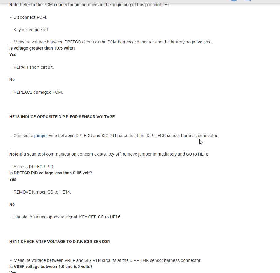

I am attaching the testing that we need to run through in order to figure out this testing.
Plus here is a guide that will help with figuring this out:
Lets run through this testing and go from there. Thanks
