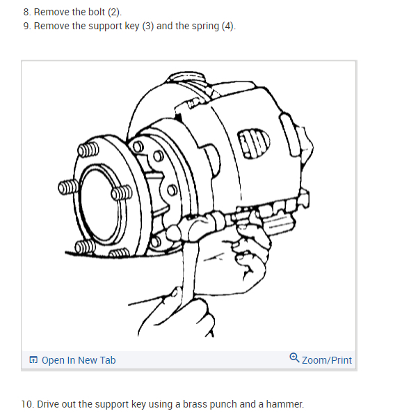

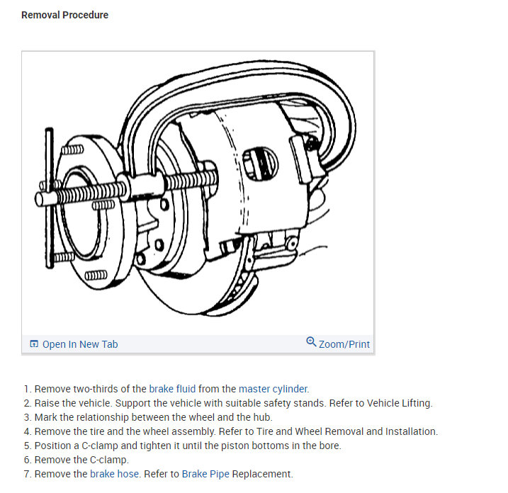

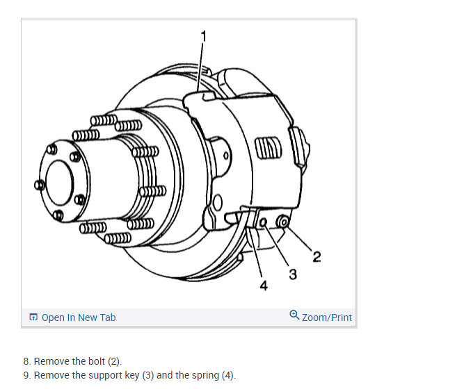

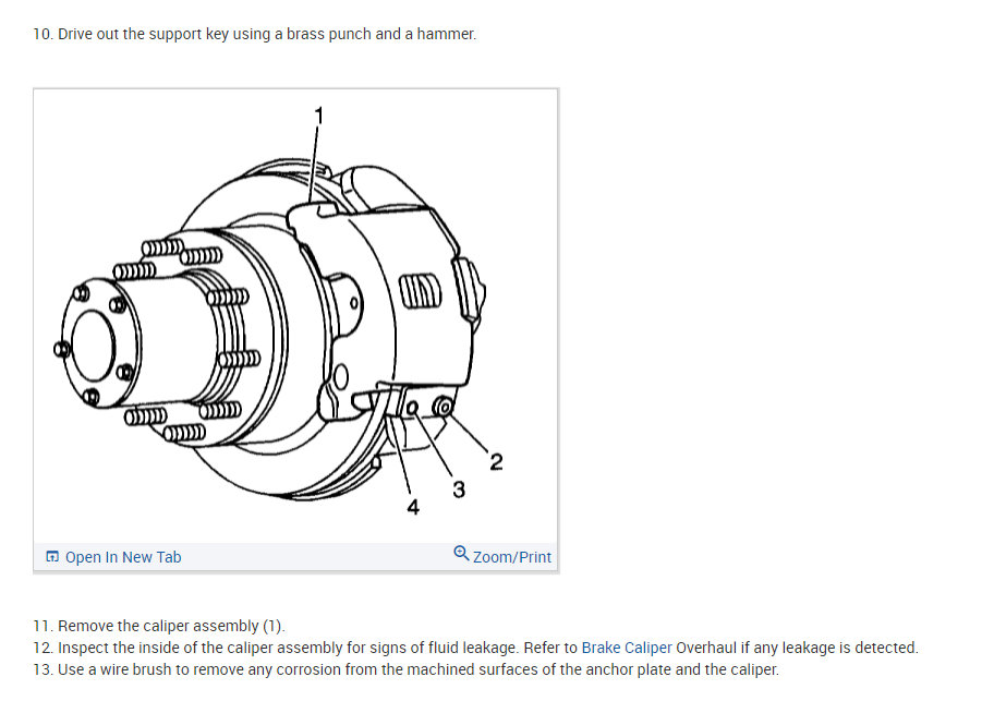

This sounds like the brakes on the rear wheel are locked up. Remove the wheel and open the bleeder and see if that releases the wheel.
https://www.2carpros.com/articles/brake-caliper-replacement
https://www.2carpros.com/articles/how-to-bleed-or-flush-a-car-brake-system

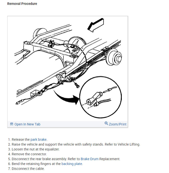

The parking brake cable could also be an issue if it is frozen in the applied position.

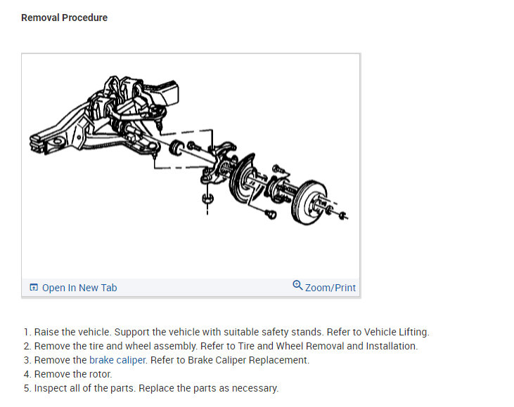

I attached pictures and procedures for the repairs for you below.
https://www.2carpros.com/articles/parking-brake-shoe-replacement
