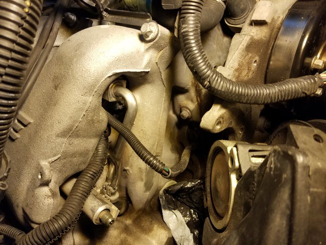

I'm trying to replace the camshaft position sensor, but it seems to be between the engine block and fuel injection system. Help!

Here's what it looks like:

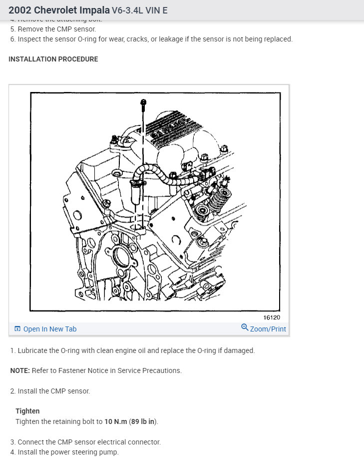

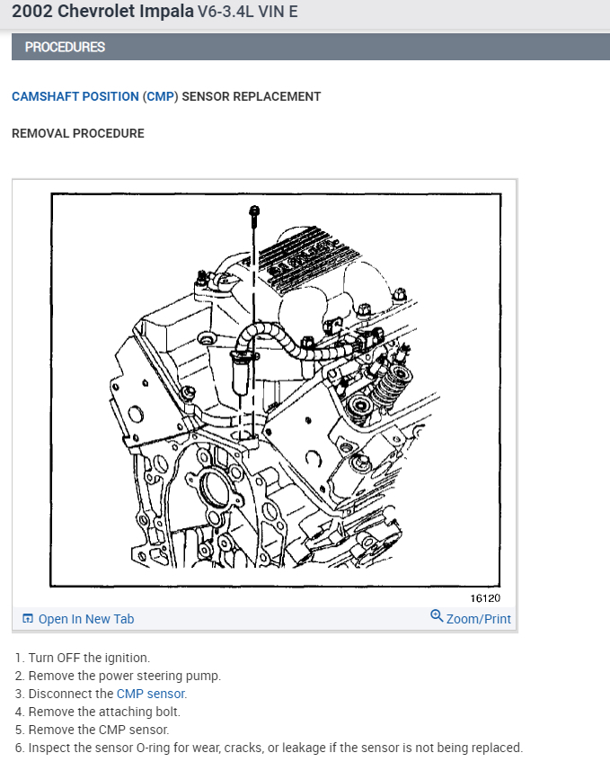

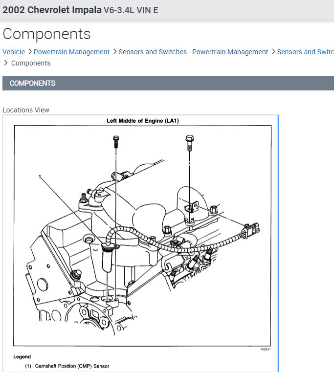

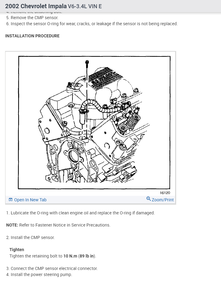

The Cam position sensor is located on the top part of the engine.
The replacement procedure does not call for removal of any other components.
https://www.2carpros.com/articles/camshaft-angle-sensor-replacement
See attached for the replacement procedure.
Let me know of any questions.

Did you see the attached photo that shows it between the fuel injector and the engine block?

Yes, but that is not the camshaft sensor, if you look at the diagrams Sean gave you can see where the sensor is.

It is the camshaft sensor. I had to remove the upper intake manifold to get to it because the previous owner must have put everything together wrong. It's fixed.

In the picture there are two wires going to different places, glad you got it fixed.
