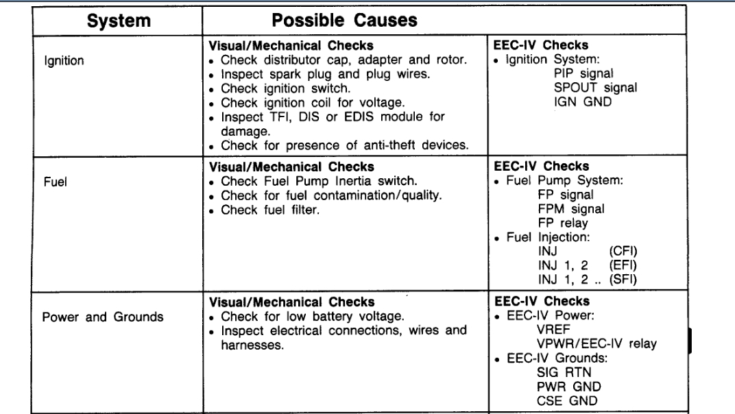

Engine will only idle for less than a couple of minutes before shutting off. I have narrowed it down to the spark ignition system shutting down. When driving it jerks and bucks violently when you try to accelerate. Driving or idling the ignition system has a dead miss on all cylinders. I have replaced the entire ignition system, checked the timing, replaced every sensor, fuel filter and the fuel pump. I’ve ran the codes and it shows 18 and 33. I’m down to inspecting the wiring harness by individual wire. What could it be?

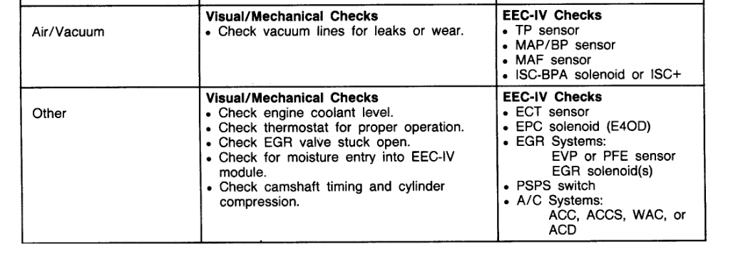

SCGRANTURISMO
  • 4,897 POSTS
Hello again,
Okay, sounds good. In the mean time in the diagrams down below I have included the list for possible problems for your vehicle stalling from the vehicle manufacturer. Please go over this list and it might give you a different way to go if the ignition system fix doesn't do it. Please let us know how turn out.
Thanks,
Alex
