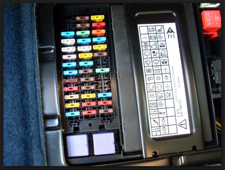

Hello.
Please can you help, the hazards on my Renault Clio (1.2, 16v, 03 reg, 3 door 'Billabong' model, 48,000 miles Clio) are not working. The indicator lights do work, and the hazards have worked once. I am not sure if it is a connection problem with the hazard swich or the fuse? (I do not know where the fuse is located or the wires from the back of the hazard switch). I have my MOT due next month so appreciate any advice you can give so I can solve this problem before then so as not to fail.
Many thanks.

Since the other lights work for the car I would have to say the switch is bad. Try this cycle the switch many times. This will help clean the contacts and help the switch work again. Since this switch is not used very often this is common problem.
Here is a guide to help you get the fuses checked as well.

Because the indicators work, the hazard switch is the likely fault. Cycle the switch repeatedly to clean its contacts, and also check the related fuse.
Conversation Summary
The owner of a 2003 Renault Clio reports that the hazard lights do not work, although the indicators do and the hazards worked once. They suspect the hazard switch connection or a fuse and need the car ready for an upcoming MOT. The expert says the switch is likely bad, recommends cycling it many times to clean the contacts, and also advises checking the fuses.
