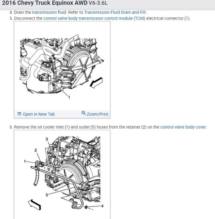

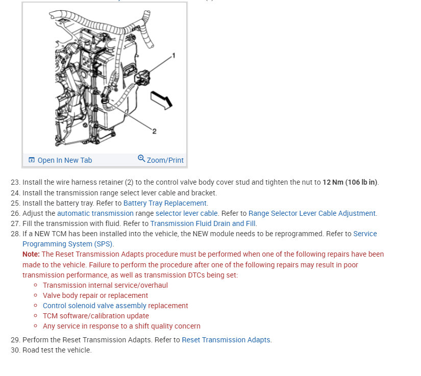

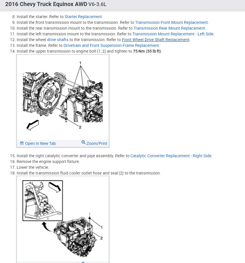

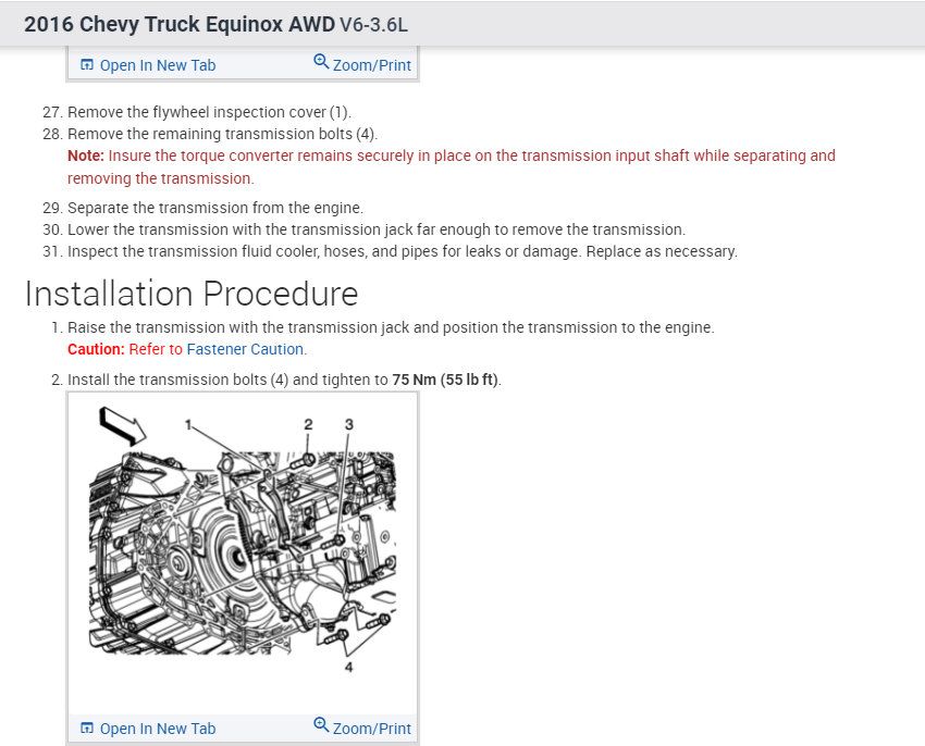

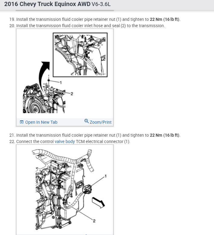

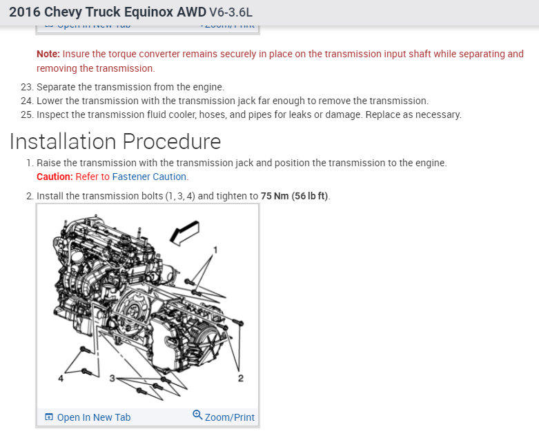

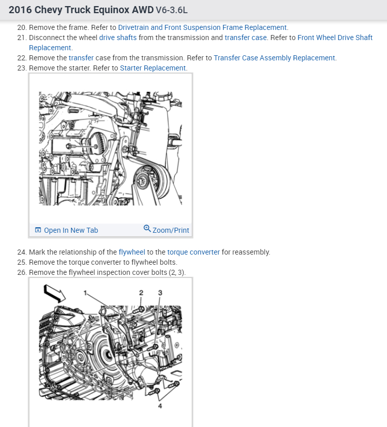

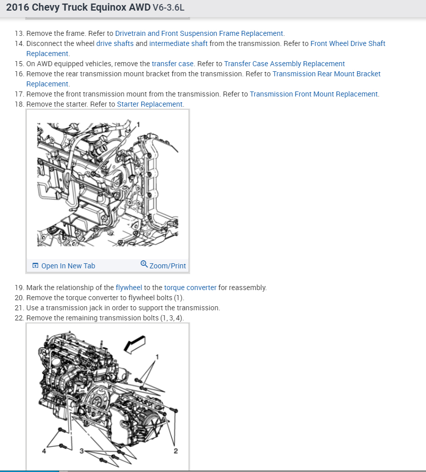

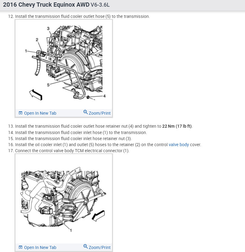

I'm looking for instructions on how to remove the transmission. I would prefer to do it through the bottom.
Nov 9, 2021 at 4:31 AM
SQM
Experienced Mechanic
6,383 POSTS

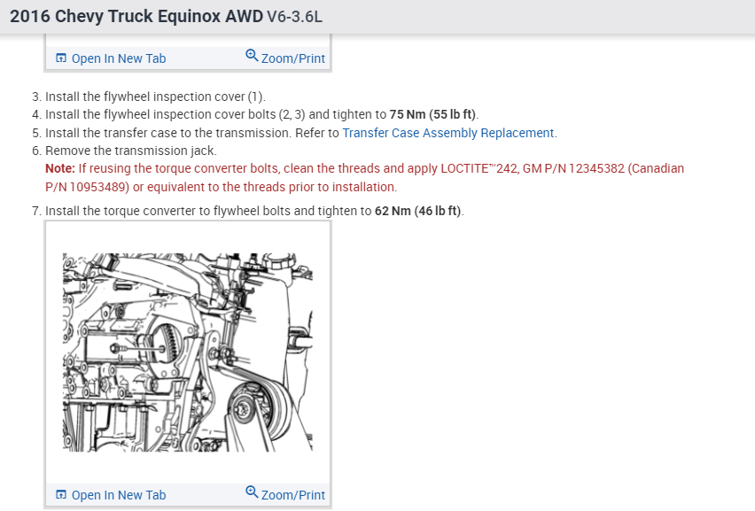

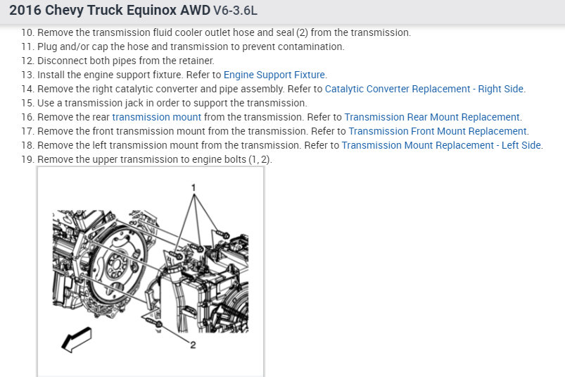

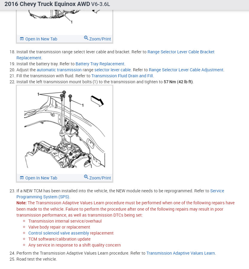

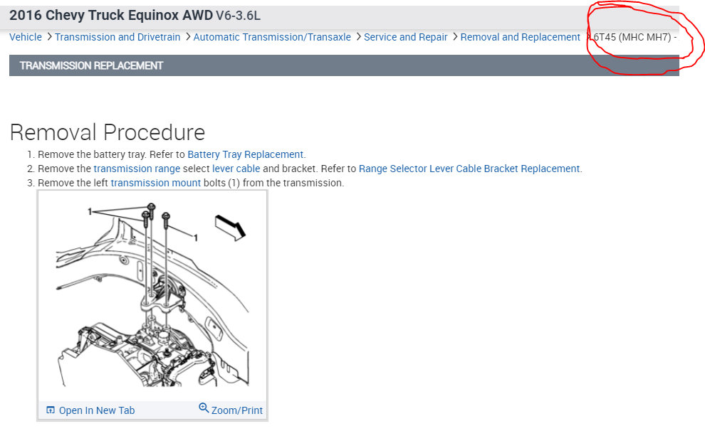

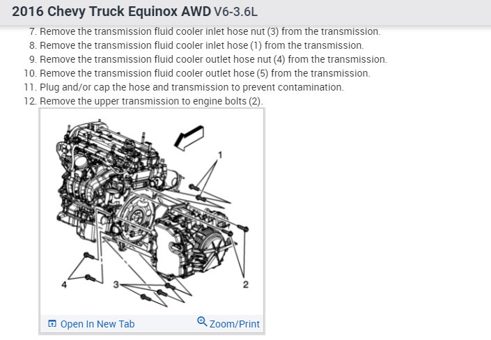

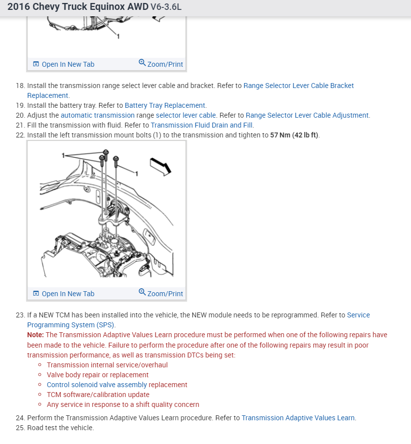

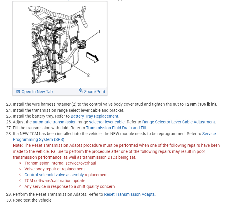

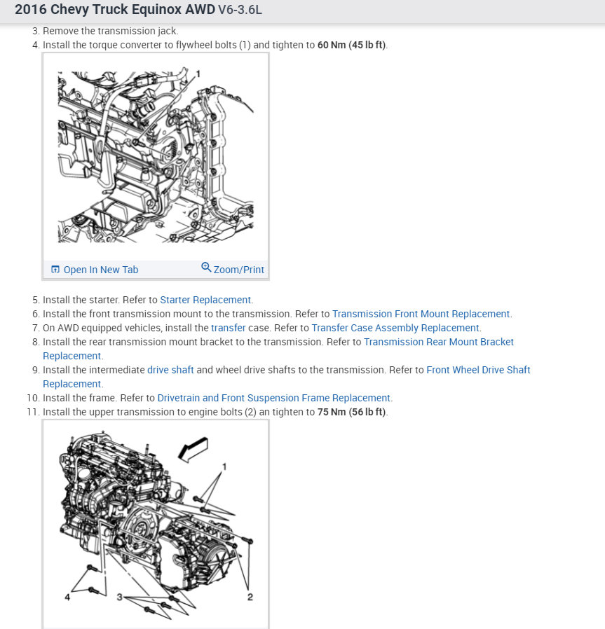

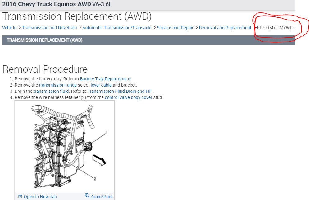

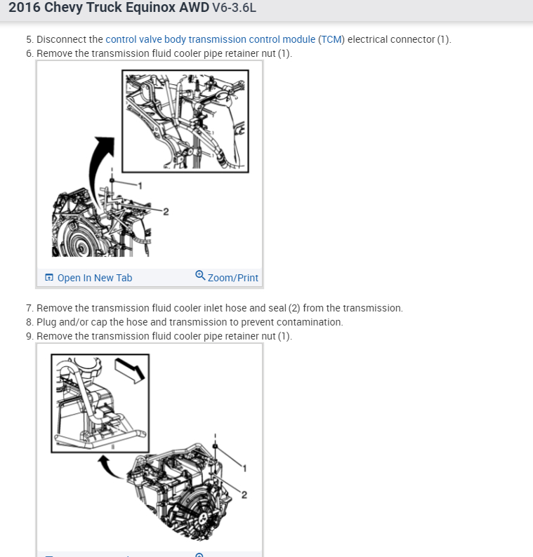

There are two different types of transmission that the Equinox came with.
6T45 (MHC MH7) - Automatic Transmission
6T70 (M7U M7W) - Automatic Transmission
I have attached the replacement procedures for both below.
https://www.2carpros.com/articles/how-to-remove-an-automatic-transmission-rwd
