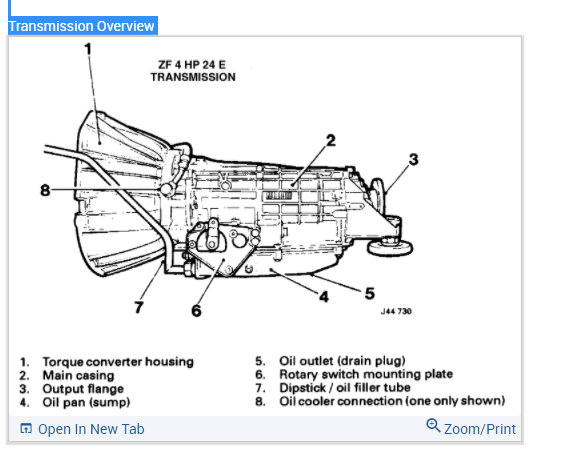

Having to replace my transmission. What's the easiest way and what tools will I need?

Hello.
The following link should supply all the information you need, Please post back with any questions you may have along the way.
https://www.2carpros.com/articles/transmission-replacement-removal-manual
You may find this video helpful, it is not your exact vehicle but the principles are the same for most vehicle.. the 2 top transmission to engine bolts are the hardest but are removed in the same way the video describes..

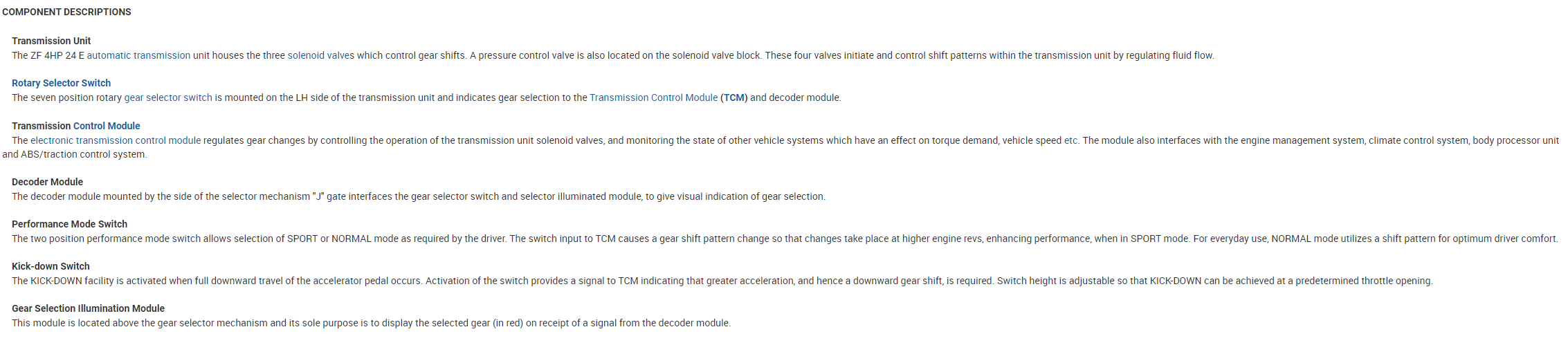

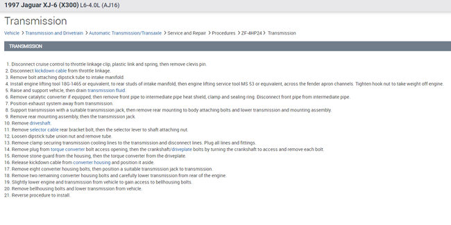

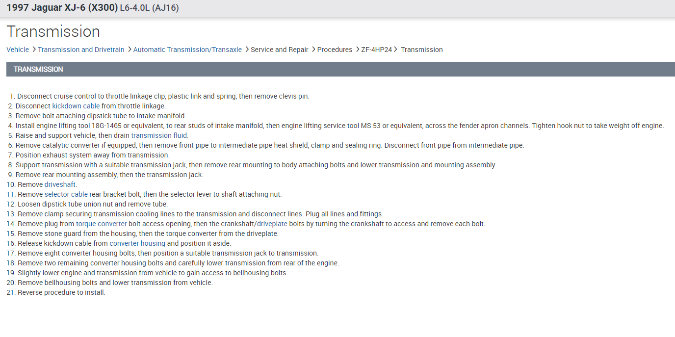

Hello.
Attached are the actual removal procedures, hope this helps.

how do you get to the 3 top bolts that release the motor from the transmission. i am replacing engine but did not want to pull tranny. do you have to remove both together then separate or is there a secret jaguar trick. thanks, bill
Mar 10, 2021 at 11:01 AM (Merged)
MHPAUTOS
  • 31,937 POSTS
Hi there,
If you remove the tail shaft, cross member and selector, you can drop the back of the trans down enough to access the 3 top bolts with a long extension.
