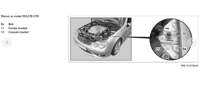

I recently bought the Mercedes' Benz off of someone and the fender is busted up. So, I bought a new one and I want to install it myself. I want to know how could I remove the passenger side fender to install a new one? I enclosed a photo.
Jul 4, 2022 at 8:56 AM
SQM
  • 6,383 POSTS

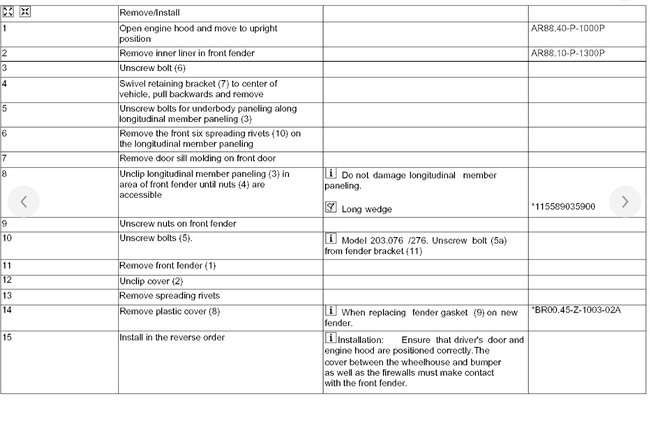

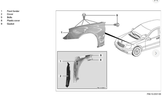

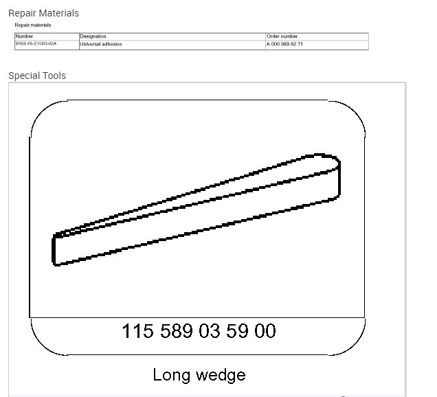

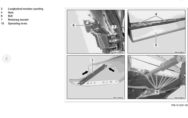

See attached for the front fender replacement procedures.
Let me know of any questions.
