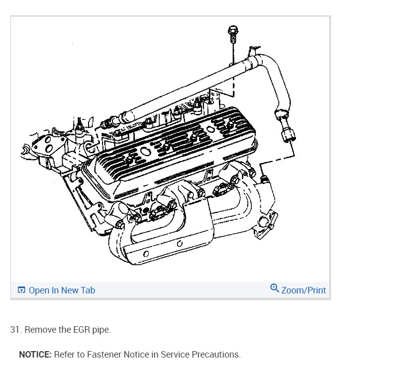

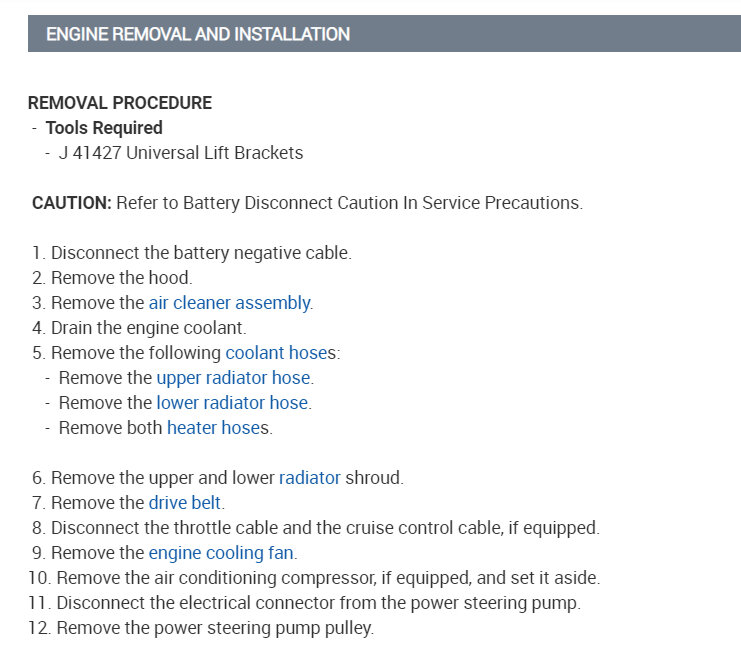

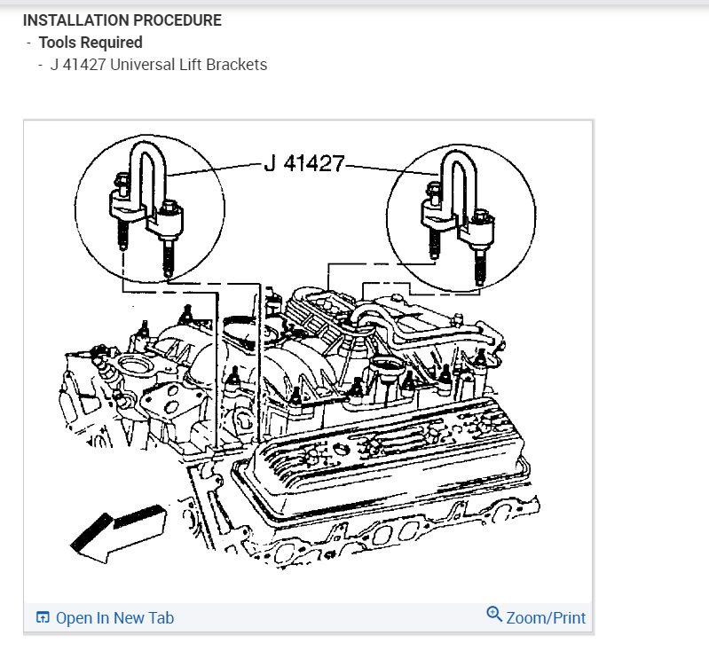

My engine has rust from being by the ocean. i need to de-rust it, do i need to drain the fluids? i also need either a good video that has step by step instructions or one with pics. Everyone tells me to buy a new engine but i can't afford it. Is it worth all the trouble?? i believe so. So, can you please help me with this issue? I'd greatly appreciate it. I'm a female and i would love to prove to these idiotic men that i can do this. Thank you for your help.

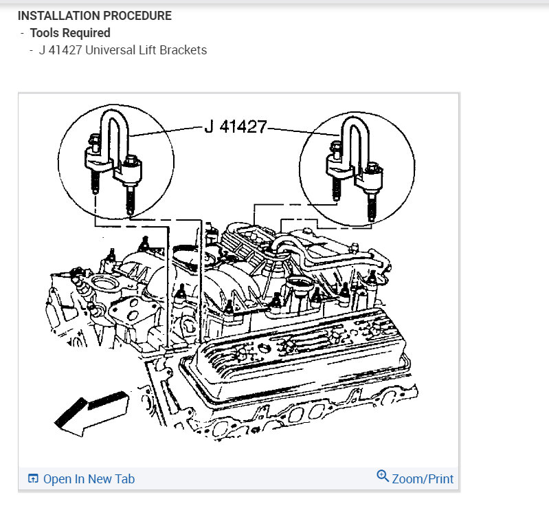

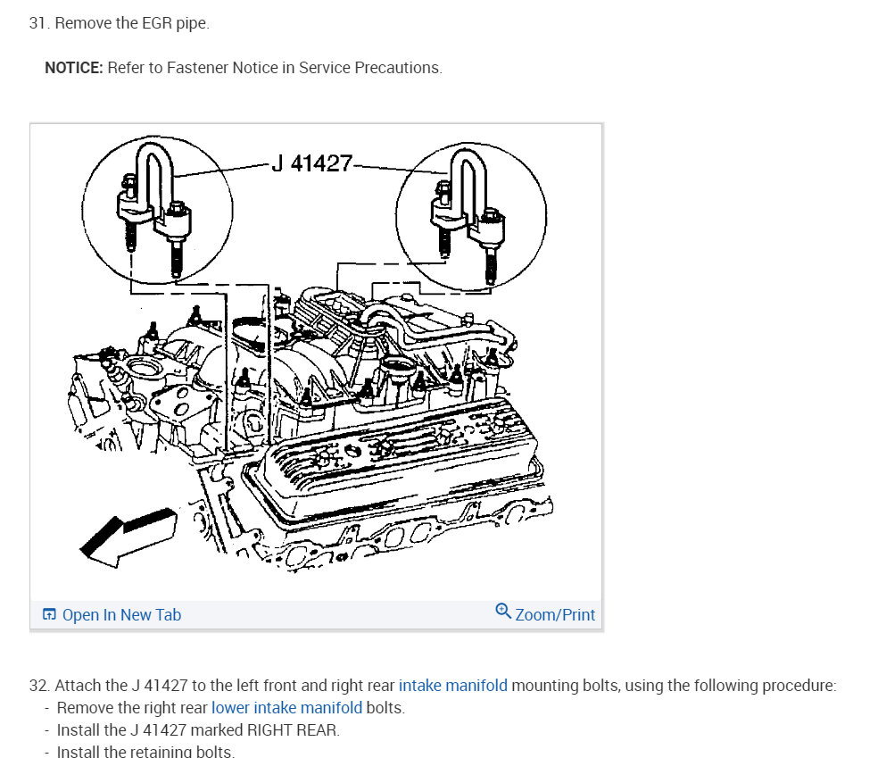

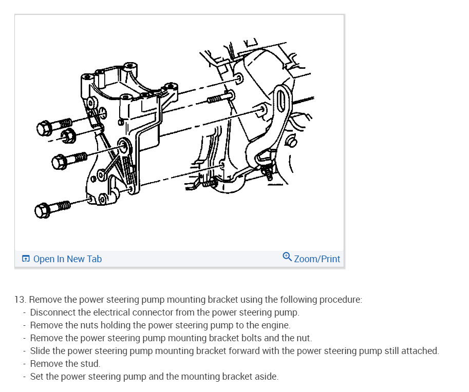

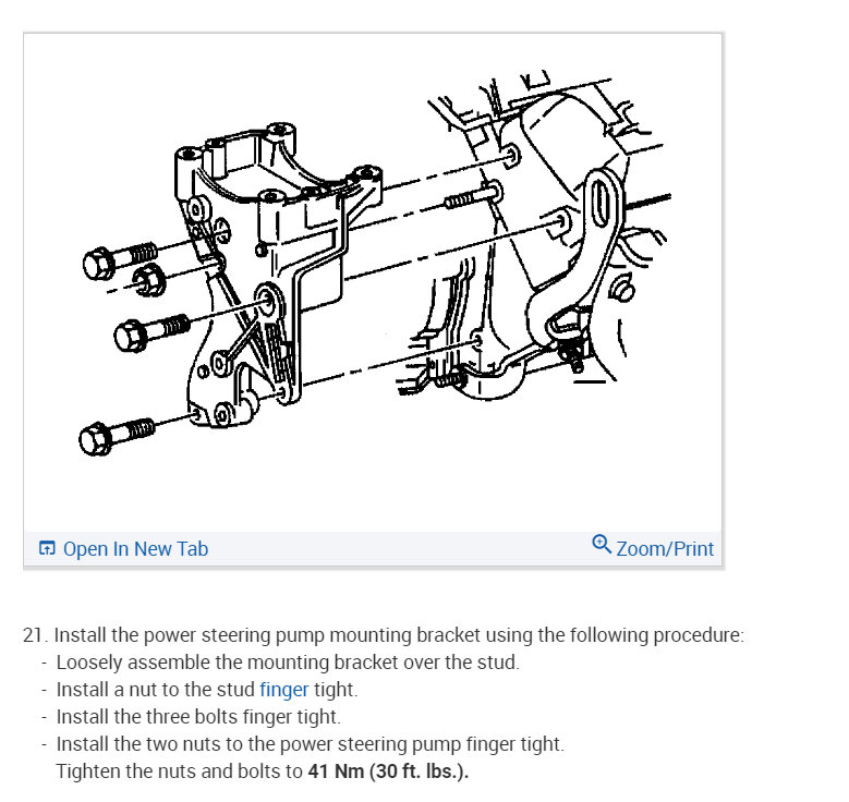

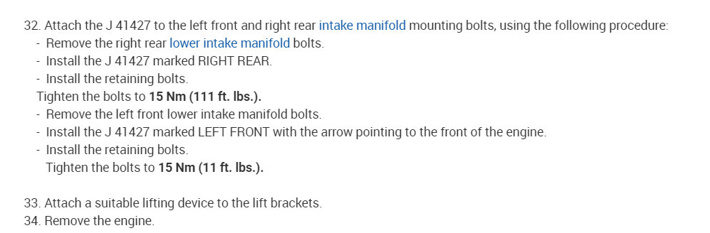

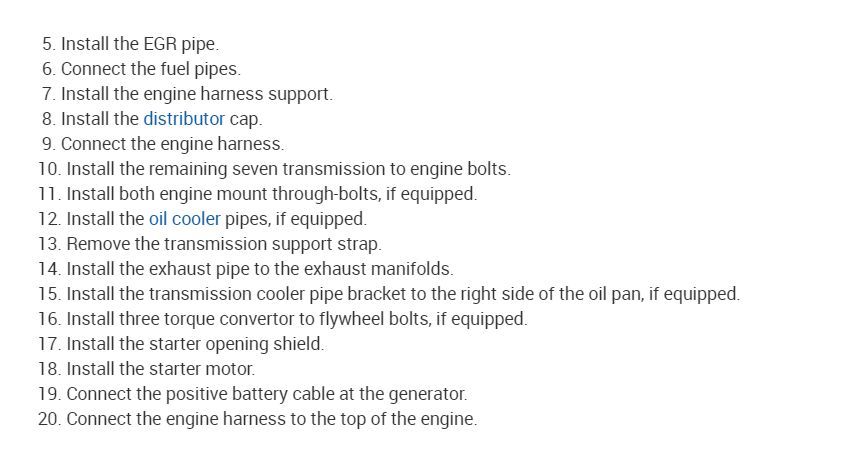

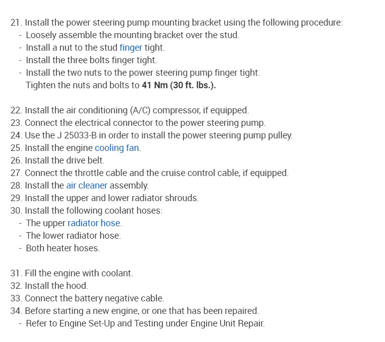

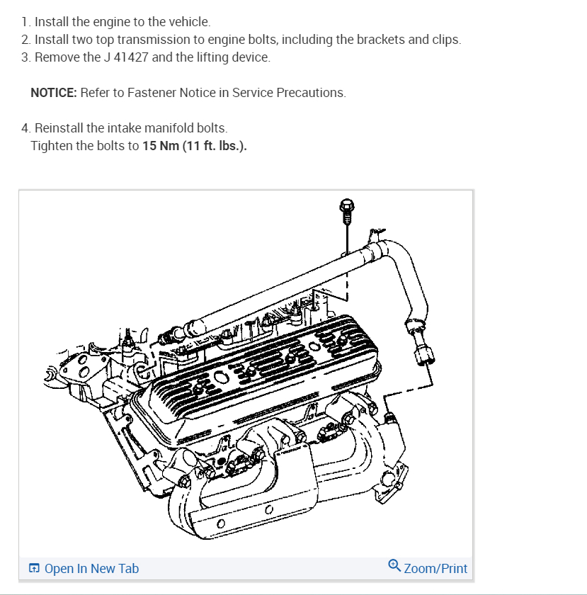

Yep, you can do it and we will help. To start, disconnect the battery and drain the radiator and engine oil. Here is a video of the job being done on a similar vehicle, the process is the same and I have included instructions for your truck in the images below.
https://youtu.be/zy1CozLgWUQ
Check out the images (below). Please let us know if you need anything else to get the problem fixed.
