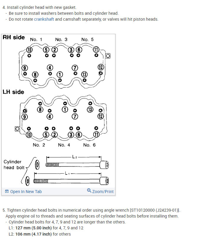

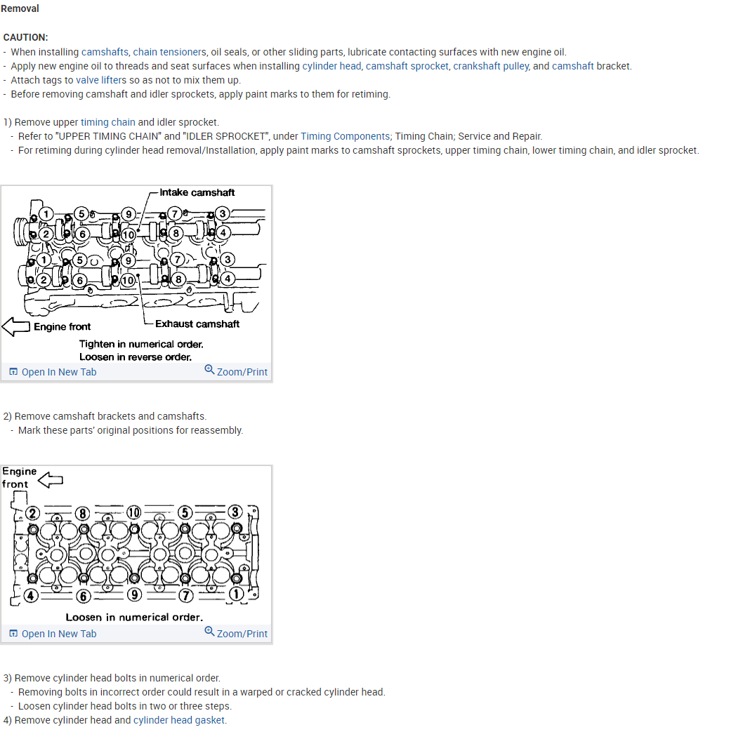

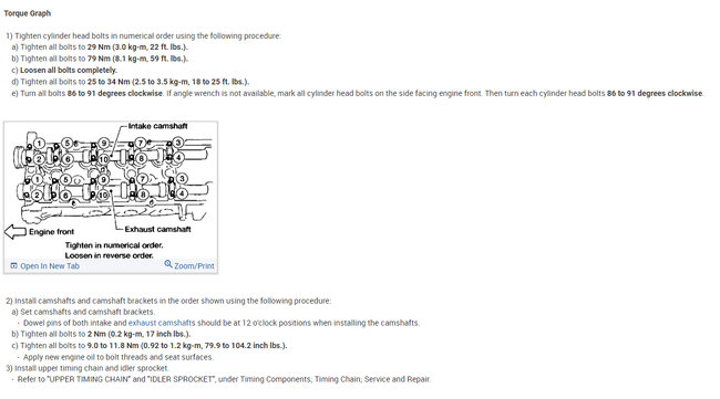

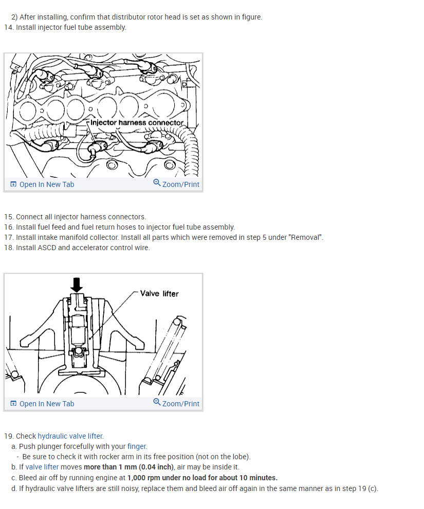

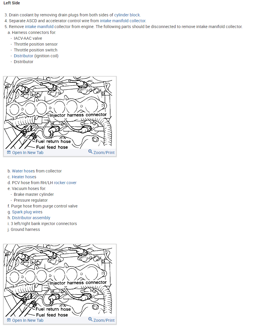

Removing the cylinder head and timing chain and replace any bent valves instructions needed
BONESMIKE
  • 2001 NISSAN FRONTIER
  • 2.4L
  • 4 CYL
  • 2WD
  • 199,001 MILES
Need any help. I can get to remove this dual cam head and timing the new chain and any special way to treat the cams? Any downloads would help. Have done head jobs before just not on the truck listed above truck with dual cams. This is a new head and chain ran good for 2 months then shut down, chain link broke? Engine turns over by hand easy. So any help is grateful Mike.

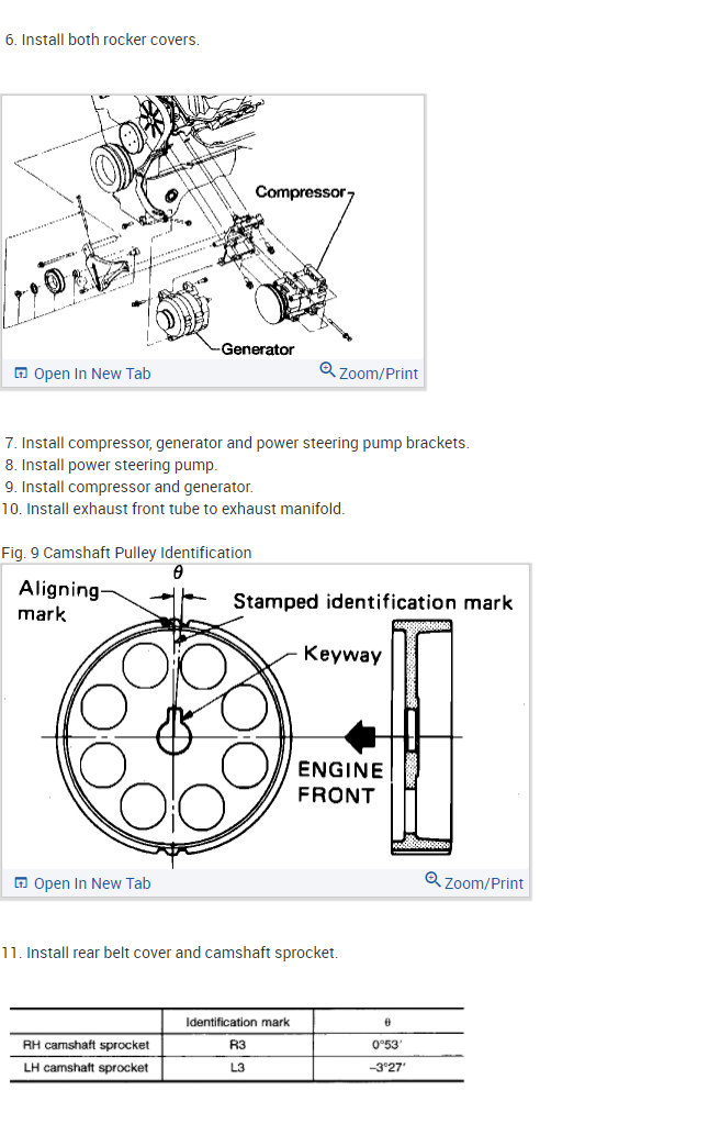

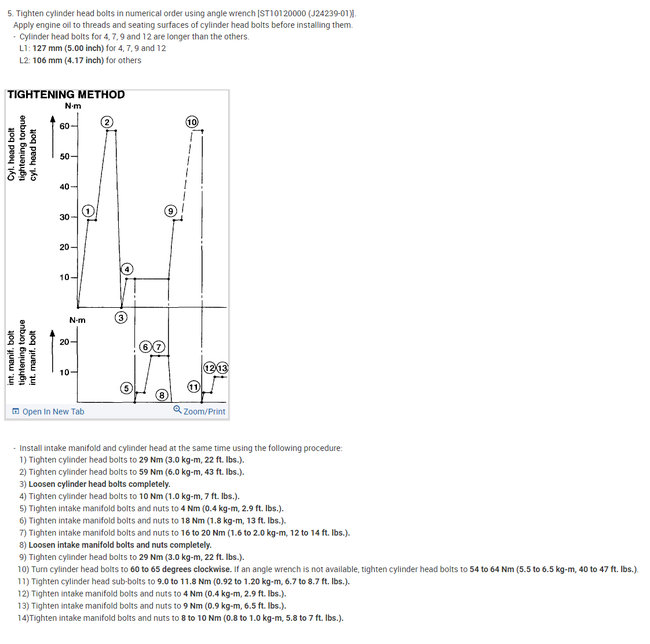

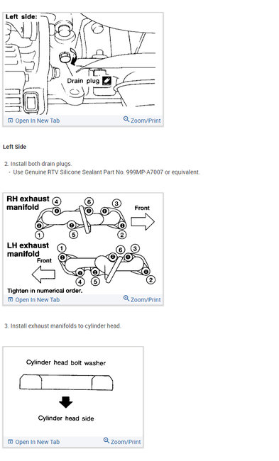

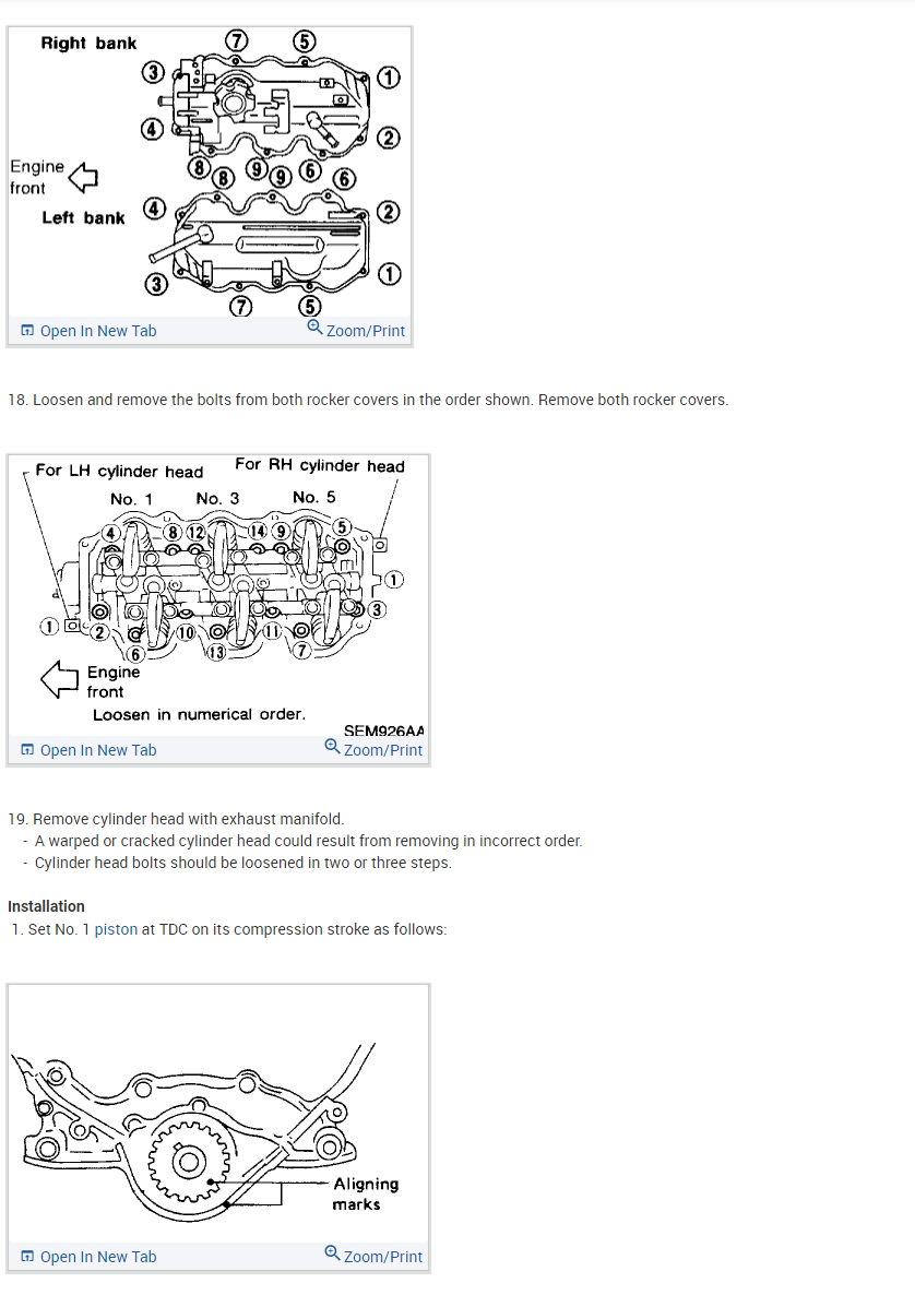

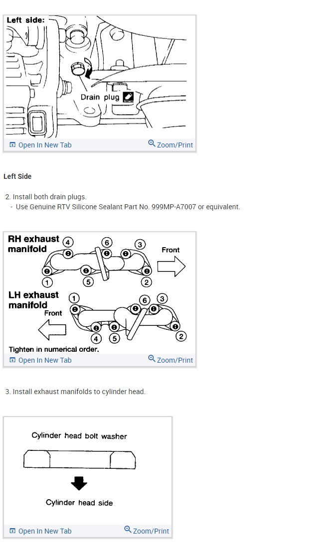

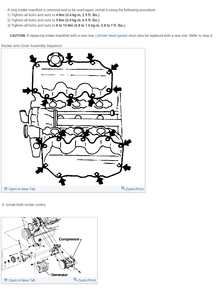

I have attached diagrams of the step by step instructions. Some of the diagrams overlap to aid reading.
Hope this helps with your repair, Please keep us updated on your repair outcome and do not hesitate to contact us again for further information or assistance.
Thanks for using 2CarPros.
Dave H

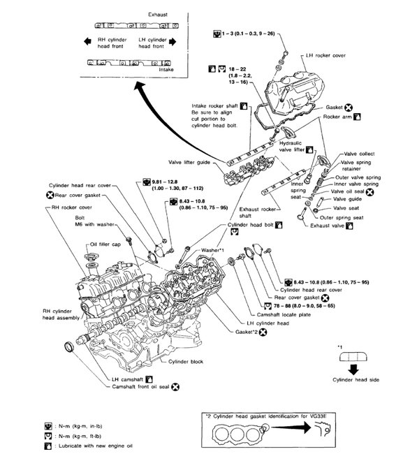

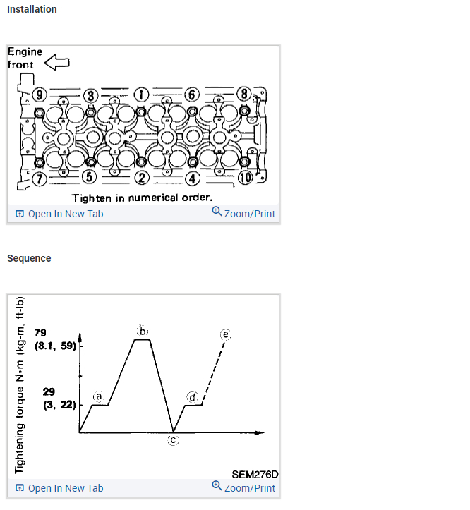

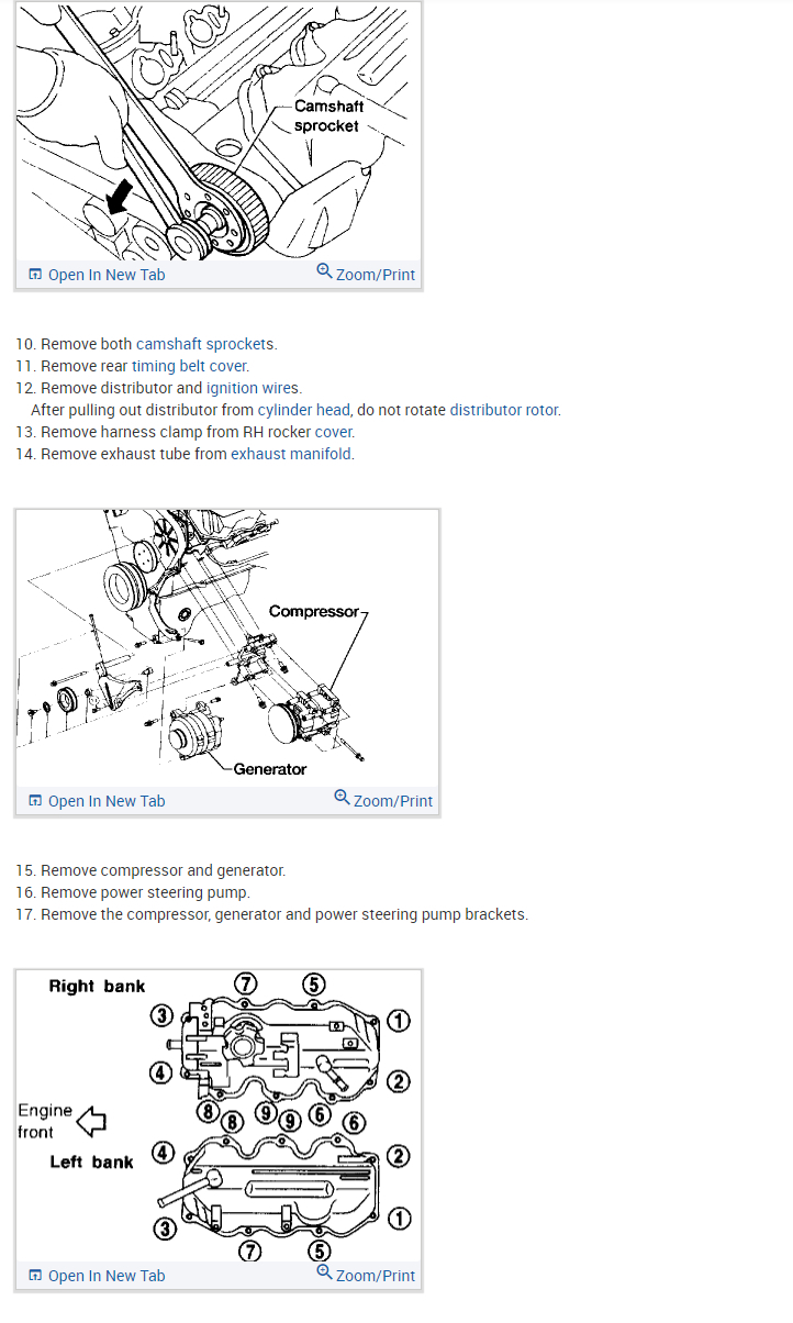

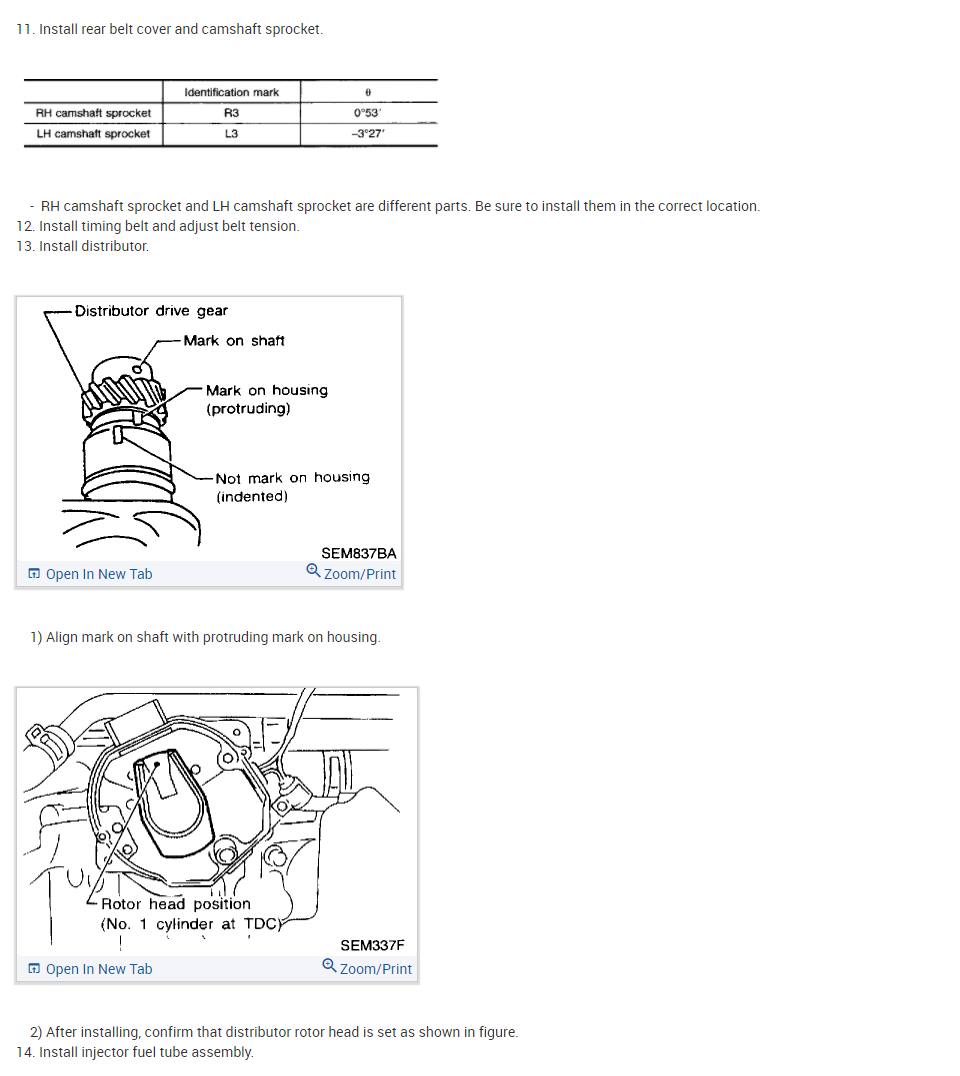

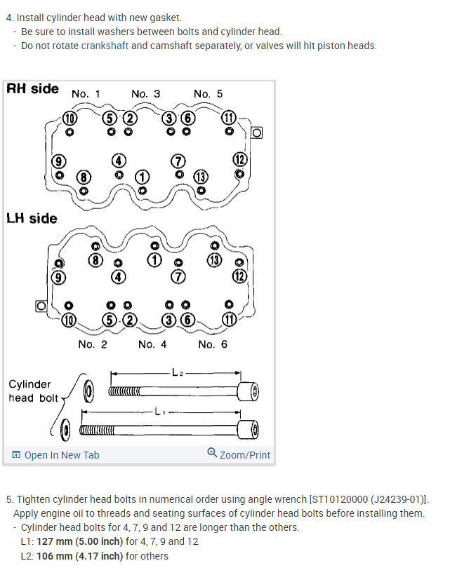

David, thank you, but my truck is a 4 cylinder with dual cams 2.4 Liter 2001 Frontier.
Sunday, March 7th, 2021 AT 3:51 PM

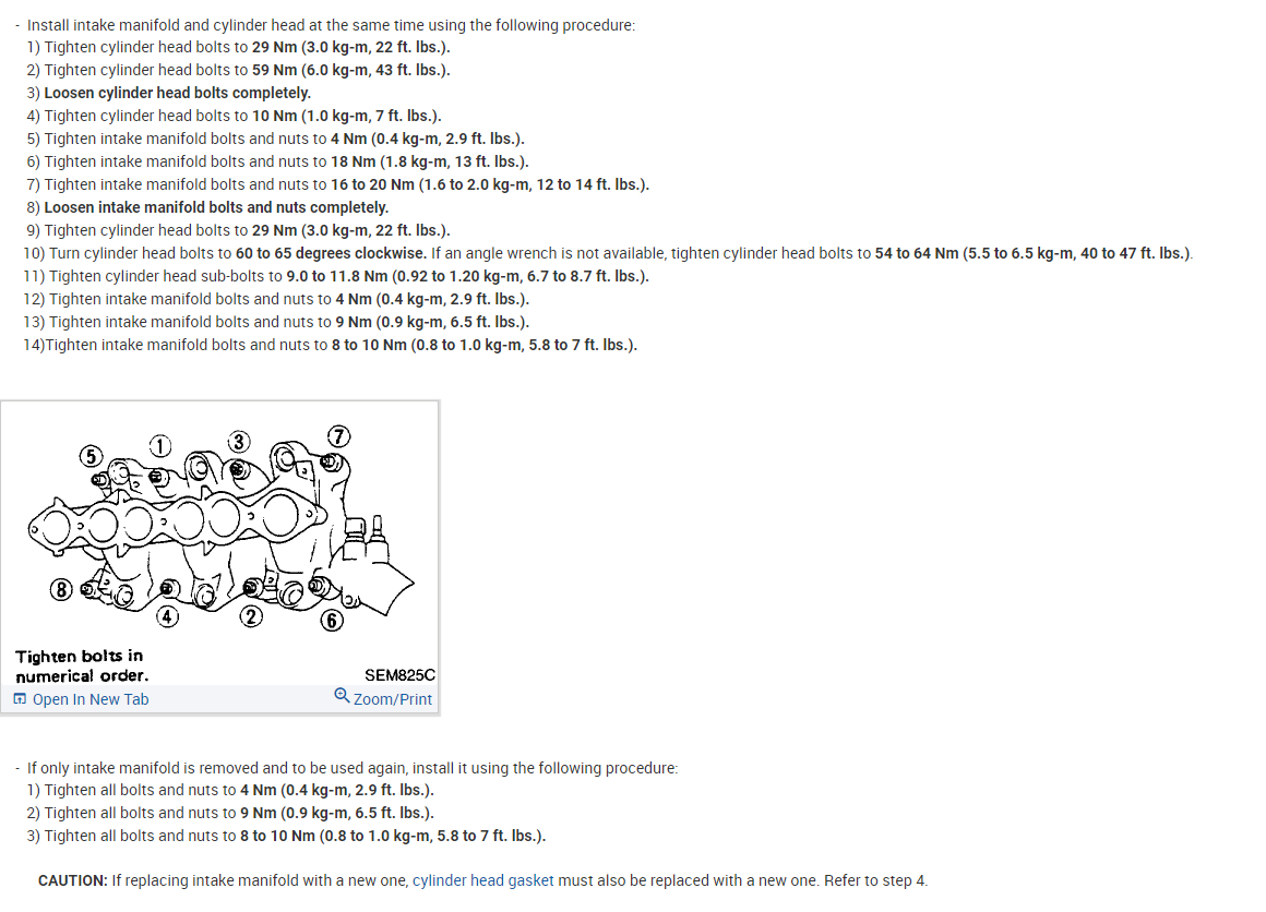

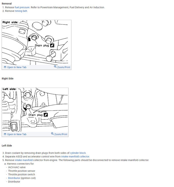

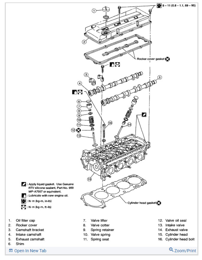

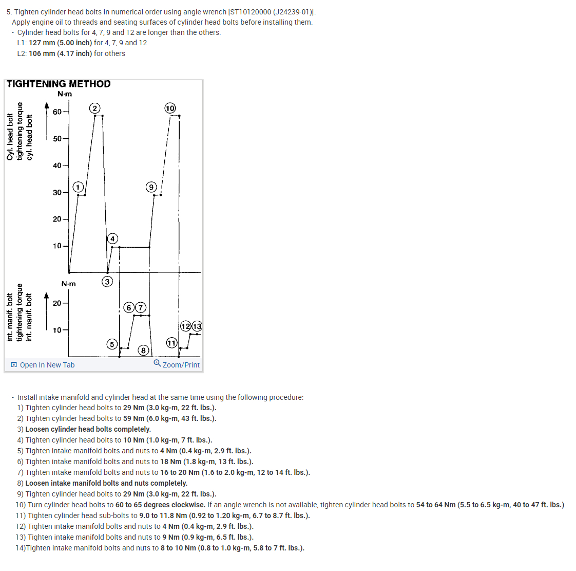

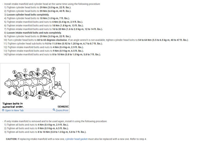

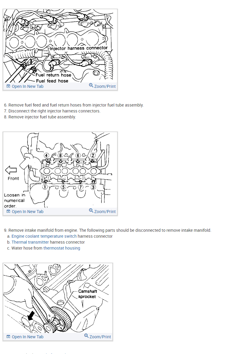

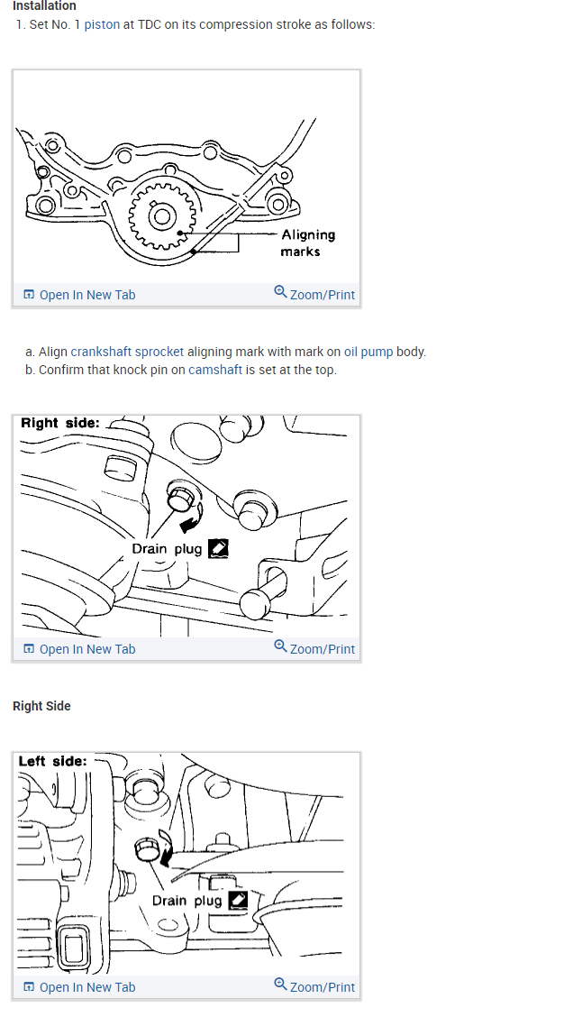

Hello.
Sorry about the mix up? Hope the diagrams below help this time.
Dave H
