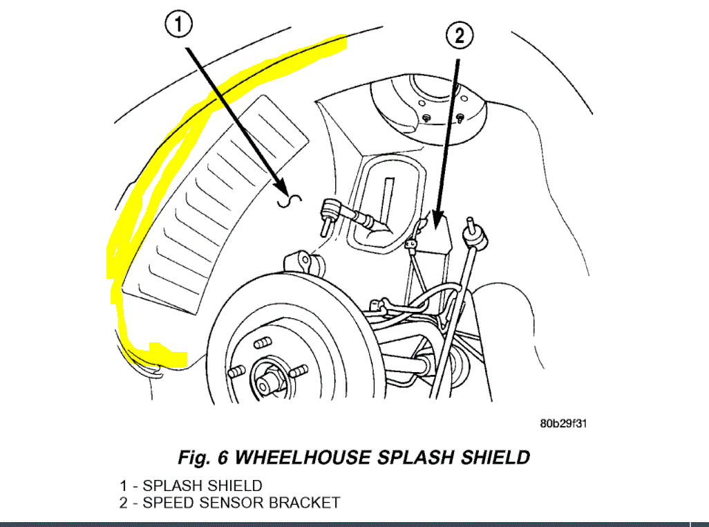

I'm trying to access the battery through the wheel well. After i get the tire off what do i do next?

If I recall, there are plastic push pins and maybe one screw along the fender. Remove enough of them to access the battery. See pic 1. I highlighted where I believe the push pins to be located.
Here are the directions from the manual. They aren't too specific.
