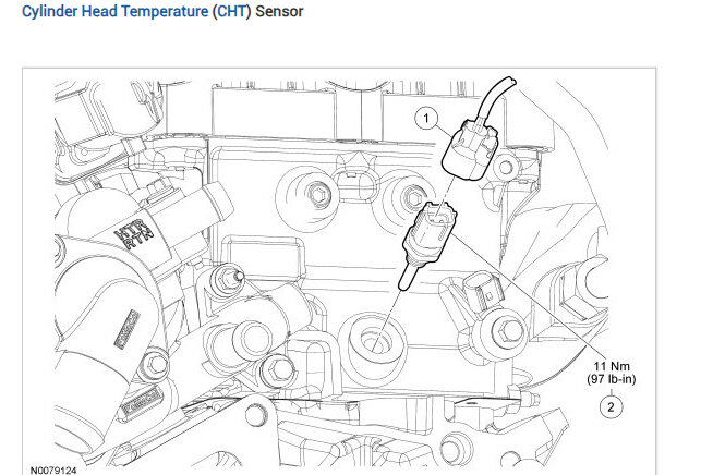

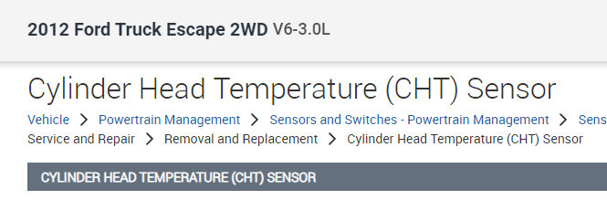

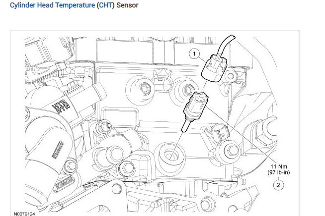

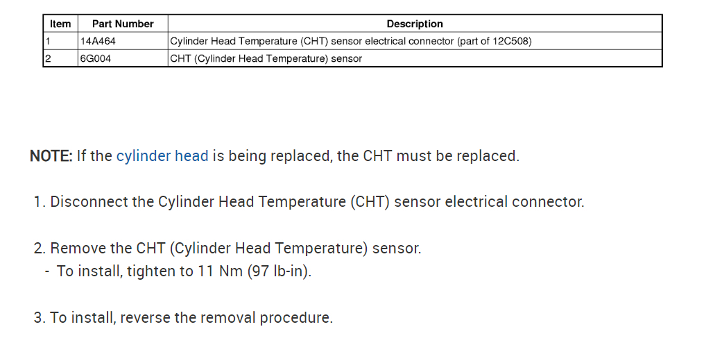

This has a cylinder head temperature sensor. It is mounted on the cylinder head.
I attached the directions below for replacing it. Take a look at the directions and let me know if they help or if you have other questions.

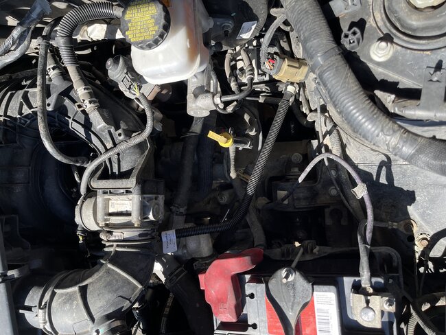

I can see the sensor and even unplug it from the wiring. I just can’t get a wrench or ratchet on it. My question really relates to what should be removed to gain access. I will take another look at it this weekend. Thanks

From what I'm seeing, you should have access. Do me a favor. Take a couple of pics of the sensor so I can see what you are faced with. I'm asking because I checked two different manuals and neither of them indicated things being removed other than the sensor.

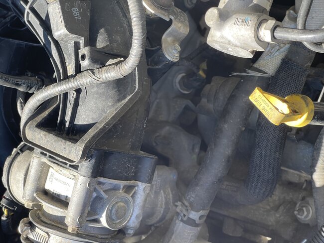

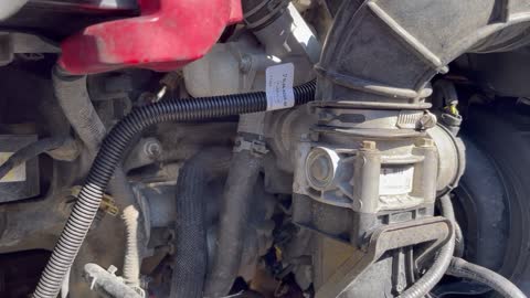

The cylinder thermostat has yellow tape.

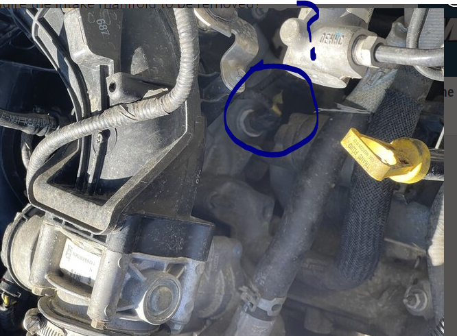

Looks like it might require the intake manifold to be removed?
Mar 9, 2024 at 1:36 AM
  • 110,244 POSTS
Many do require the intake to be removed. However, if I am seeing it in the pics you sent, it looks easily accessible. Am I looking at the correct thing?
Mar 9, 2024 at 9:27 AM
JMAHURT
  • 5 POSTS

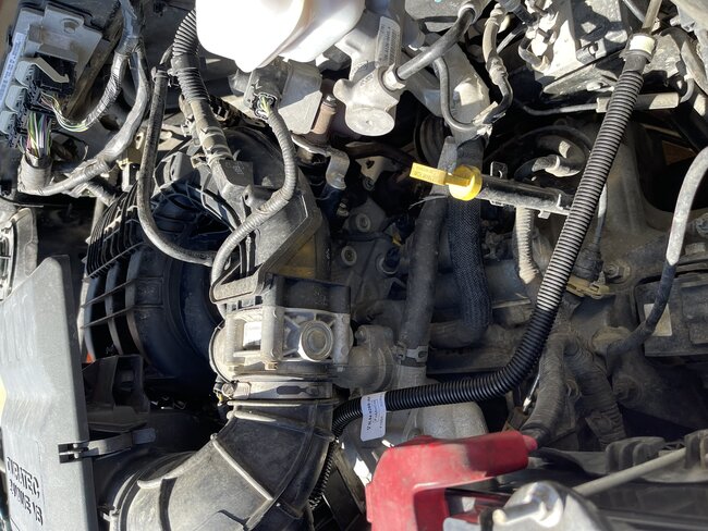

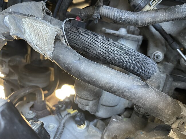

I wanted to give you an update and one more pic. The temperature sensor has yellow tape and to its right is the starter. I had to remove the 2 bolts holding the starter in place and move it over to the right. Once the starter was moved, I had the room to get a long socket with extensions over the sensor for an easy removal!!
