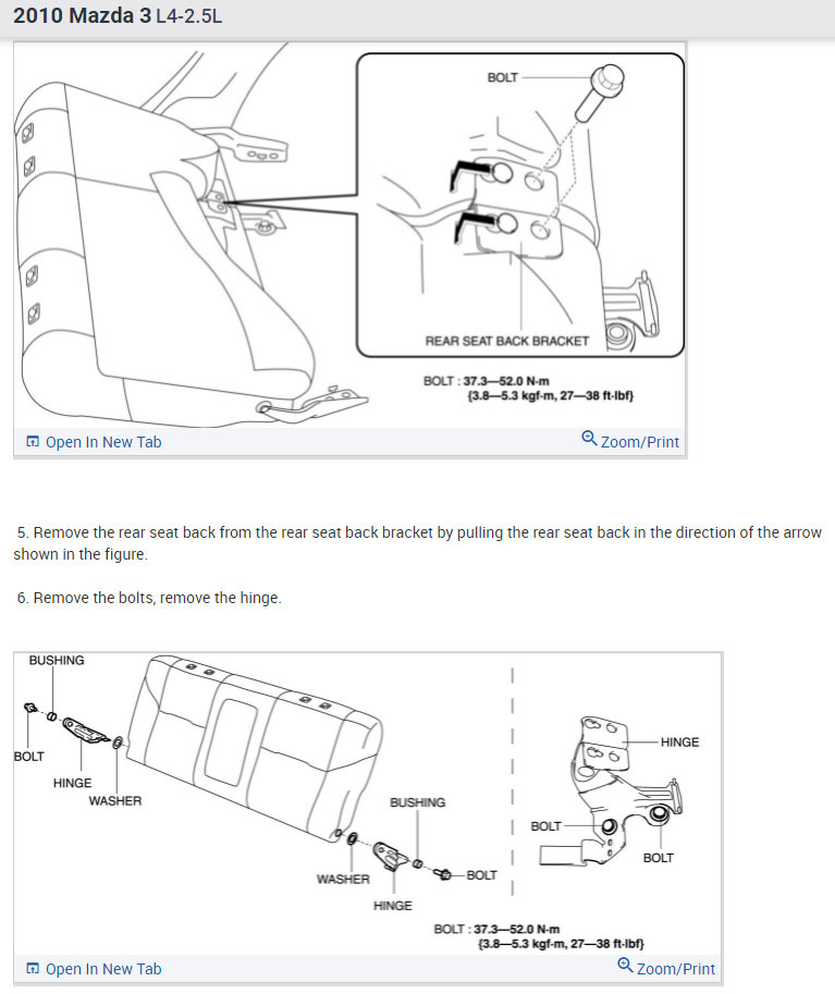

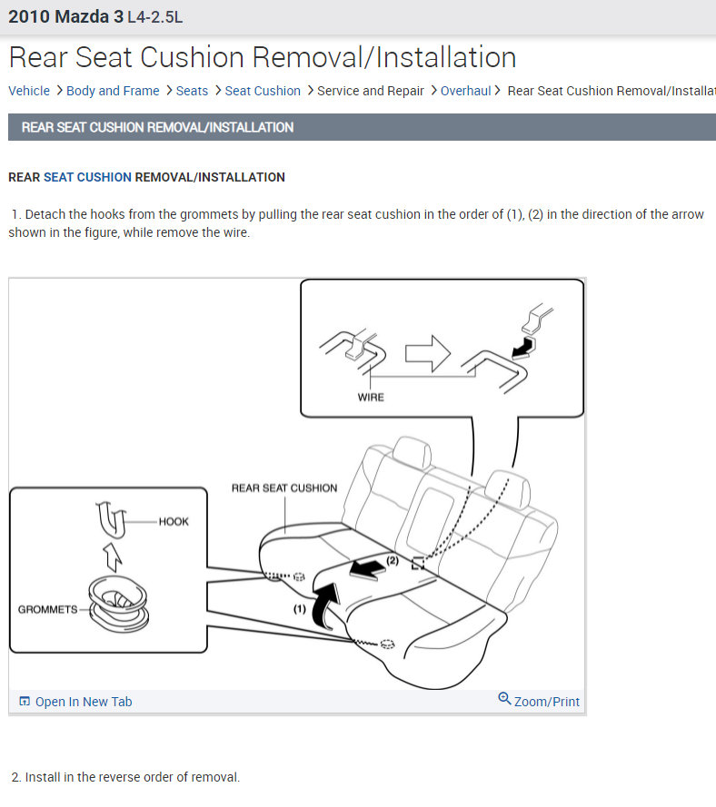

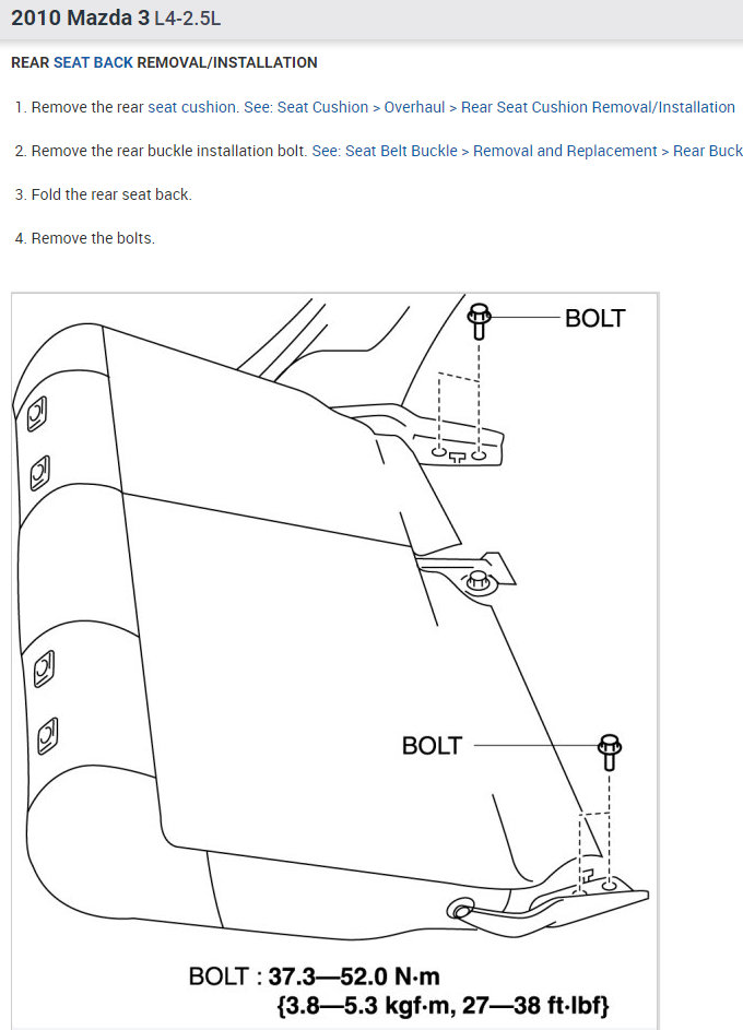

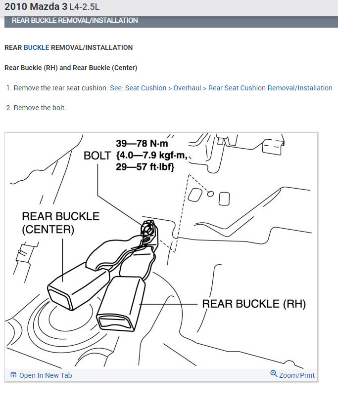

How do you remove rear bench?
On old cars they just popped out.
Sep 6, 2021 at 5:48 AM
SQM
  • 6,383 POSTS

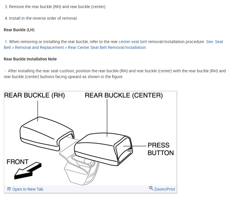

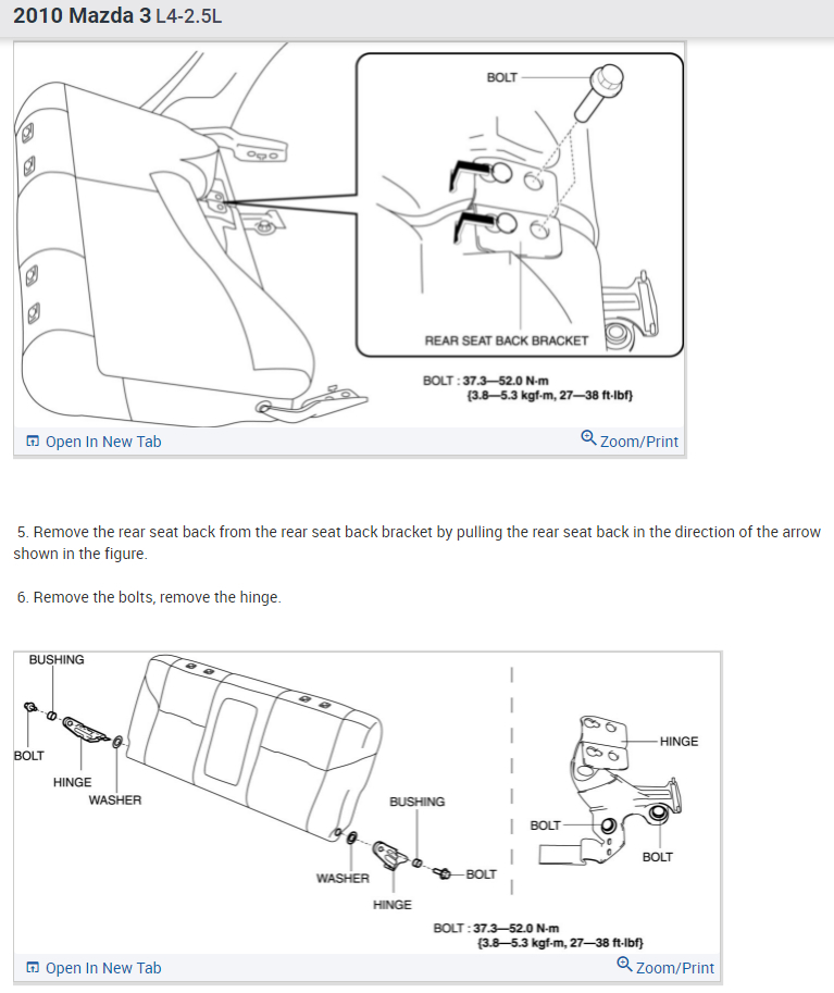

To get the rear seats out you will have to remove few bolts. You will have to pull in a certain way to get the seat cushion out.
I have attached the rear seat removal for both the seat back and seat cushion.

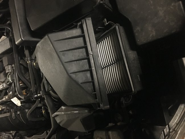

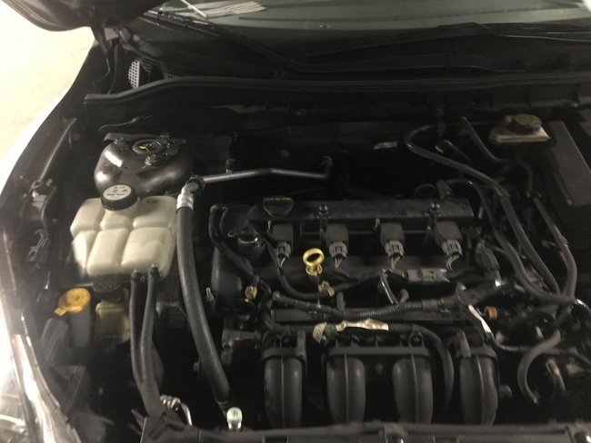

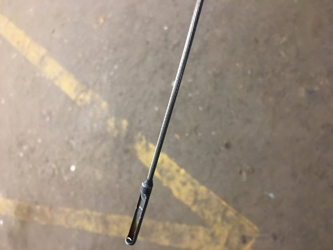

I am at 7+ days since car was flooded, about foot and a half. Have been drying out inside with towels fans and arm and hammer. Have a dehumidifier on order. Have not tried to start. As previously mentioned battery okay. Dash sites up/windows work. I accidentally discharged battery leaving trunk lid partially opened/light. Battery took charge from overnight charge. I do not think water got into oil. Please see picture of dipstick, if you can tell. Not sure if there are other things to inspect. Waiting for mechanic to stop by to look at starter and anything else? Guy at repair shop thinks I should try to start.
Sep 9, 2021 at 8:43 AM
SQM
  • 6,383 POSTS

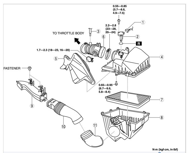

The oil seems to be the right color. Just make sure you don't have any water around the air intake area as when you start it can get sucked into the engine. But since it has been over a week any water under hood should have evaporated by now.
If you do not see any water under hood or any obvious sign on corrosion you should be able to start it. Just watch is very closely and listen for any odd noise or warning lights. Shut off immediately if something does not seems right.

There is a plastic cover on intake.Are there clips?
Sep 9, 2021 at 9:28 AM
SQM
  • 6,383 POSTS
As long the filter is dry you should be good.
Sep 9, 2021 at 9:48 AM
BRUNO BARSOUM
  • 28 POSTS
Popped plastic top. Engine Looks normal. No water. Same with air filter, dry.
Sep 9, 2021 at 9:58 AM
BRUNO BARSOUM
  • 28 POSTS
Let me know if you did not get pictures.
Thanks.
Sep 9, 2021 at 9:59 AM
SQM
  • 6,383 POSTS
Got the pictures. It does appear to be dry.

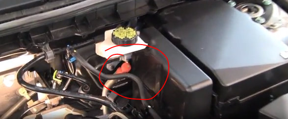

See picture below for the transmission dipstick location. The fluid should be checked when the engine is at operating temperature.
