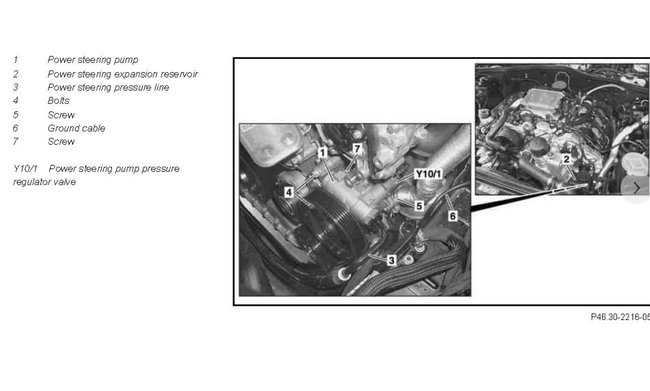

I want to take a chance on this one. Removed belt and the pulley is a bit harder to turn that most pulleys are, not smooth, i think this is where the noise is coming from.

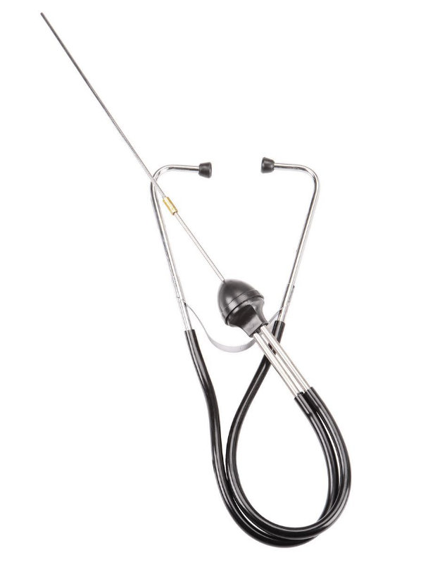

The pulley should have some resistance, but it will turn smoothly.
So, it is possible that the bearing is bad.
One way to determine where the noise is coming from is to use an automotive stethoscope (see picture below) and put it on the hub/shaft of the pulley when the engine is running. This can make it easier to determine the source.

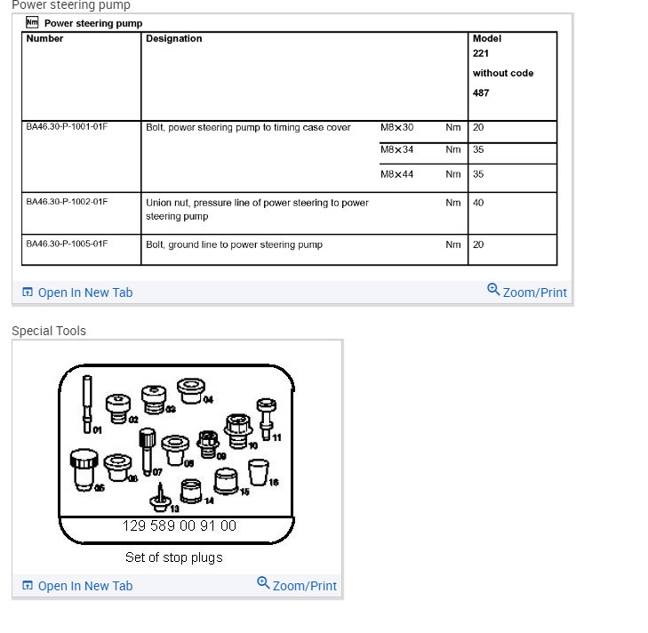

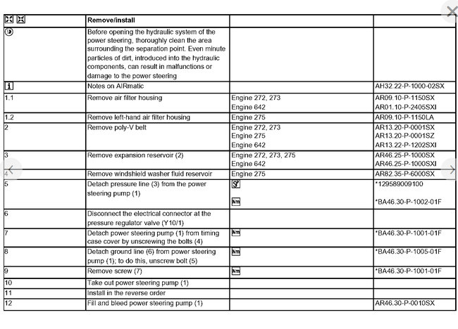

I have attached the power steering pump replacement procedure below for your reference.
Let me know of any questions.
https://www.2carpros.com/articles/how-to-replace-a-power-steering-pump
