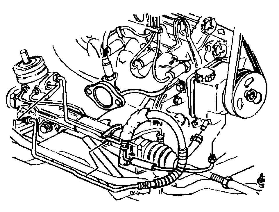

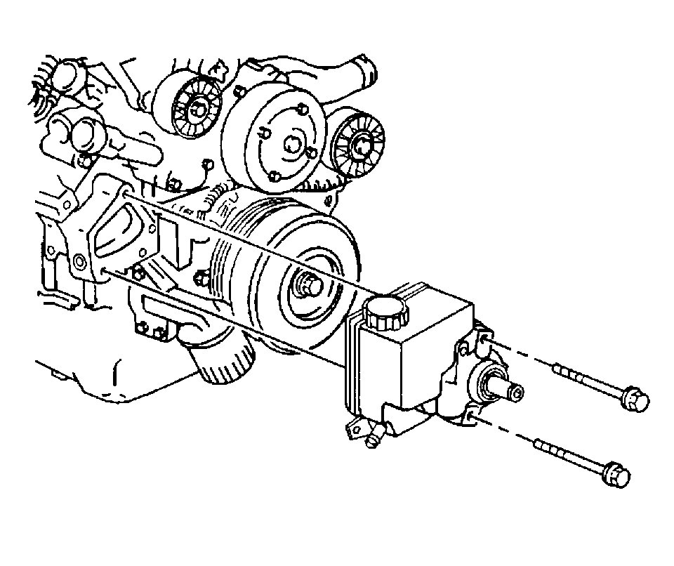

Remove the power steering pump but can't line it back up to install it. do i need to remove the front passenger wheel?

Yes, the wheel and tire need removed. Here is some general info on pump replacement:

Removal Procedure
1. Place a drain pan under the vehicle.
2. Remove the accessory drive belt from the power steering pump pulley. Refer to Drive Belt Replacement in Engine Mechanical-3.8 L.
3. Raise and support the vehicle. Refer to Vehicle Lifting.
4. Remove the tire and wheel assembly. Refer to Tire and Wheel Removal and Installation in Wheels, Tires and Alignment.
pic 1
5. Remove the power steering pressure line from the power steering pump. Refer to Power Steering Pressure Hose Replacement (3.8 L) or Power Steering Pressure Hose Replacement (3.4 L)
6. Remove the power steering return hose from the power steering pump. Refer to Power Steering Return Hose Replacement (3.4 L) or Power Steering Return Hose Replacement (3.8 L)
pic 2
7. Remove the power steering pump mounting bolts from the power steering pump.
8. Remove the power steering pump assembly.
9. Remove the power steering pump pulley from the power steering pump. Refer to Power Steering Pulley Replacement.
10. Remove the power steering pump reservoir from the power steering pump. Refer to Power Steering Reservoir Replacement - Off Vehicle (CB Series).
