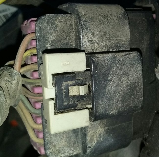

I am trying to replace my ignition coil the very first thing it says to do is to remove the lead by pressing down and pulling. I can not get this off, no one seems to have seen one like mine and I don't want to break it by doing it wrong.

I've posted a pic of another clip else where on the car. It looks just like this, only the white/gray thing is not there.

Squeeze the black tab right where the white clip might have been the push it down and pull it up.That's a very common GM car connector.

No problem looks like the connector that goes onto the ignition control module that is mounted to your coil assembly.

yeah that would be what it is
