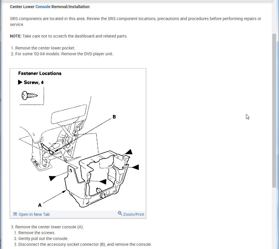

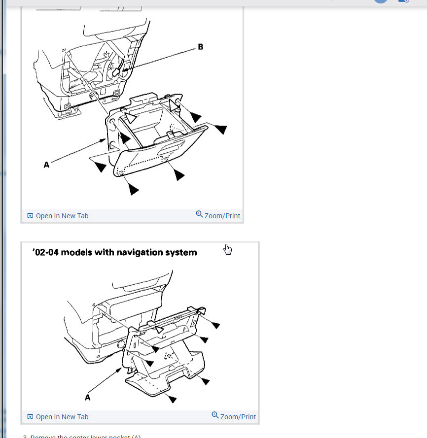

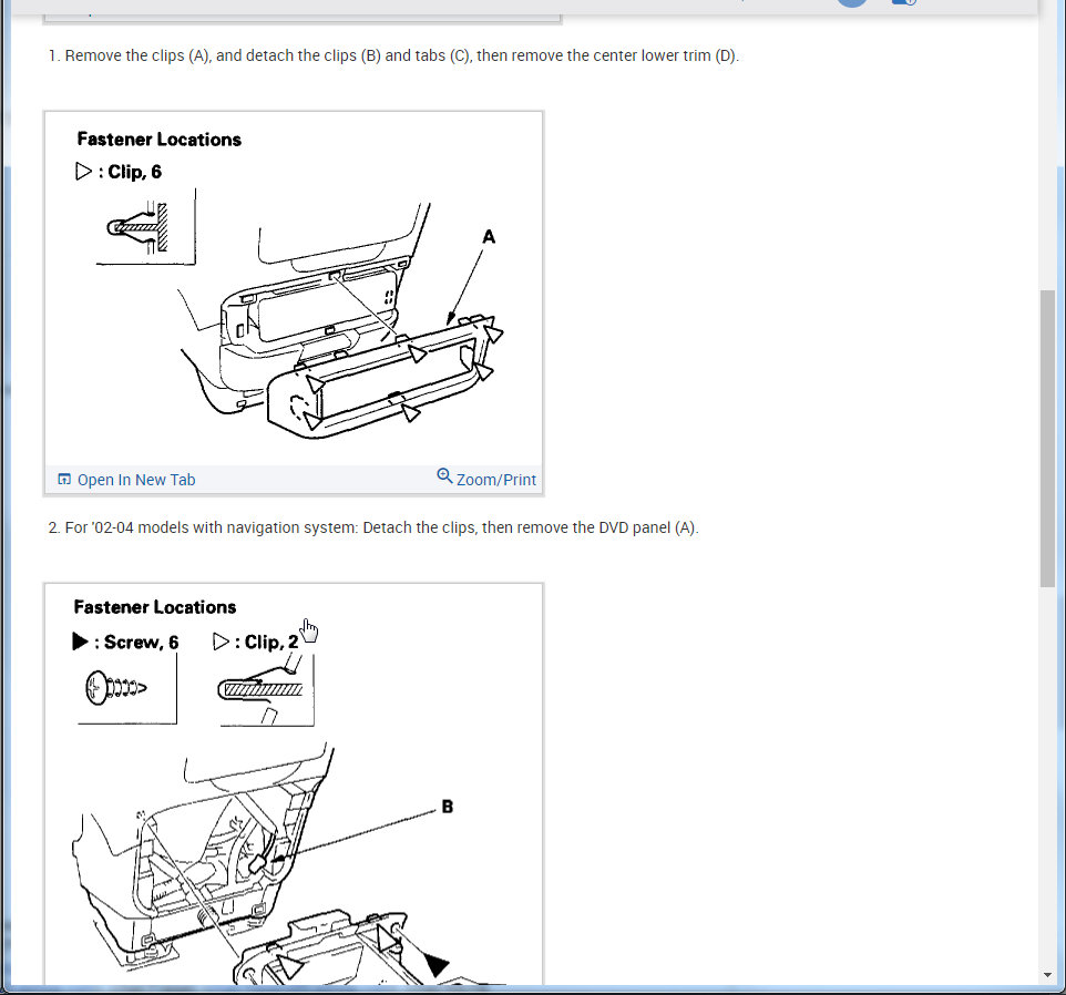

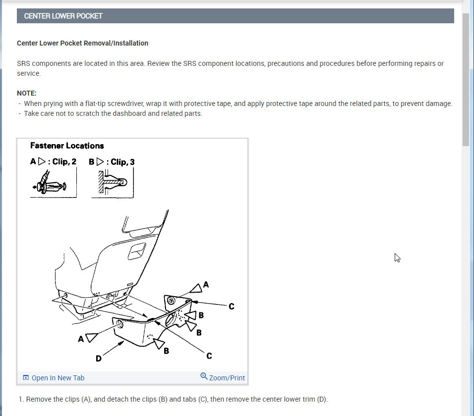

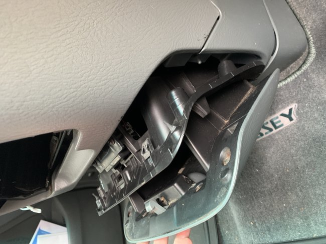

I am trying to remove the front console pull out storage compartment just under the cup holder tray. 4 visible screws at each corner of the unit have been removed but it is still connected at the base. I cannot see what is securing it at the bottom. Please advise how to access the other hardware that needs to be removed in order to lift it out of the console. Thank you!
Mar 15, 2021 at 1:44 AM

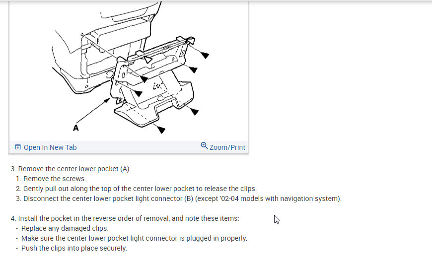

Looks like once the screws are out, you pull it out but it is having you remove what they are calling the lower pocket.
Below are the instructions for all this.
Let us know what questions you have and we can go from there. Thanks
