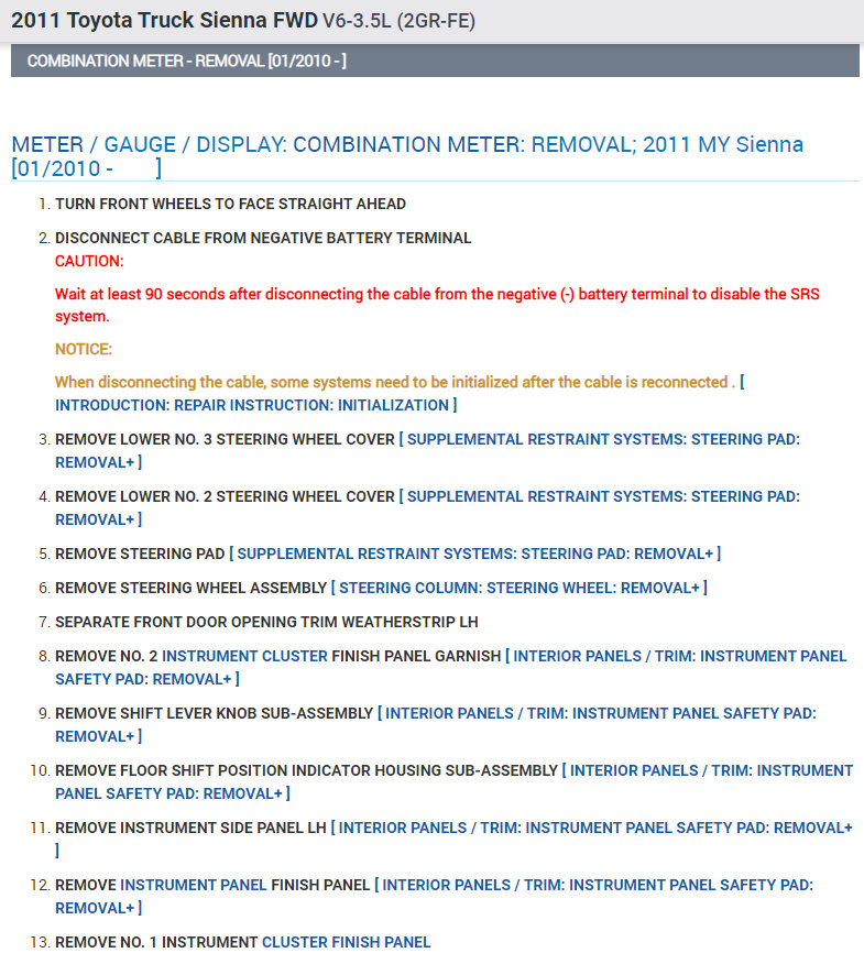

How do I remove the cluster?
DIVIDES
  • 2011 TOYOTA SIENNA
  • 2WD
  • 174,000 MILES
I need to remove the cluster for repairs.
Friday, October 8th, 2021 AT 1:33 PM
SQM
  • 6,383 POSTS

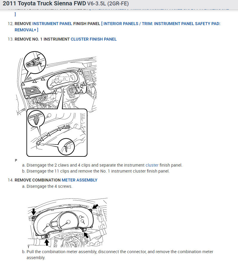

To get the cluster out you will first have to remove the trims around the gauge cluster.
Before getting started make sure to disconnect the negative battery cable and wait for at least 90 seconds.
https://youtu.be/_HEC44xENxw

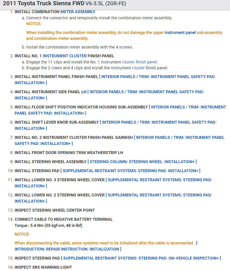

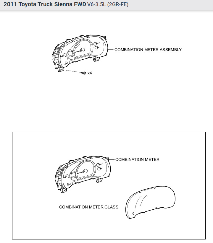

I have attached the replacement instructions below.
