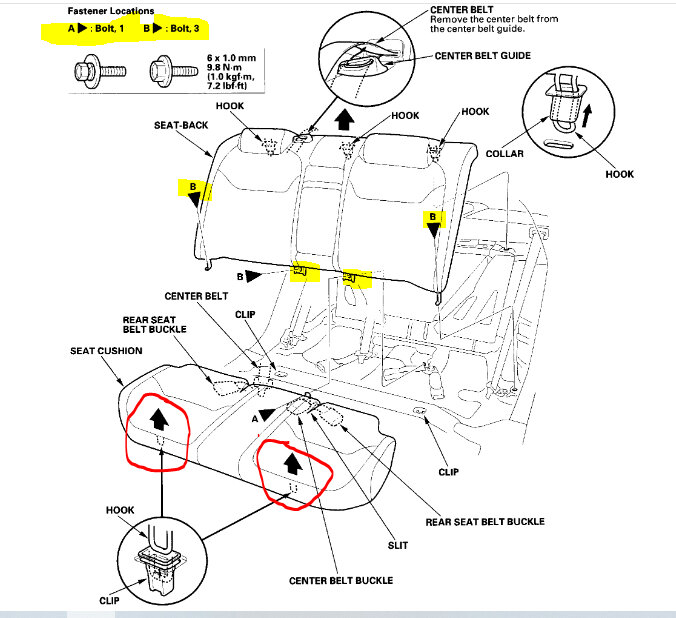

That is a tough one. However, what I recommend is this. If you remove the rear seats, you will have more access to the panel.

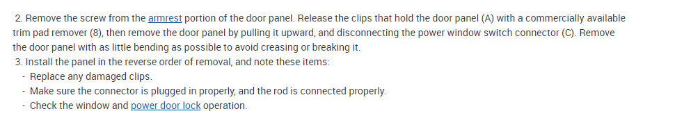

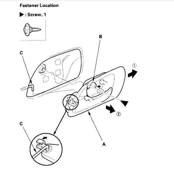

If you look at pic 1, it shows where the retainers are located. Remove the seat portion first. It has two clips at the front. Lift upward and then pull it straight forward. Once that is out, then you can access the bolts holding the back section in place.

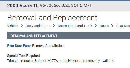

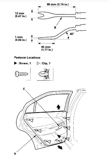

That is the best you can do. Also, the remaining pictures are the directions for removing the panel.
