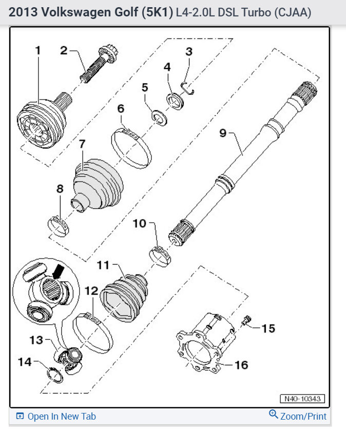

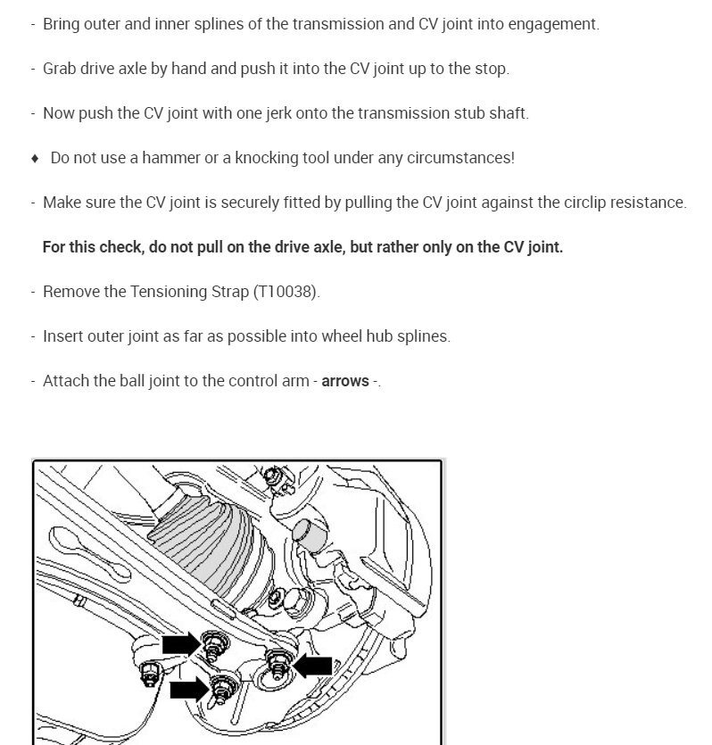

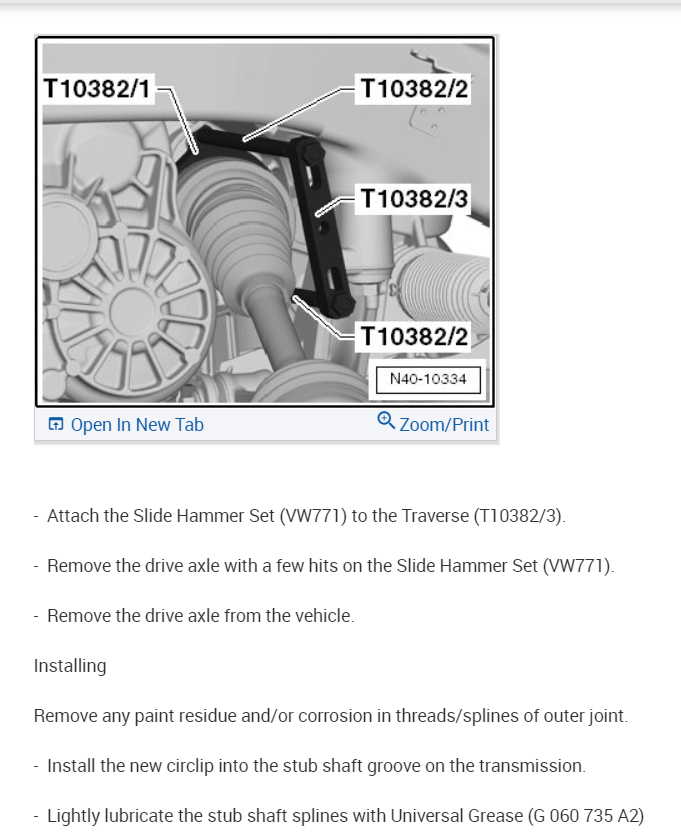

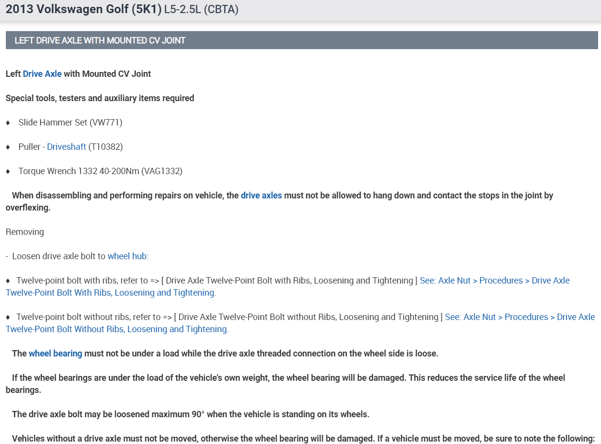

I am having an issue getting anything to go into the back edge of the axle to pop it out, I have changed so many axles in the past, nut everything here is in the way, can see what the instructions call for? This is for the driver's side. These are different than the years before it which had bolts around the axle to get it out.
Sep 12, 2023 at 6:22 AM
  • 55,423 POSTS

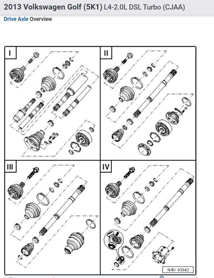

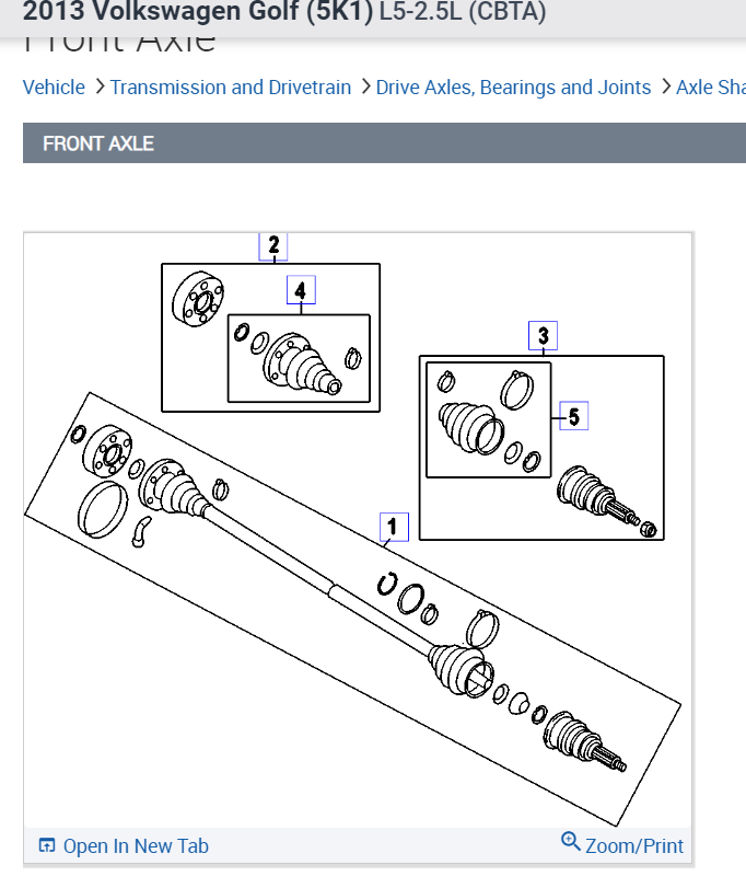

These have 4 different axle combinations. Can you upload an image so I can see which one it is? Here is what I got so far. Check out the images (below). Please let us know how it goes.

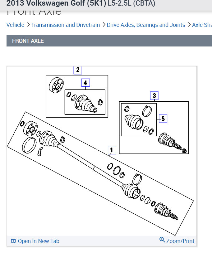

It's a 2.5 not a 2.0 turbo.
Sep 12, 2023 at 7:35 AM

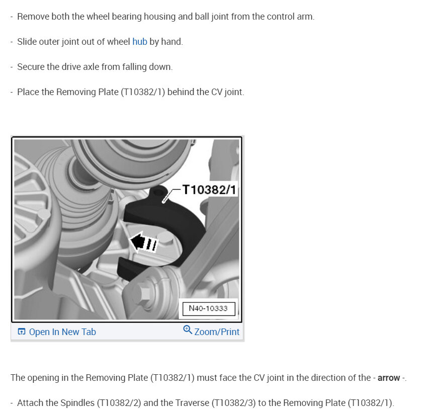

  • 55,423 POSTS

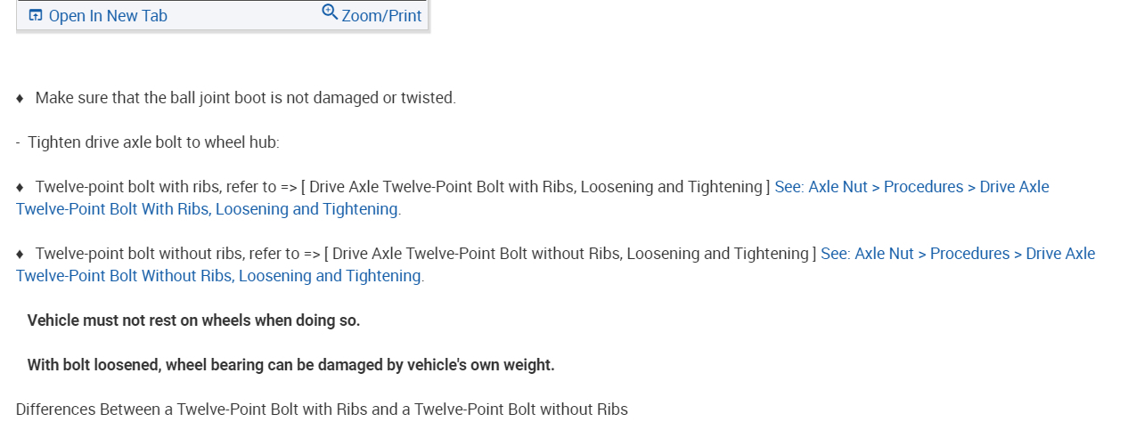

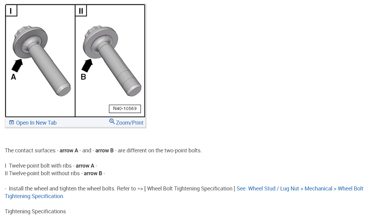

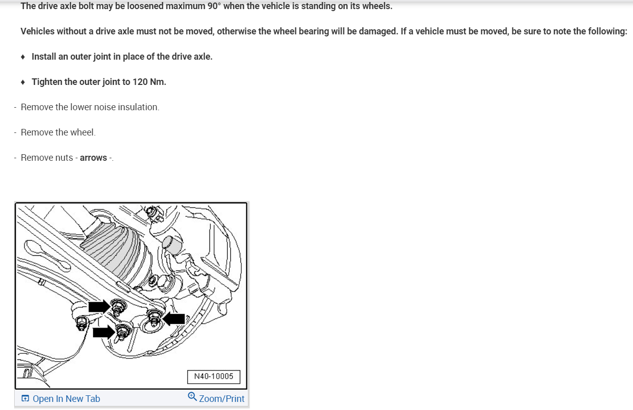

Gotcha, it looks like there is a special tool that is used to do the job, here are the instructions to change the CV axle out. Check out the images (below). Please let us know how it goes.

Geez, they couldn't just make it easier. Thanks though.
