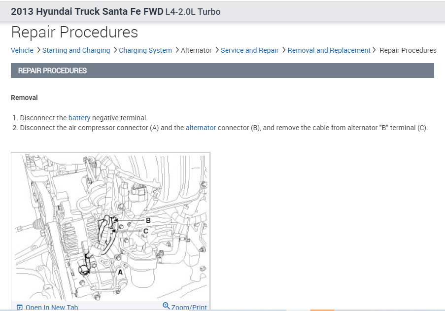

I need help removing the lower alternator bolt.
Jul 14, 2022 at 10:35 AM
  • 110,244 POSTS

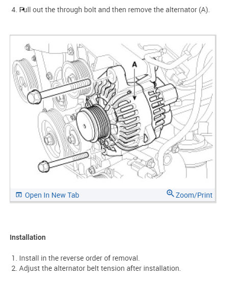

There are two bolts that hold it in place. Basically, once they are fully loosened, they pull straight out. Is something preventing that for you?
I attached the directions from the manual. Take a look at them and let me know if they help.
