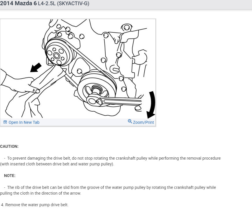

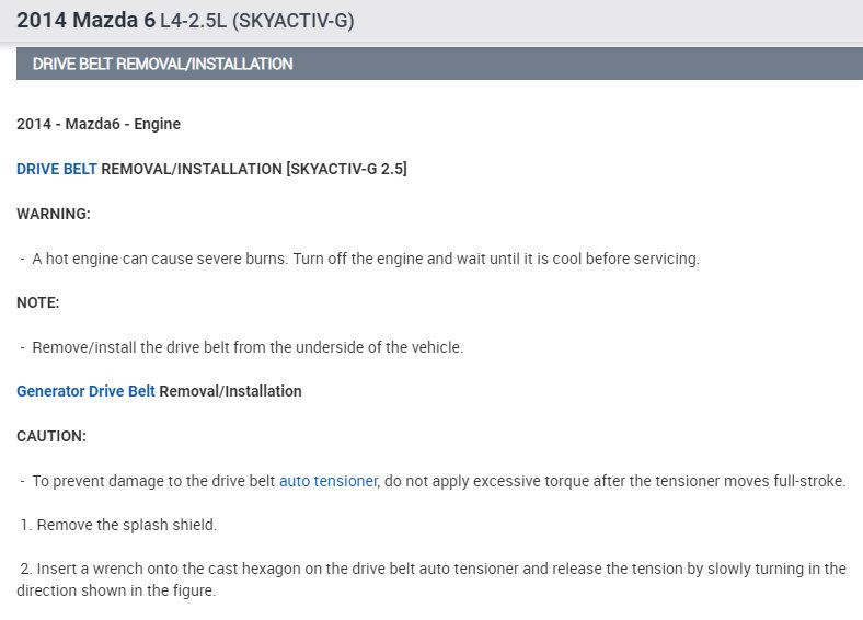

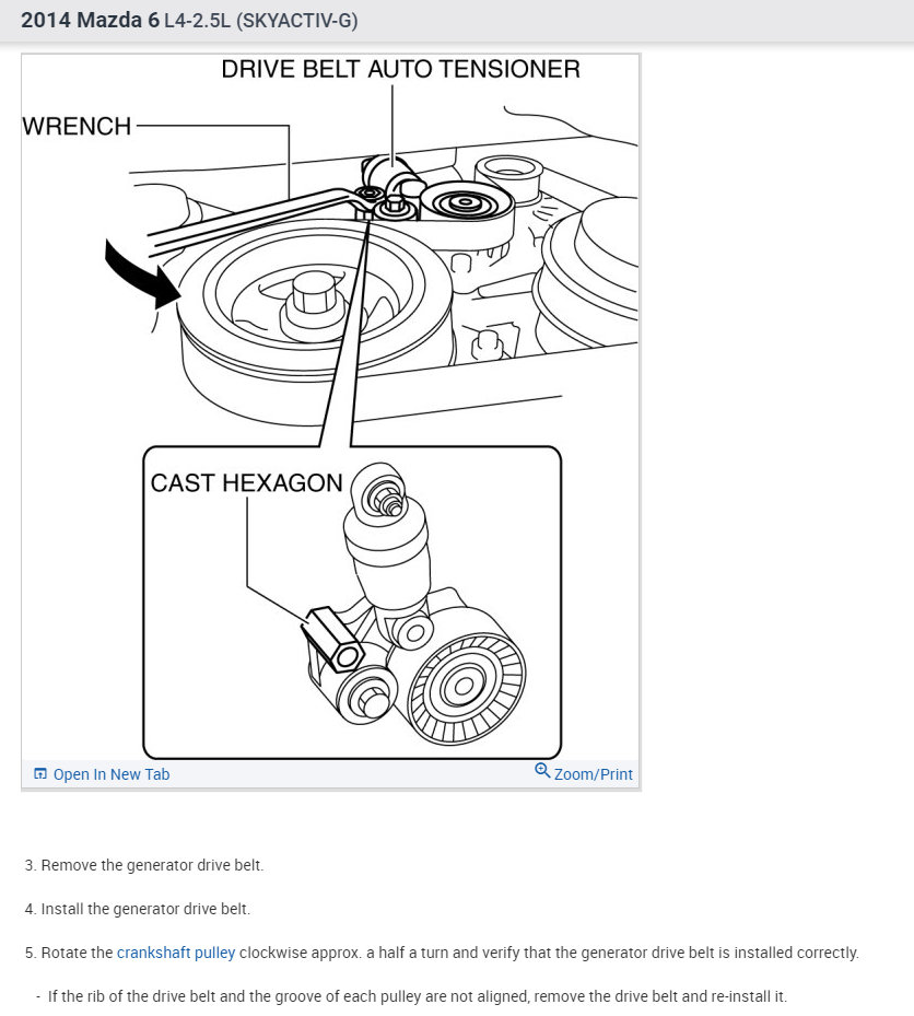

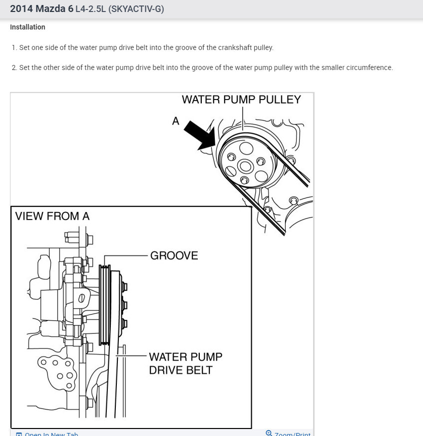

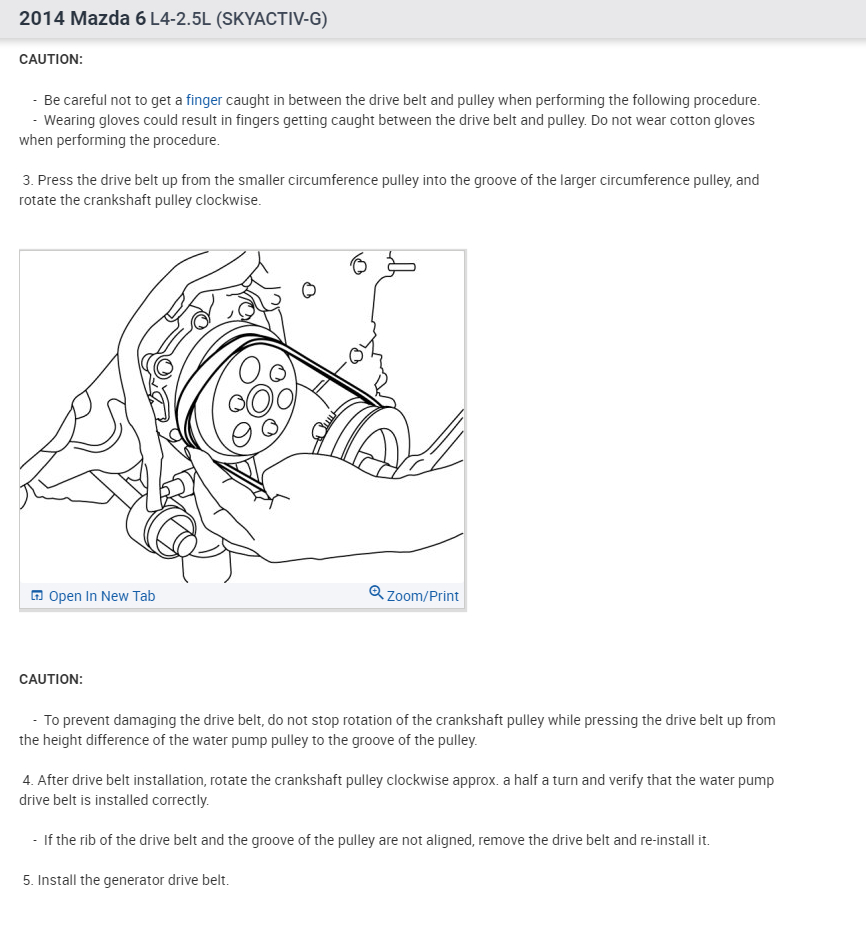

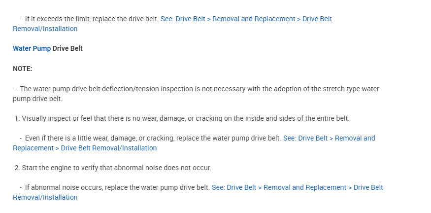

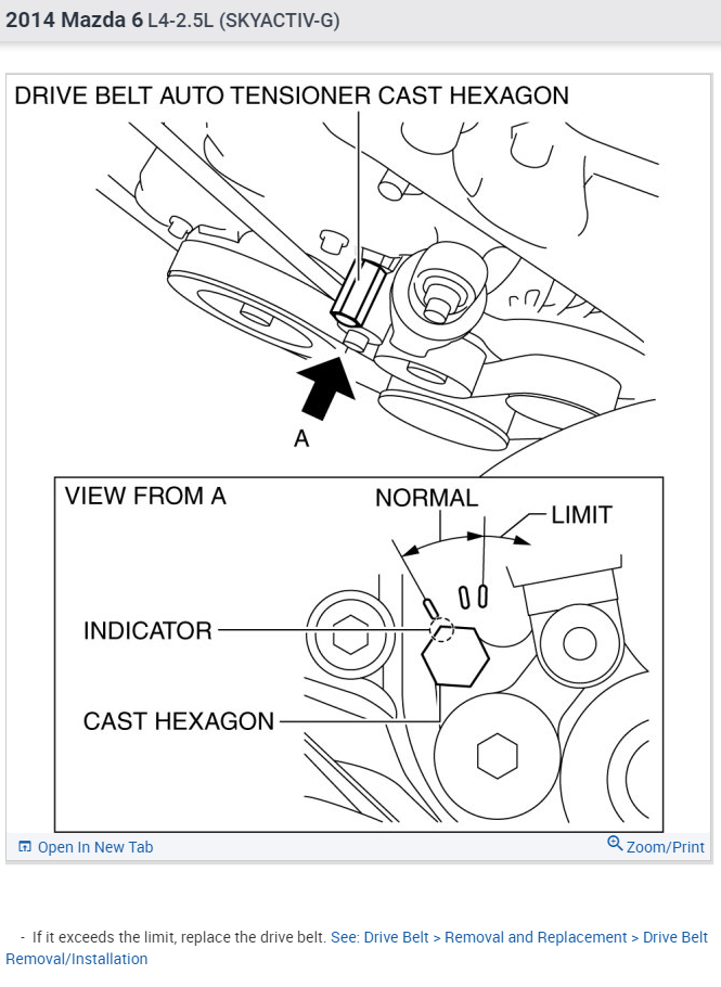

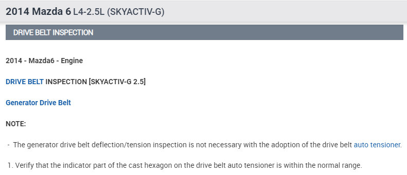

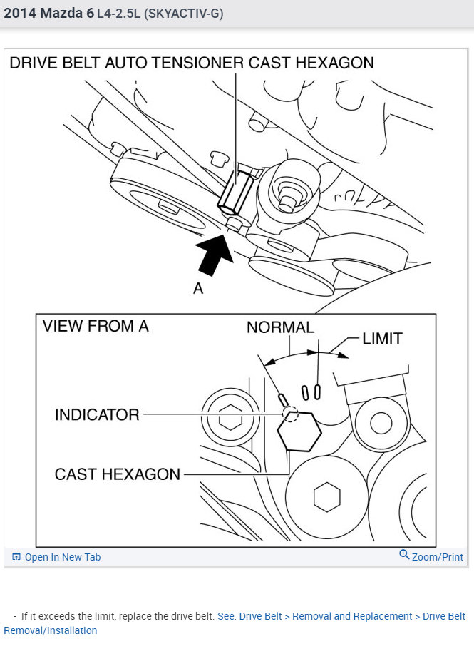

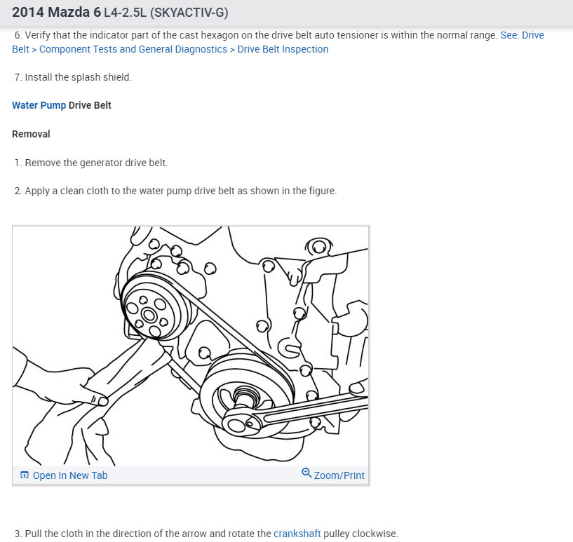

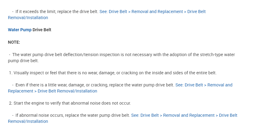

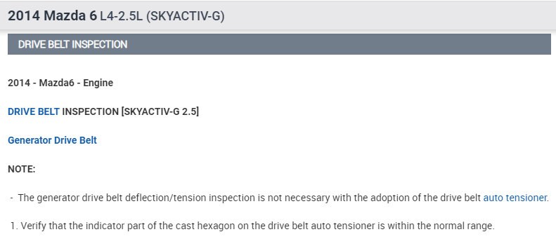

Instructions on how to remove belts so i can check where noise is coming from.
May 16, 2022 at 11:25 AM
SQM
Experienced Mechanic
6,383 POSTS

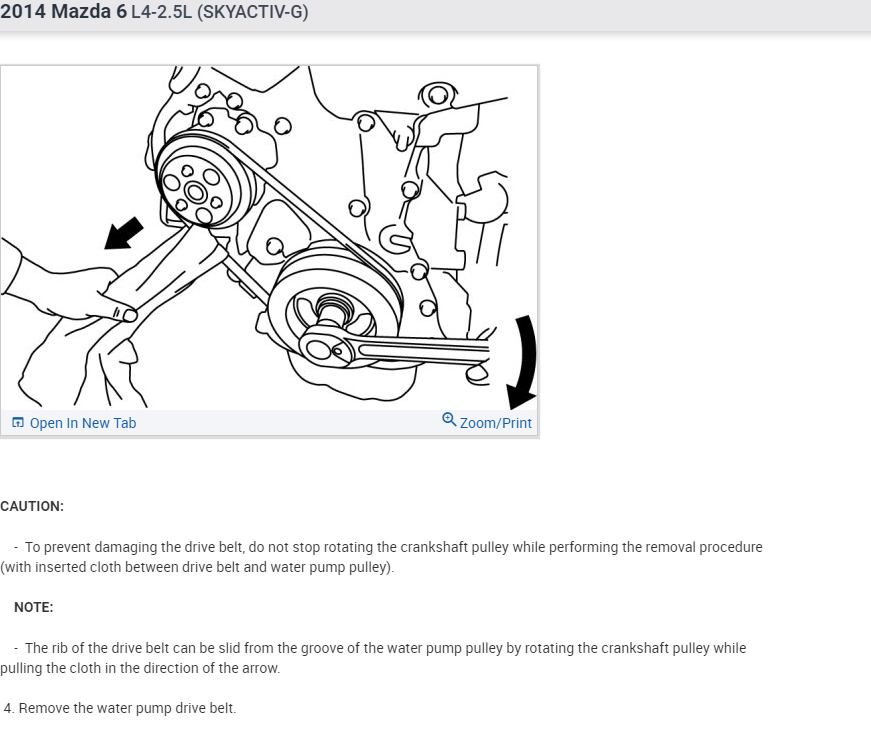

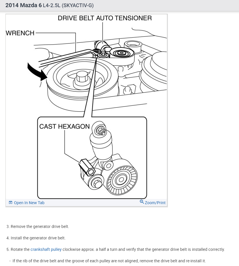

See attached for the drive belt replacement and inspection/test procedure.
Let me know of any questions.
https://www.2carpros.com/articles/car-squeaking-noise

So, we are using towels now?? Lol, this is new to me.
May 16, 2022 at 11:18 PM
SQM
6,383 POSTS
I know, I was surely intrigued. :)
