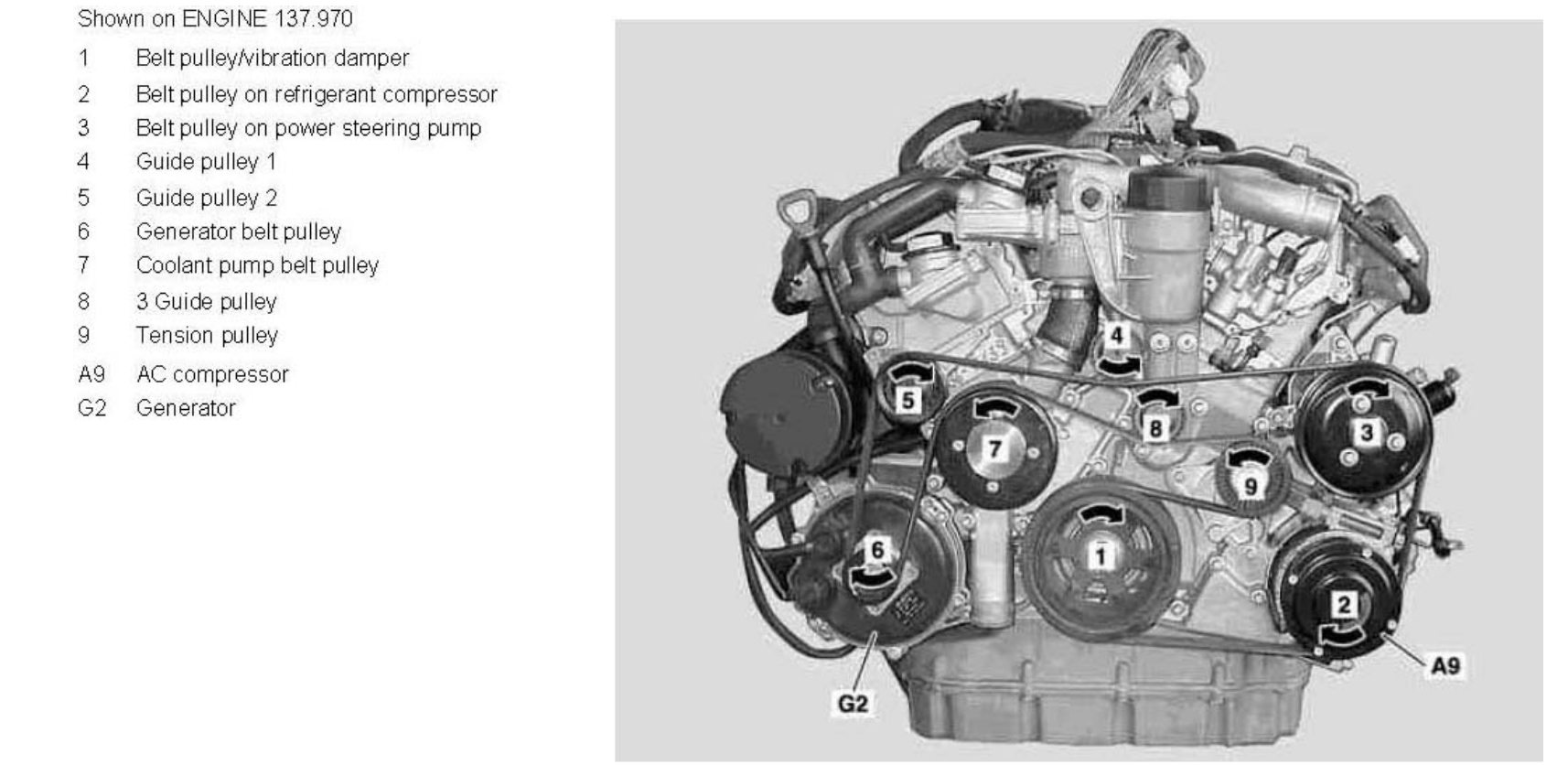

How to remove the serpentine belt, I am hearing some whine which i think is one of the belts?

I am hearing some whine which i think is one of the belt's pulleys. How do i remove it on this car?

Yep, the best thing to do is remove the belt and check the condition and replace if worn, also when the belt is off spin the accessories to see if you hear any squeaking or grumbling indicating the part is bad which is can give you instructions to change, here is the belt diagrams and how to remove it in the images below click to enlarge. Check out the diagrams (below). Let us know what happens and please upload pictures or videos of the problem.

Yup. 8 and 9 pulleys are worn and make lots of noise. thanks
