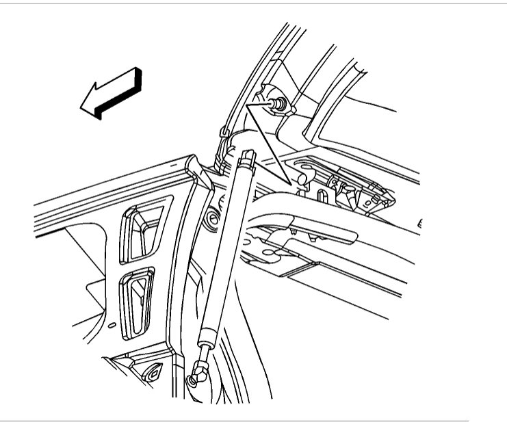

Removing and replacing tailgate door hydraulic lift struts. need instructions how to access through rear light? or where?
Aug 16, 2017 at 2:04 PM
Experienced Mechanic
55,649 POSTS
Here is a video that will show you what you are in for when doing the job.
https://youtu.be/ZztVy7xlPpI
It is on a different car but you get the idea it is the same on most cars.
Here is a diagram (below) of your car.
Please let us know what happens so it will help others.
